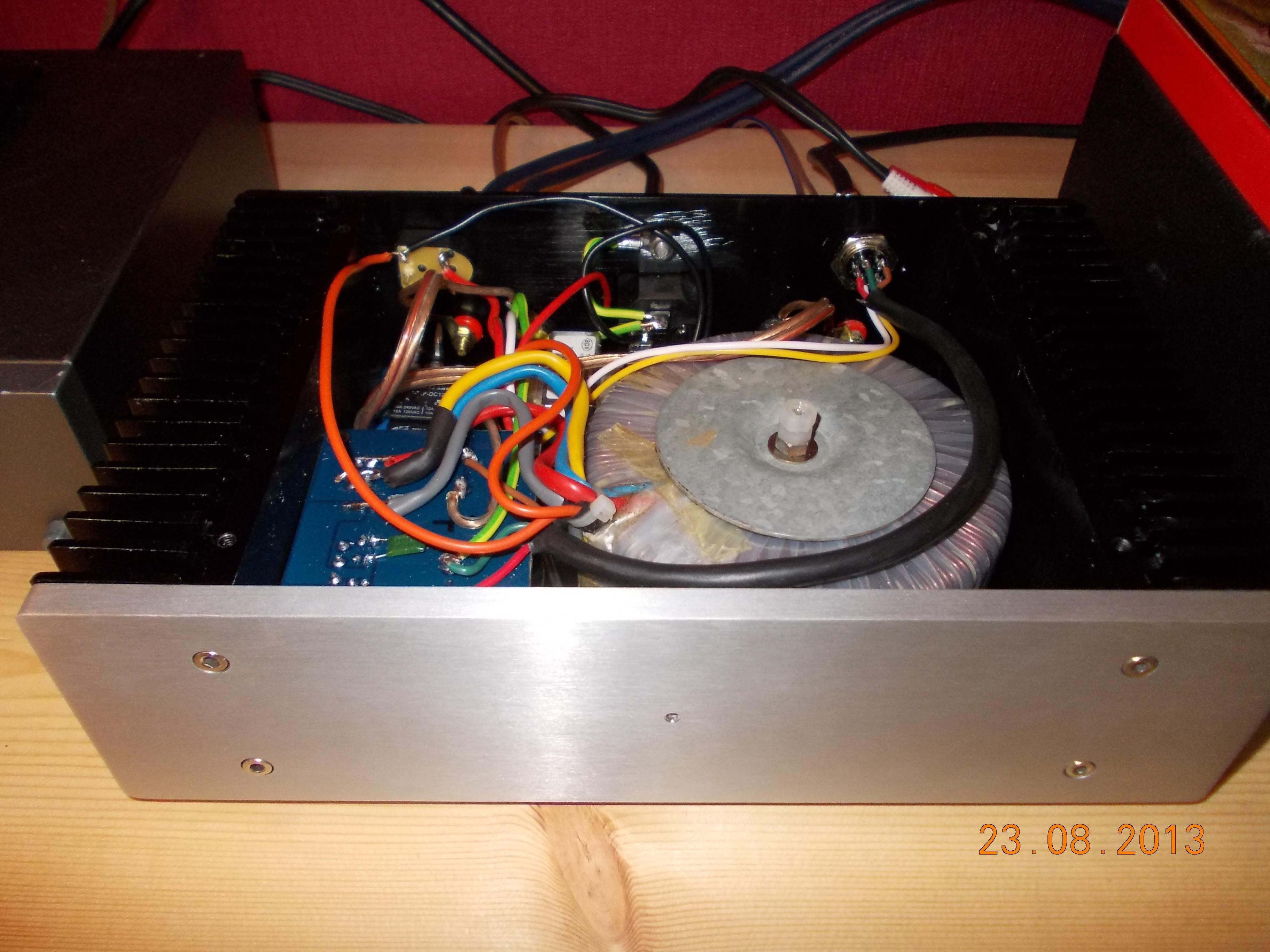

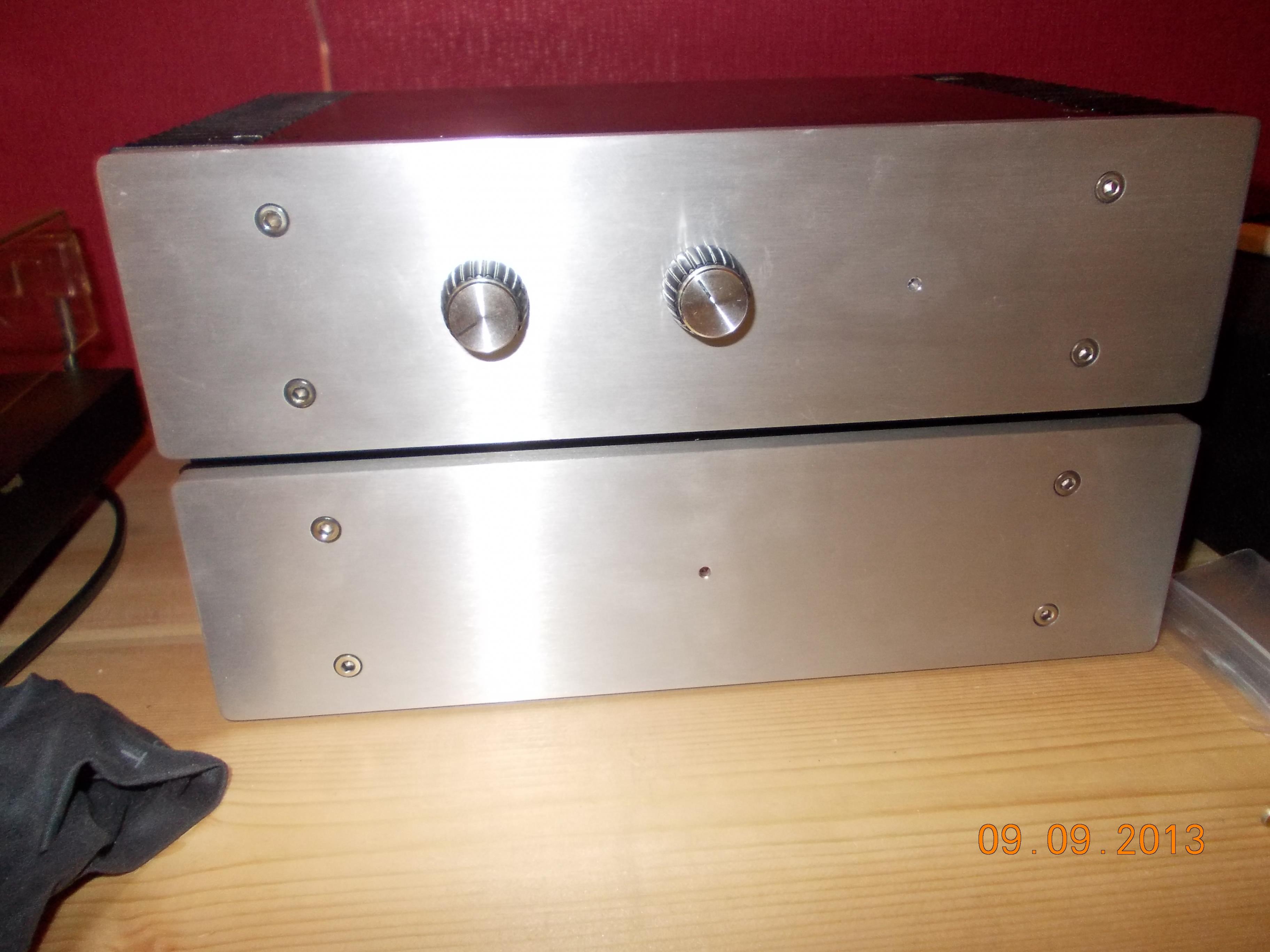

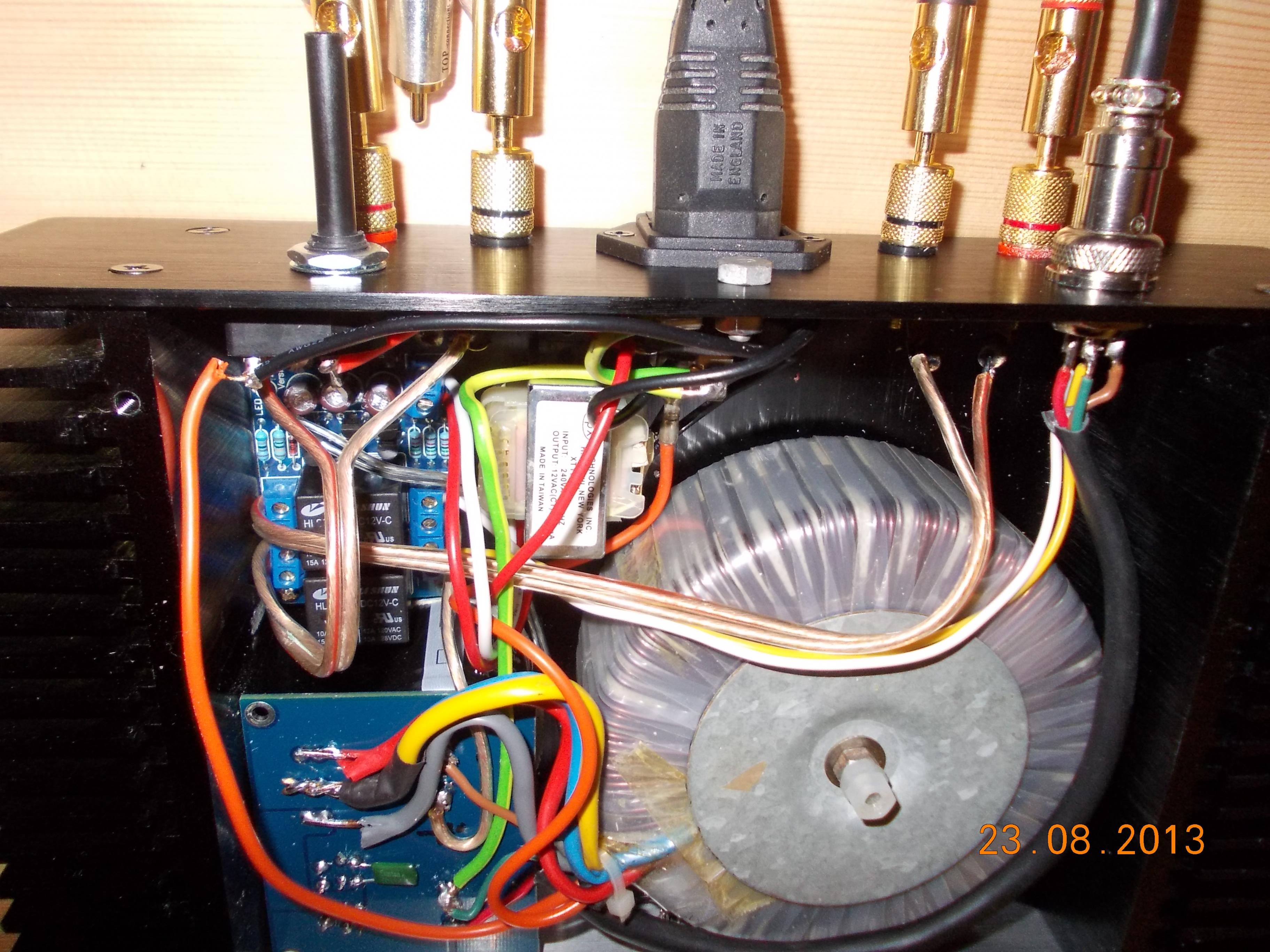

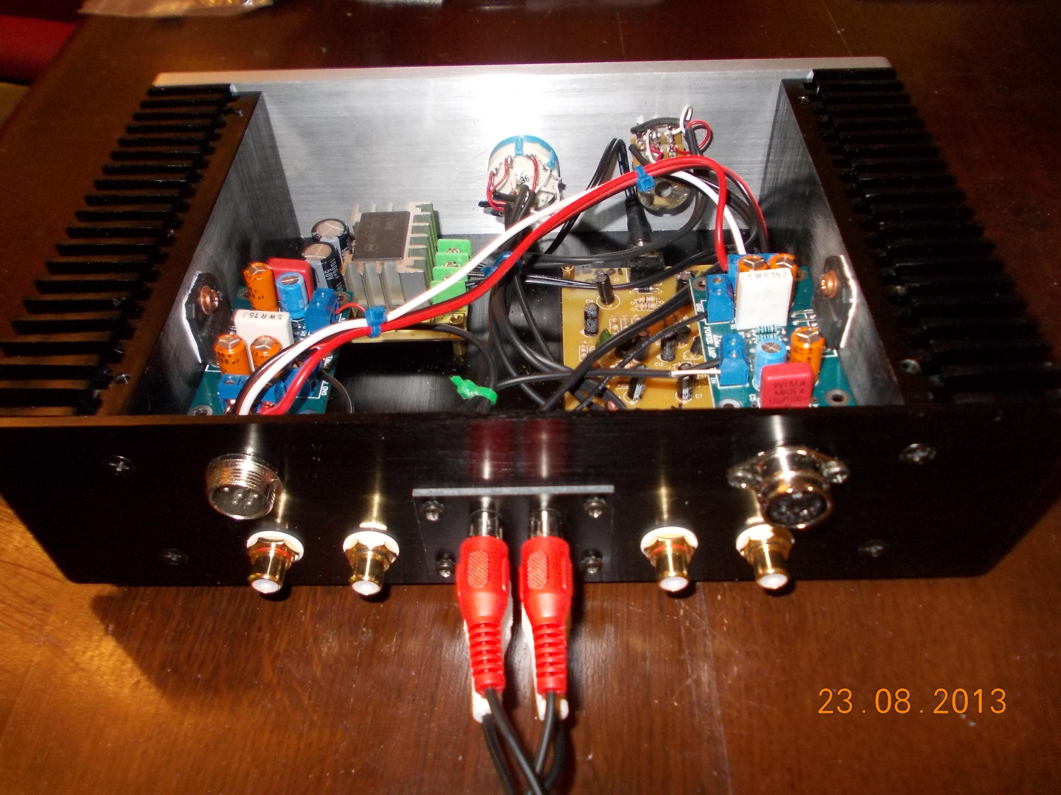

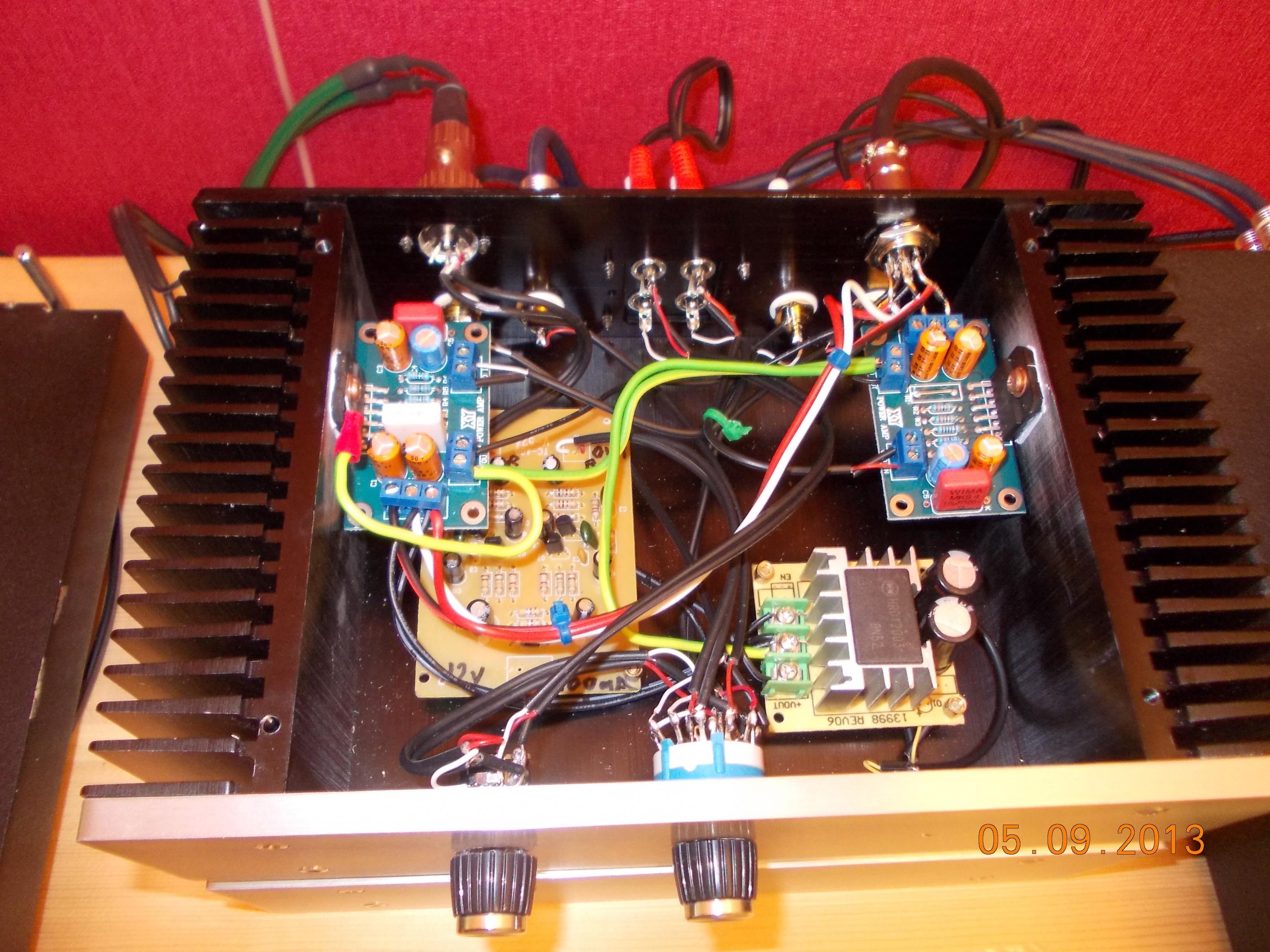

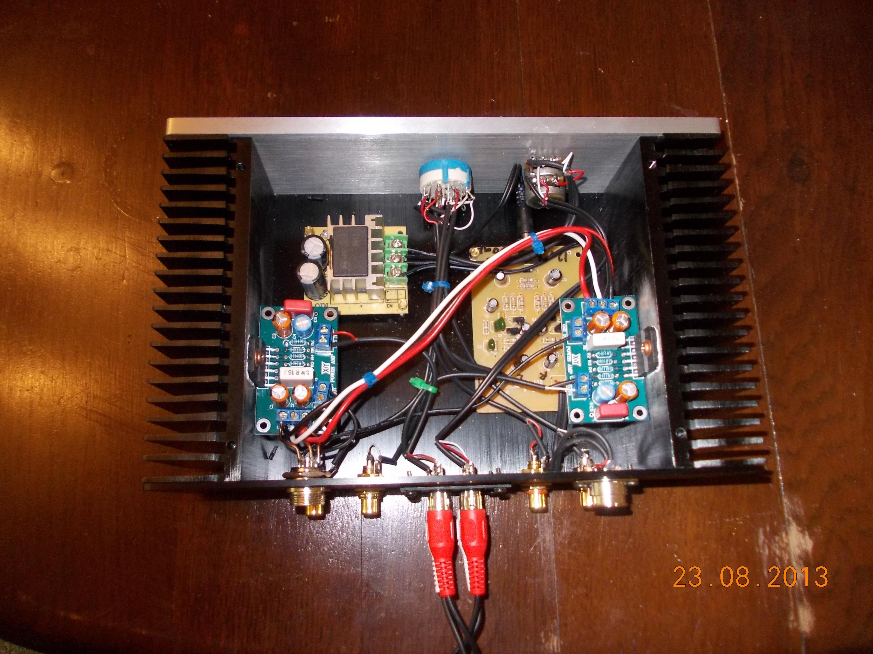

My latest gainclone
I thought someone may be interested in my latest, and last gainclone. It is rather unusual as to keep all the ac away from the inputs and still have an isolated speaker protection system, I have mounted the speaker protection board in the psu box, therefore the speaker sockets are on the psu box. This also gave me room in the amp box to fit a phono board for my vinyl.
