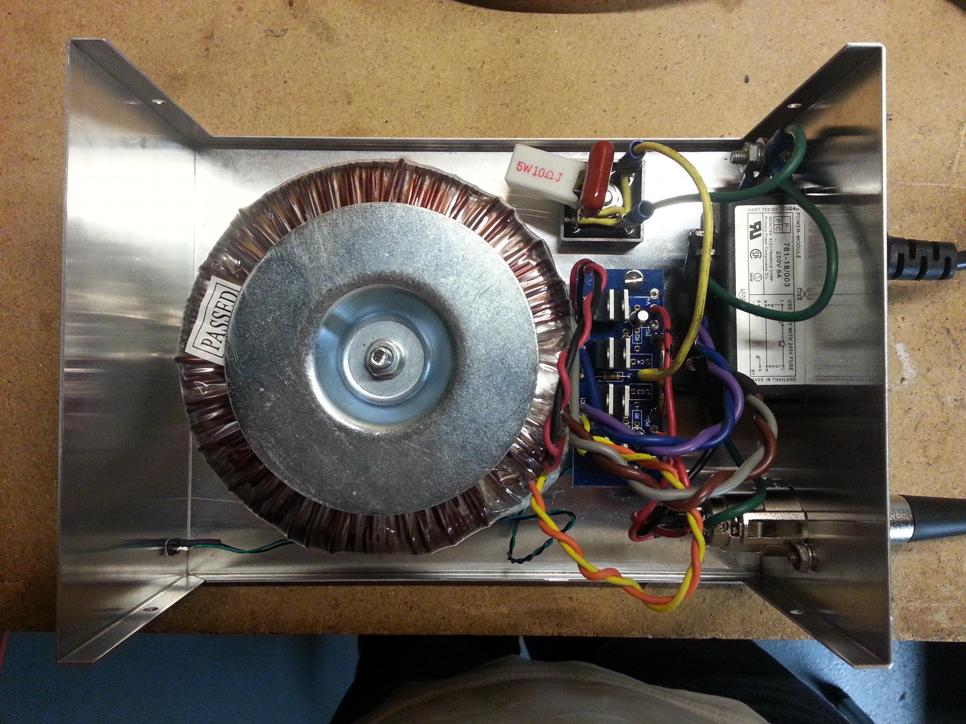

If amp and PS are in separate enclosures, I would suggest to place rectifiers with the transformer, that way you will have only DC in the amp. This may not be really critical, as I've built amps with rectifiers right beside the chip (see below) and they performed well, but placing the diodes in a PS enclosure is a common practice.
There are 4 wires in the umbilical: V+, V- and two grounds separate for each rail. While the example integrated amp had separate power wires for each channel (that's why you see 6) the Patek has power wires run from one channel to another channel (board).

My Gainclone is alive and well!
Thanks to all the help on this forum, my gainclone is fixed. Turns out the amp was actually fine, it was the speakers that blew. The power supply was also fine, but it is now in an enclosure with proper grounds and it is quiet when turned on and off - no audible hums from the toroidal or pops in the speakers. Speaking of which, with a different set of speakers the amp sounds good again.
These new speakers are 4 ohm and the amp is running a little warm. I am hoping the amp runs cooler when I go to the 8 ohm full range speakers I am building.
Thanks again for the guidance.
