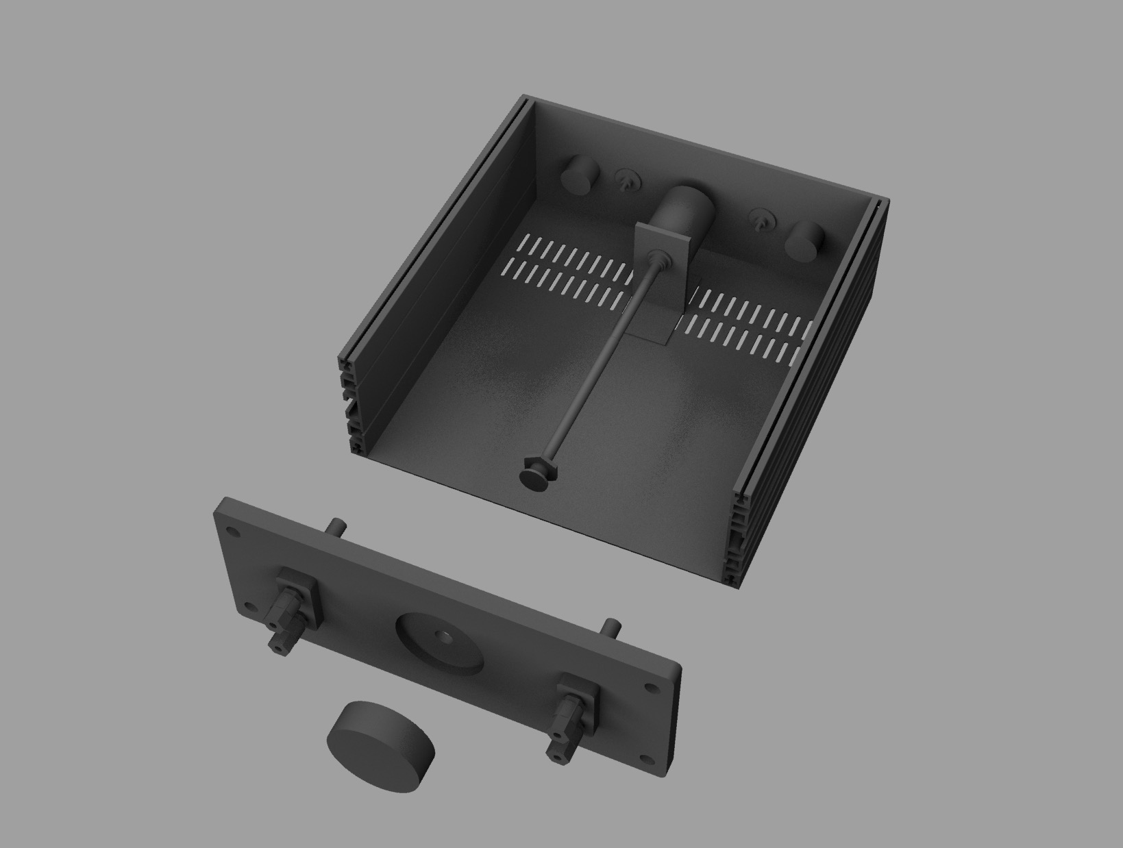

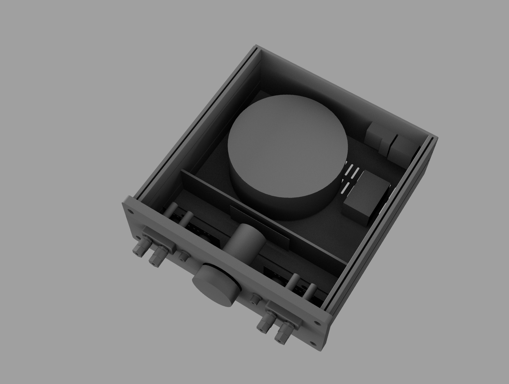

I also found this 41-stepped attenuator from japan ….
Acoustic Dimension Stepped Attenuator - [English]
As long as you use ground scheme as proposed here: http://www.diyaudio.com/forums/audi...-kit-building-instructions-4.html#post1518369 you shouldn't be experiancing any ground problems, no matter if one or two transformers being used.
OTOH, in this particular chassis configuration, it's probably better to use one larger transformer, than two smaller ones (400VA vs 2 x 200VA)
If you aiming for monoblocks later on and plan to use components from this build, by no means use two transformers and don't worry about any grounding problems.
With amp chassis as pictured, most likely you won't be needing any additional heatsinks, make sure though that panels are tight and allow heat transfer into all surfaces.
You may also consider placing inputs on front panel and outputs at the back, this way shaft extension won't be needed.

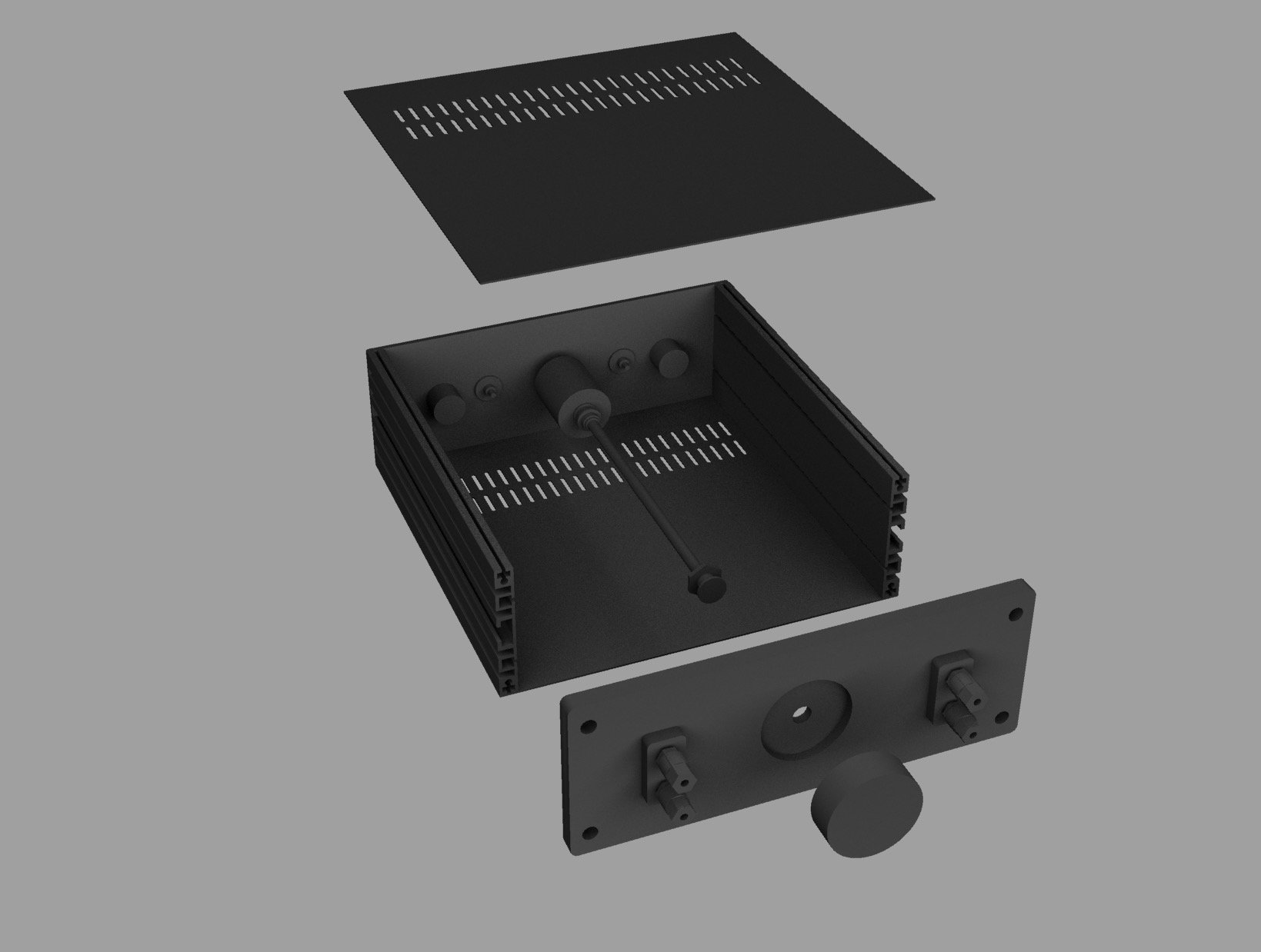

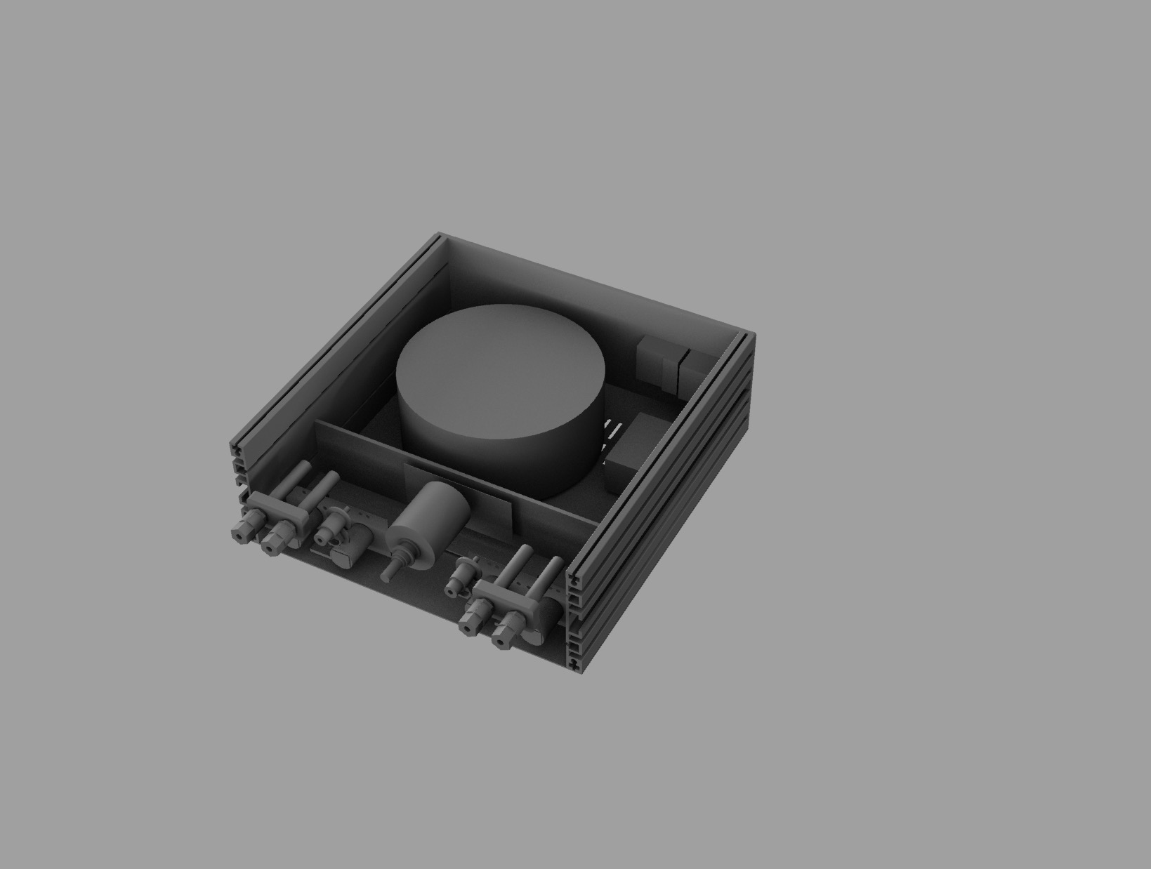

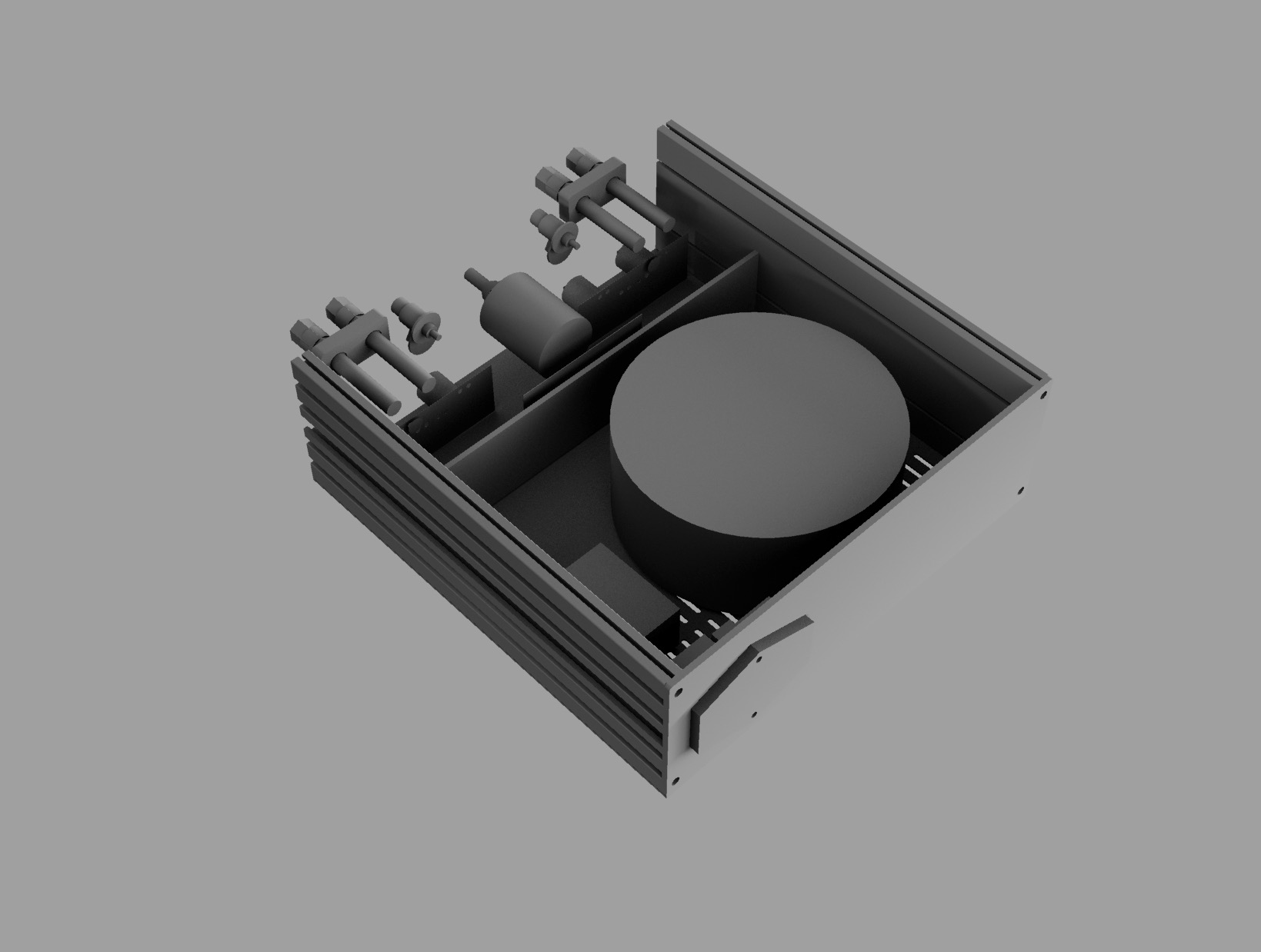

Thanks for the replay,
So I´ve put all components within one chassis now - see attached jpeg file.
Is this setup too tight? - or will it work?
I´ve put in a single 400VA transformer into the chassis of this integrated amp.
On the Toroidy webpage they recommend a innrush current limiter for 400VA transformers or above...
Still there`s something I´m wondering about:
1. Regarding the use of a single transformer: Since Toroidy is recommending an innrush current limiter for 400VA transformers and above - should I just go for a 300VA transformer?
- with 230V input.
- with 300VA nominal power
- and 25V output. ( 25V; not 22V , since my speakers are rated at 16 ohm )
PS: the diameter for the 400VA and 300VA Audio version from Toroidy has both a diameter of 130mm - but with the 300VA version I will not need room for the innrush limiter box...
Thank you again for the help - and your patience...

The dimensions are for single pcb: either amp or ps
The issue of grounding arrangement is greatly exaggerated by some people. Just build the amp and don't worry about it, if anything goes wrong it can be easily fixed.
No snubber parts are needed if you use reasonably sized caps (2200uF or so).
Snubbers were recommended for much larger caps (10000uF or so).
I leave my inbox full deliberately to avoid repeated PMs from beginners who want personal responses.
I assemble my own soft starts.
I have a selection of 3VA to 6VA transformers specially for powering auxiliaries in amplifiers.
T2A fuse allows for around 460VA transformer. That's quite high.
I find that with a close rated fuse and a soft start that T1A does for many transformers. I would only use much higher rated fuse for >=600VA and even then I would try using <T2.5A
A 625VA will soft start on a T1.6A fuse and allow a pair of ClassAB amplifiers to run at "party" loud volume.
