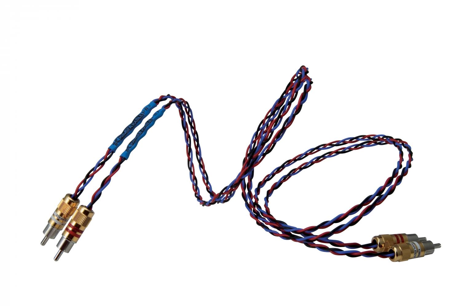

Kimber PBJ has been around for over 20 years and it's probably best known Kimber product.
Two wires for ground certainly improve shielding. There are other versions of this cable with single silver conductor for signal and two copper conductors for ground, and then there is a balanced versions where each wire is connected separately.
Low resistance in a return wire that shares it's duty with another circuit is an advantage.But why would Kimber do this? What is the point in having two wires for the return and only one wire for the signal? Has it got anything to do with shielding and the way they braid the wires?
Regards, Frederick Joan
The better way is to ensure the return wire does NOT SHARE it's duty with another circuit. I just googled kimber pbj to find it is a plaited 3wire cable, as is most of their cables/interconnects.
Twisted pair is better, less inductance and less interference.
star quad is better again, less interference at the expense of more capacitance.
I agree that Andrew said..
And a good way is when return wire is 1,5 to 2 bigger..
For example ( diy interconnect cable I build) :
for hot : awg 29 and awg 24
for return (cold) : awg 26 and awg 22
Two wires in same ptfe tubbing, and both twisted, or better with 4 tubbing in quad setup. But it's not easy to twisted 4 ptfe tubbing !
Generaly I use only solid copper (not several strands), but you can use silver for one or more wires, depends of taste.
Cables are unshielded for small lenght, max 0,8 meter.
Phil.

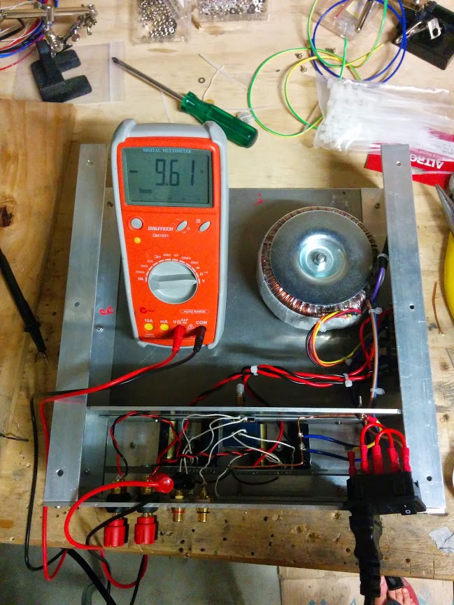

I have connected my transformer to the rectifier board (the amps are not connected yet) and noticed a hum from the transformer when it's powered up. The hum isn't very loud but can be easily heard in a quiet room up close. What is the cause of the hum and what can I do about it?
I also measure the voltage between the V+ and PG+ (as well as the the negative side) and measured +-9.45 V. In your instructions you specify +-20 Volts. My transformer is a 250 VA 25 + 25 on 230 VAC. Any advice and assistances is greatly appreciated!

....Further information about my build...I am building a stereo amp with single power supply using your premium kit Peter!
should give ~26Vac to 27Vac on each secondary winding. Check this.My transformer is a 250 VA 25 + 25 on 230 VAC
At the smoothing capacitors after the bridge rectifier you should have ~ 36Vdc to 40Vdc. Check this.
Post a sch of your PSU.
There are at least two ways to use your dual secondary transformer.
These are wired differently.
There's no capacitors on rectifier board, so the measured voltage should be expected low. After checking that voltage polarity is OK, you can hook it up to amp board, where the smoothing caps are located, and then measure the voltage. You will see that it's much higher after smoothing.
As to transformer noise, some people complain about it, and in most cases it is due to DC present on the mains:
http://www.diyaudio.com/forums/power-supplies/245129-blocking-mains-dc-offset.html

I have rectified the "alleged" problem of the low voltage - operator error! After measuring it properly I am getting around 28.7 Volts on both boards, measured at the connection to the amp board.
The hum persists and I'll have to wait until I connect the amp up to determine whether it's going to be a problem or not.
My next problem is the measurement of the DC Output Voltage - I measure -9.61V at both speaker terminals, regardless of the position of the volume pot. Any ideas as to why?
I have a feeling that it's also "operator's error"

Thanks for the prompt reply. Any suggestions as to what the operator might be doing wrong? I was a bit more diligent in my testing this time round and checked I hadn't made the same mistake again. I have checked my wiring and as far as I can tell it appears to be correct...or maybe not!

ok so I installed the jumper wire in place of r1 and re-tested:
volume pot down (L)-17.3; (R)-32.8
volume pot up (L)-20.7; (R)-35.9
The Right hand chip got pretty hot also -too hot to touch!
Any ideas?
Tim
