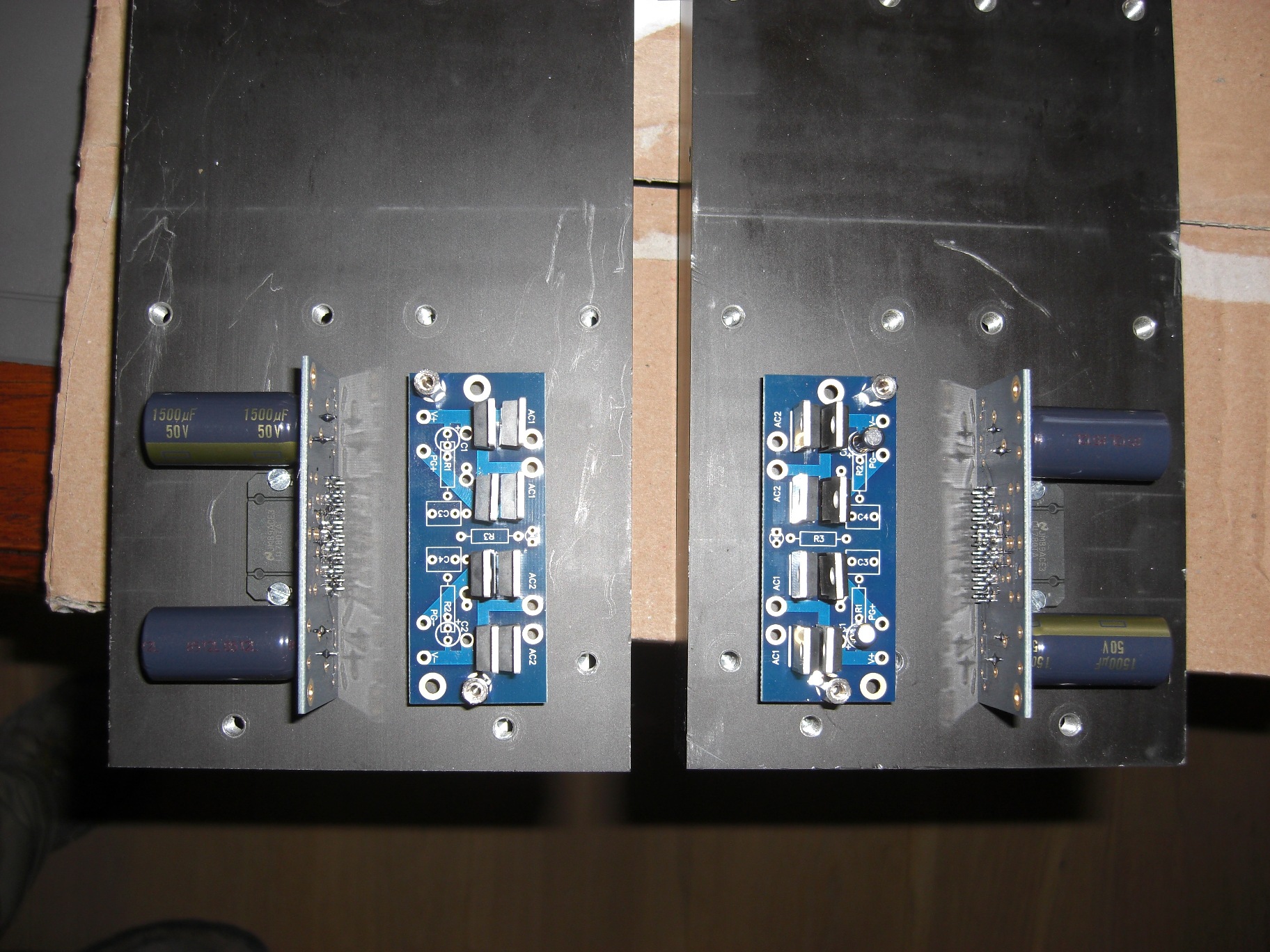

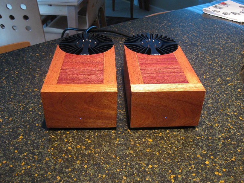

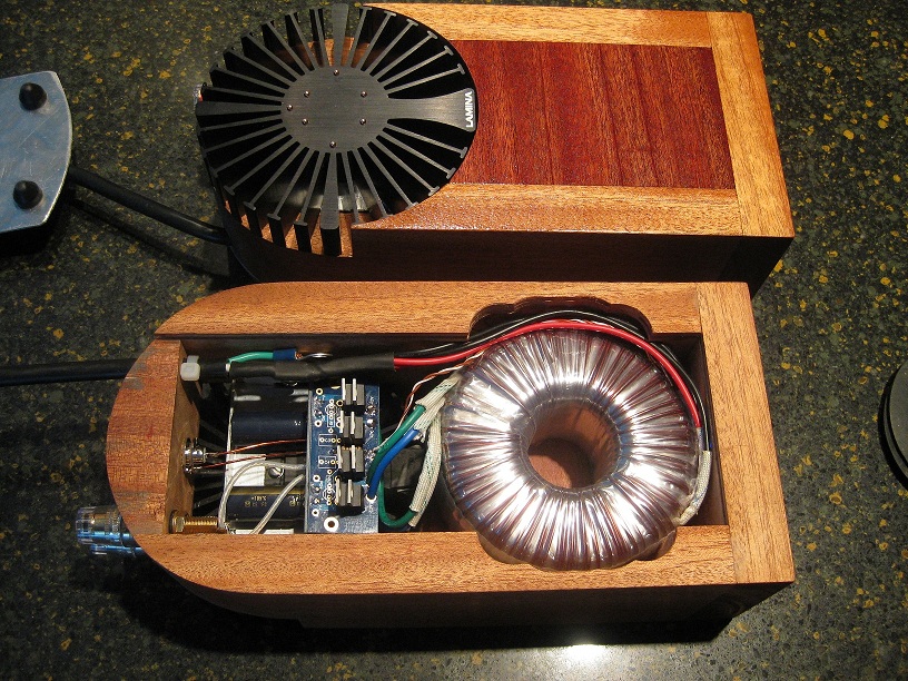

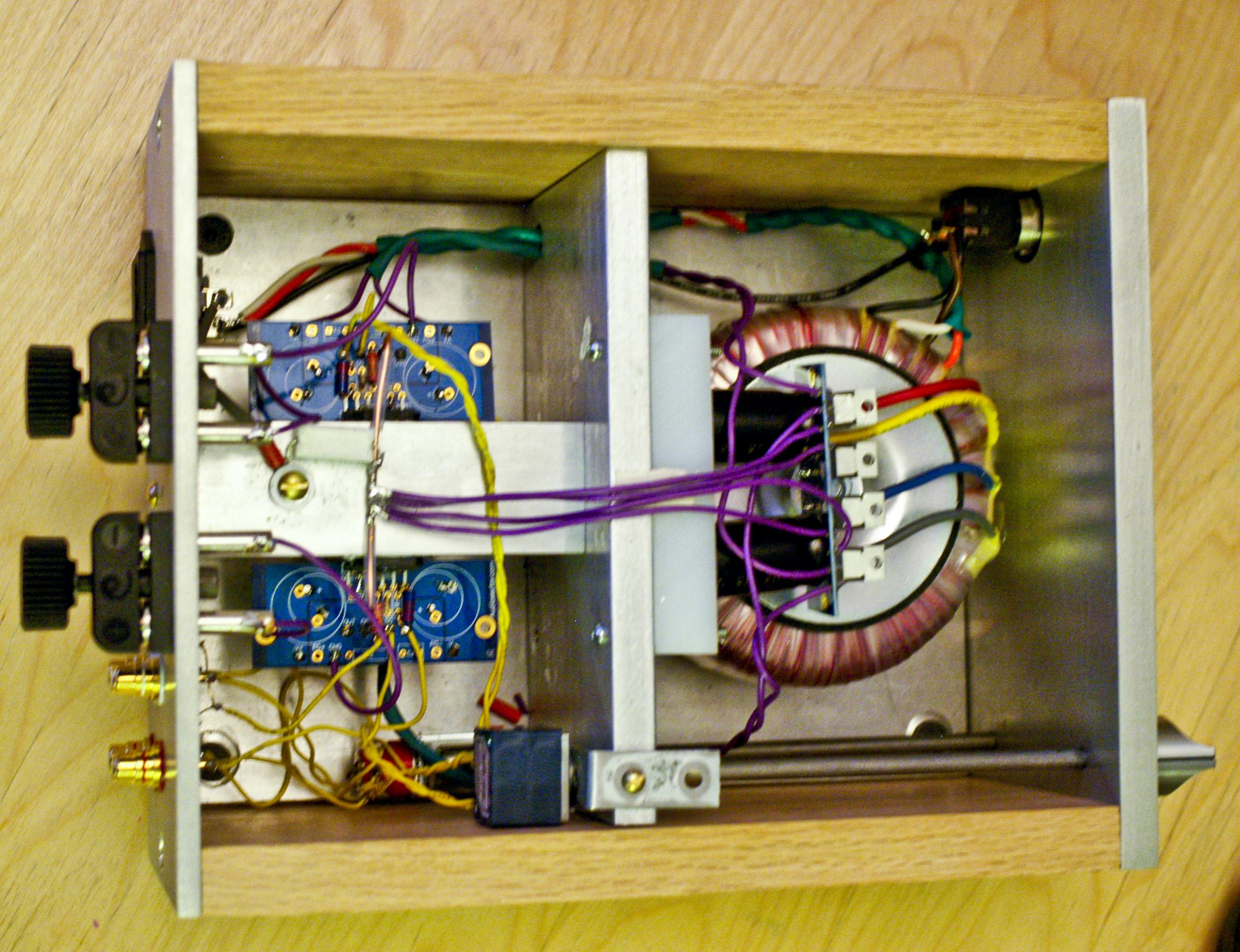

Here's my version of the basic mono blocks. 22v-300va toroidals... have put about 100 hrs on them with 8ohm speakers. I will be using them on a pair of PSB Alpha b1s most of the time.

Great build! Love the look. What heat sinks are those?
The heat sinks are from a company called Lamina.Great build! Love the look. What heat sinks are those?
http://products.lsgc.com/uploads/tx_flexproducts/Light_Engine_5-21-08_Accessories_Datasheet.pdf
I got them from Mouser. like 25 bucks a piece.

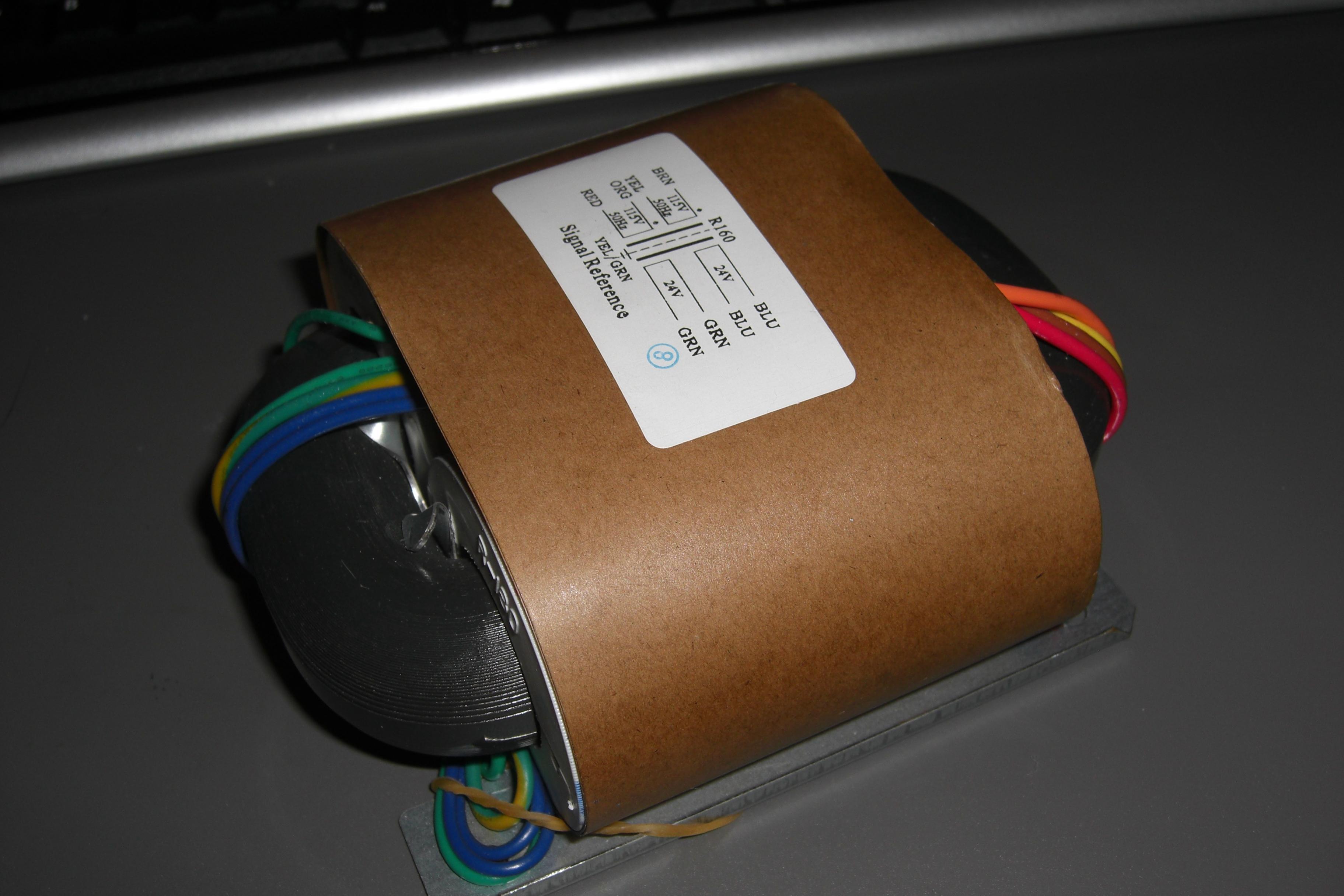

i just recieved my transformers for my amps. I use 4 of your lm4780 in bridged mode, 2 per channel, 1 for highs and 1 for lows with an active cross over. The transformers are 200VA each, and each LM4780 wil have its own transformer and rectifier board, so the amp will be completely dual mono.
xlr input--LM4780 bridged--rectifier--transformer.
Each transformer has 2 x 2x 24 and one central ground. As i understand i need to use a star ground for the PS and connect the signal gnd directly to the LM4780 board. But i still have some questions
- should i also connect the central earth of the transformer to the star ground?
- should each channel have its own star ground? (but i use a full aluminum casing

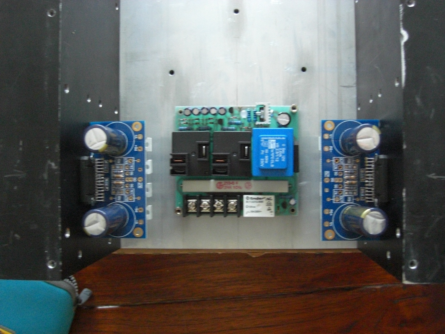

Some pictures of my housing, first setup. There will be a dual compartment in the front, for each transformer
I also added a soft start and a speaker dc protection (central pcb). The amps will have xlr inputs and get signal from an active cross over and pre amp (both fully balanced).
In the pictures you can also see the transformer i will be using (4 in total, 2 per amp), R-core 200VA
Finally i will use a copper bar to press the LM's to the heat sink and not use the screws like in the pictures.

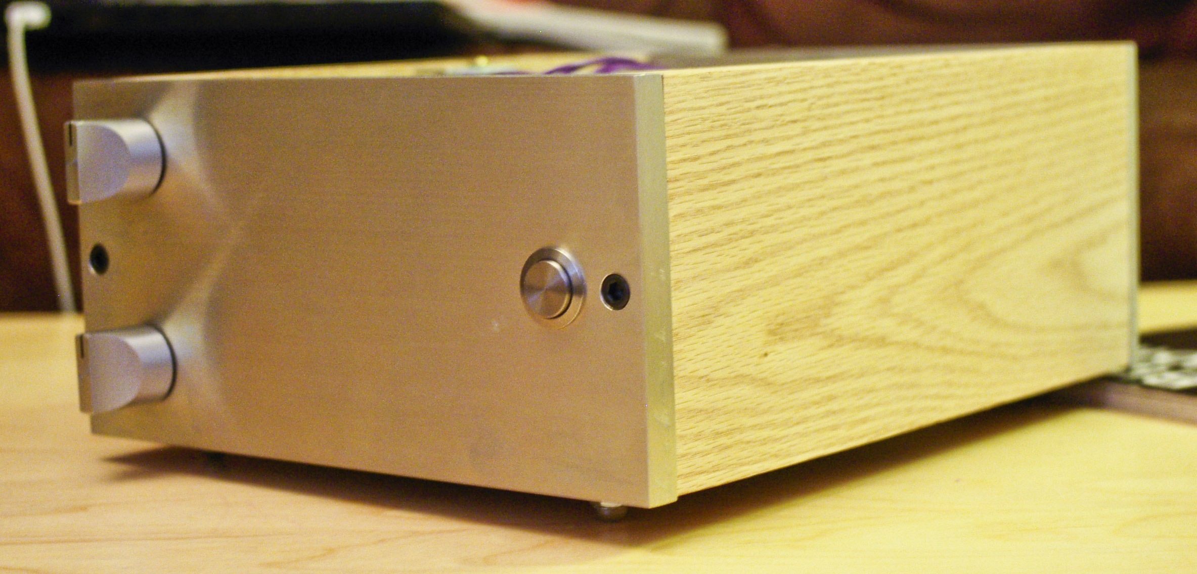

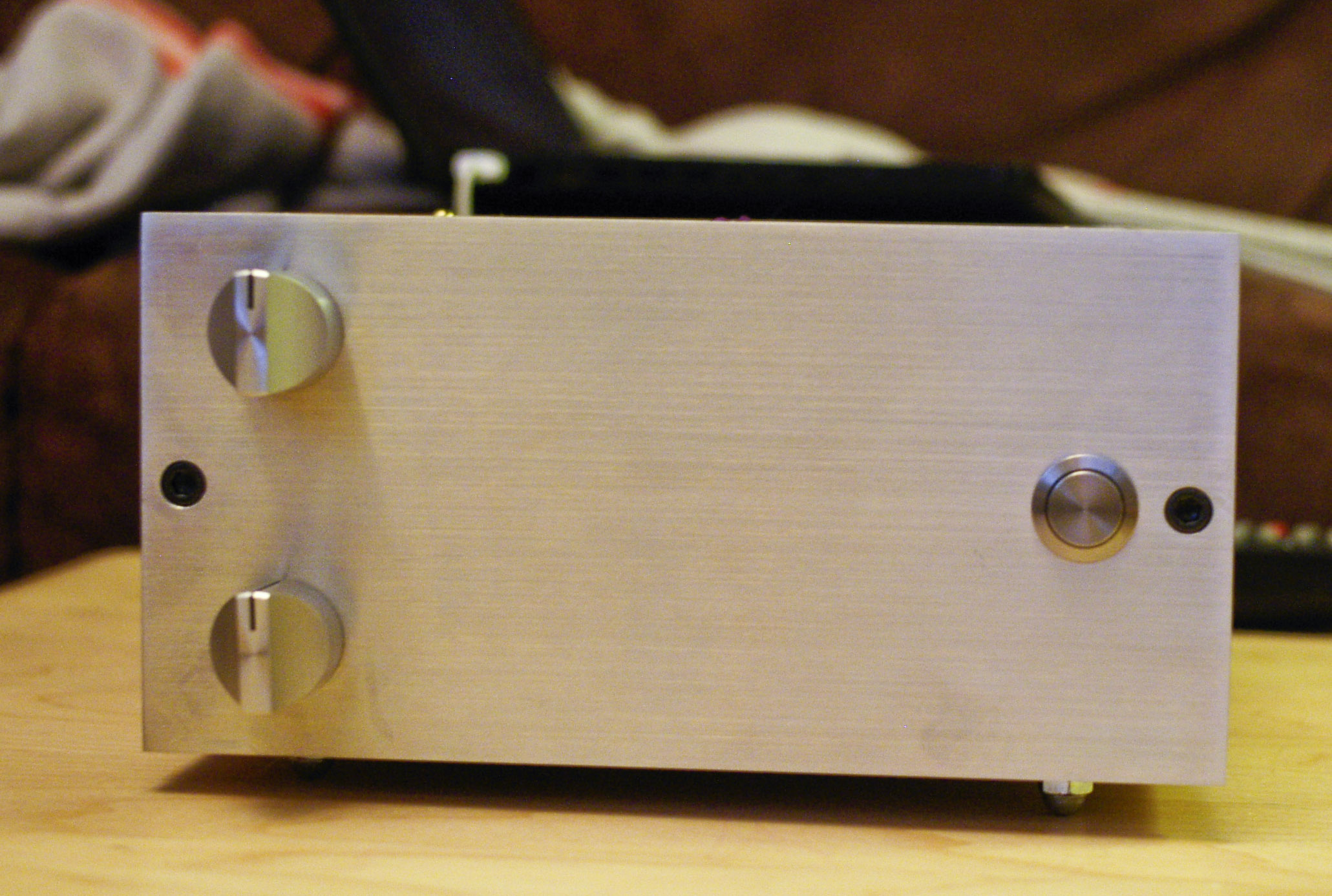

Finally I finished to assembly my first chip amp. Not totally true, The only thing missing is the cover. First I thought about perforated aluminum for the cover, but the amp seems to not produce much heat, I think simple aluminum sheet will do the job.
My amp is based on Peter designs and ideas. As the Blackgate N 100 are so expensive, I go with Blackgate K 100 ( it is FK but in more compact version). I just take the integrated version and made it more compact. Just test it with Philip Glass string quartet and it sound great. Now, I need to find a place to anodize the faceplate.

etoiledusoir - nice looking amp! Have you shrunk the case dimensions and made your own or are you using parts bought from Peter?
