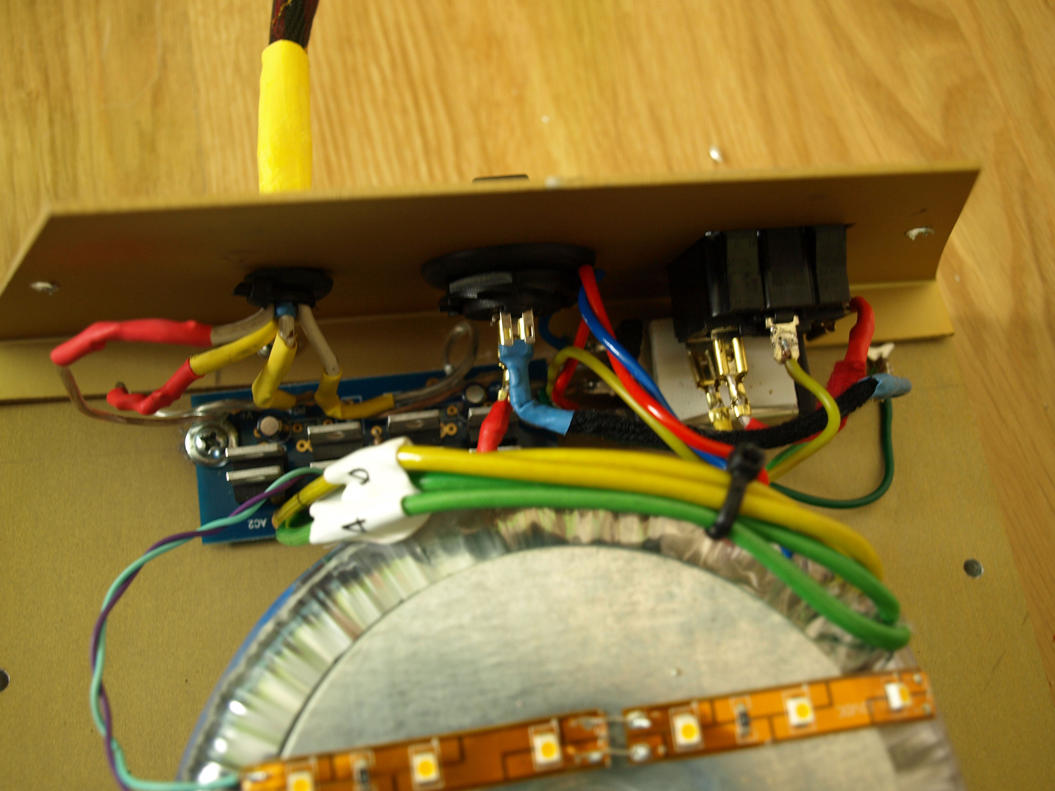

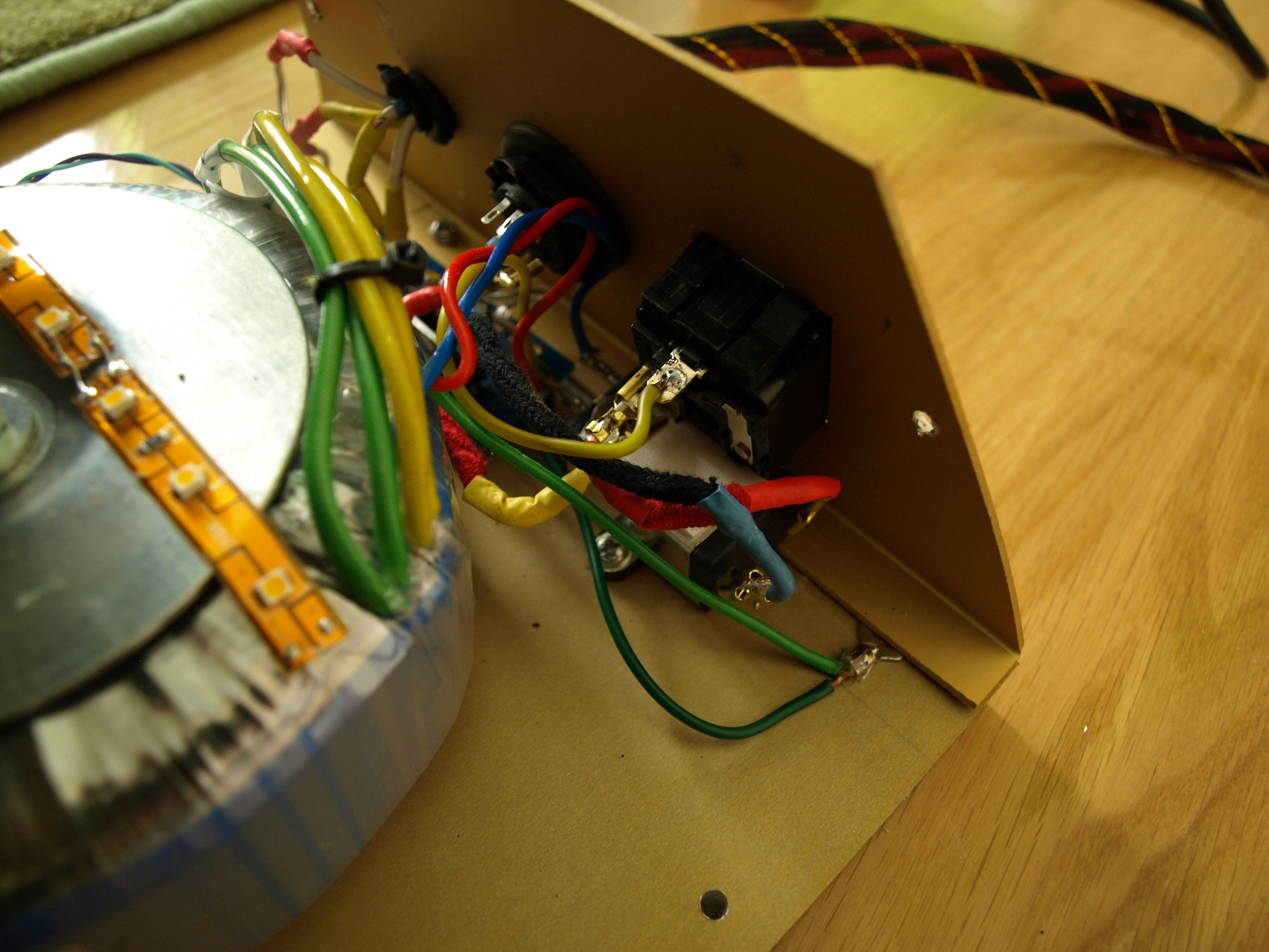

Now some picts from the PSU if you got something to suggest its always welcome.

Hi Nick,
Is your baseplate covered with something like a paper or some other coating? it looks kind of brown so it has me wondering. If it is this should be removed at least where you will ground it. Then your ground leads need to be attached with a bolt and nut to the baseplate. They cant just be sandwiched between two pieces like that. If they are lucky enough to wiggle free you may hurt yourself the next time you touch the chassis.
What is that strip across the top of the toroid?

Hi Uriah
Whell actually is juts aluminum anodized gold, no paper covers or something.
The spade (once again hehe) is not actually sandwiched as it looks for the first look.
Actually ther will be a bottom bolt when the cover will be mounted. But i get you point about safety. i will drill a new hole.
The strip is just a 12 v led strip.
Since the top cover will be sanded dark red plexiglass it will light up to give just an effect.
