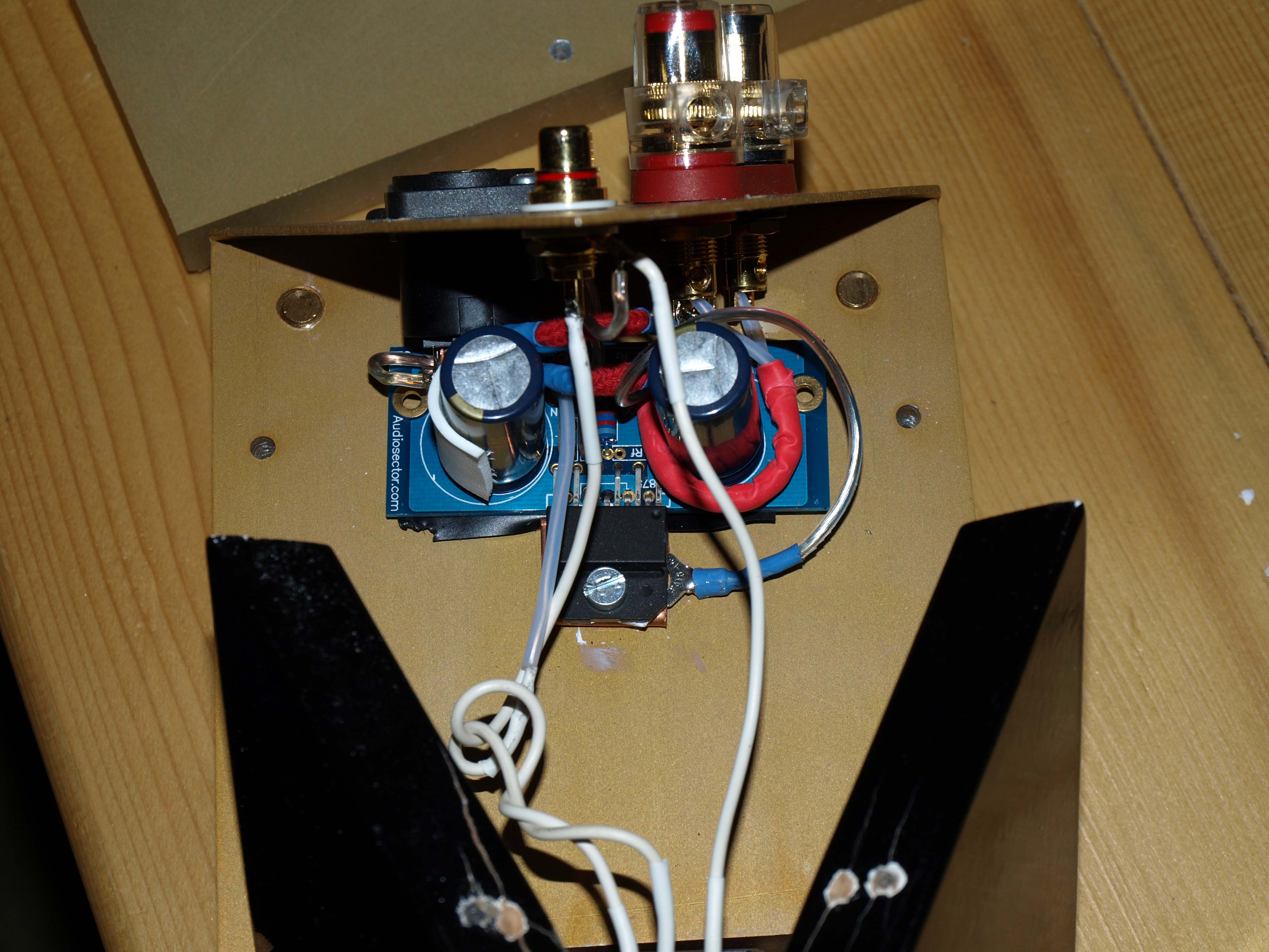

How is the TF chip mounted to the heatsink?
Where does that cable go?
Is the TF thermally coupled to the heatsink or is it mounted dry?
How does the heat get out of the TF?

It is mounted through a bolt. Actually the bottom of the amp is the heatsink (2cm thick aluminum plate).How is the TF chip mounted to the heatsink?
its going to the chassis ground on the amp boardWhere does that cable go?
I use Zalman thermal greace used for computer chips.Is the TF thermally coupled to the heatsink or is it mounted dry?
the Aluminum board stays pretty cool if thats what you mean. The tf is attached to the heatsink throug a copper leaf.How does the heat get out of the TF?

your answers do not look like the pic (superb quality and focus).
Sorry i lost you 🙂 Why my answers does not look like the pic? in which case?

what is between the chassis base plate and the TF mounting face?
What you listed is not what I can see in the pic.

i see , well there is a small copper leaf and some thermal paste, the nfoto is actually reaaly big if you enlarge it you can see them 🙂

I think I see some folded copper sheet, or is it a flattened copper tube?
I think I see a spade connection inserted under the TF.
I think heat conduction through that assembly will be atrocious.
I ask again: WHAT IS BETWEEN THE TF AND THE HEATSINK?

It ia copper sheet yes (i used leaf) its foled and flattened.
this spade is in between the copper and it goes to the chassis ground marked chg on the board.

remove all that rubbish from between the TF and the heatsink.
If the TF is too far off the heatsink to bolt on direct then insert a solid block of aluminium to fill the gap.
The surfaces of the block must be flat and fairly smooth.
The interface between the TF and the Block must be filled with thermal compound as thin as possible with no air and the interface between the block and the heatsink must alsp be filled with a thin layer of thermal compound.
Nothing else should be in there to interfere with the heat conduction from TF to heatsink.
The TF is very poor at conducting heat to the sink, do not make it any worse.
Next time insert the 3886 from the back (bending the legs in the opposite direction) to allow direct mounting to the heatsink.

Originally i thought copper sheet between because it will take the heat faster and give it to the aluminum for spreading.

Andrew is right. That spade appears to be under the chip, between chip and heatsink. The chip must be intimately attached to the heatsink.
Also, please use your DMM and measure for DC voltage on your amp outputs that go to your speakers while the thing is playing.
I am worried you burnt your voice coil by inserting DC from the amp into the speaker. It slowly cooks the coil and the speaker will still play while this is happening.
Still, the way that thing is connected to the heatsink just looks wrong. Nothing should connect to that chip besides the board and the sink. Thermal paste only between the two. If you want to ground the sink do that somewhere else, not near the chip or any part of the board that has bare wire/leads.
It will act as spreader only if it's larger than the chip. In your assembly it's not, and it actually makes the heat transfer harder. And inserting the spade inbetween is completely wrong.
