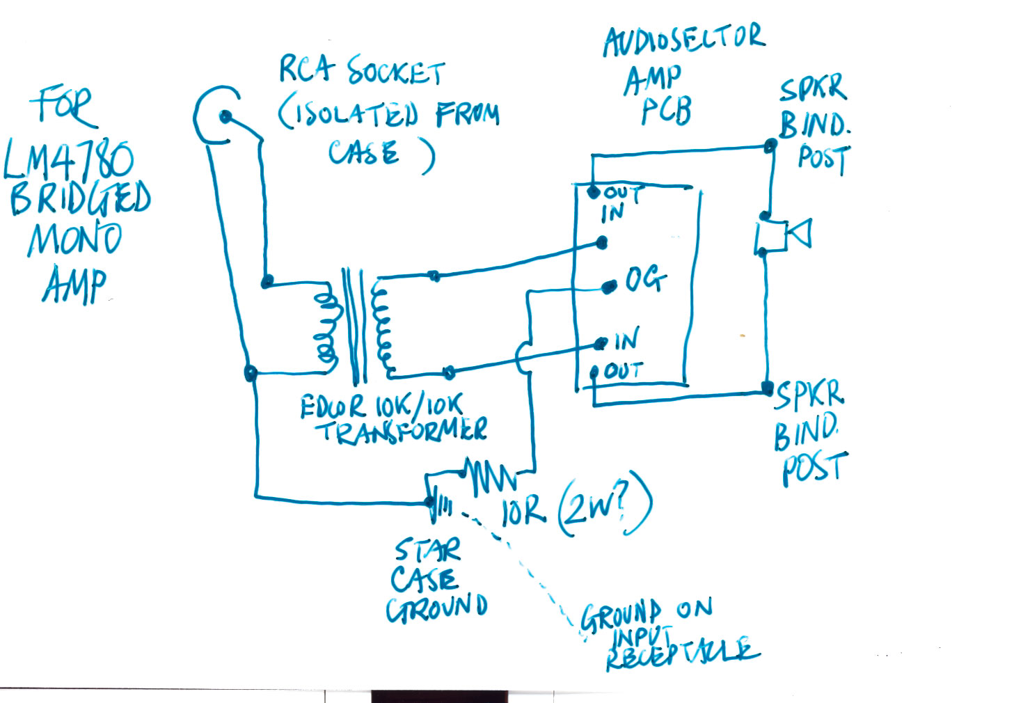

I'm almost ready to power up my 4780 bridged mono amplifiers. I need to check two things. (1) In an early post Peter Daniel stated it needed a balanced input and provided a circuit diagram. I figured I could put the transformer in the amplifier case and use the attached circuit, so I thought I'd check with Peter (or anyone else) that this would be OK. (2) I send the OG from the amplifier board to the case ground point and use a 10R resistor at that point. Does it matter what the wattage of the resistor is? I was thinking of using 1W or 2W.
I wouldn't connect RCA ground to chassis. You can install a toggle switch between RCA ground and SG pad on amp board and have it either open for input ground floating (not connected) or closed for hard wired grounds (connected). You may notice slight difference with each setting.
1W or 2W resistor would be fine.
I just noticed it's LM4780 bridged amp. In that case the grounds need to be hardwired (permanently connected) so just run it directly from RCA to SG pad. It was discussed here: http://www.diyaudio.com/forums/showthread.php?t=149617
Thank you again. I had seen that thread but I hadn't made the connection (!) I recall from a post somewhere that the SG is connected to the OG on the amplifier board (as the diagram shows) and I now see that connecting the RCA ground directly to the case ground might just introduce the possibility of a hum/loop.

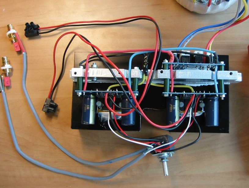

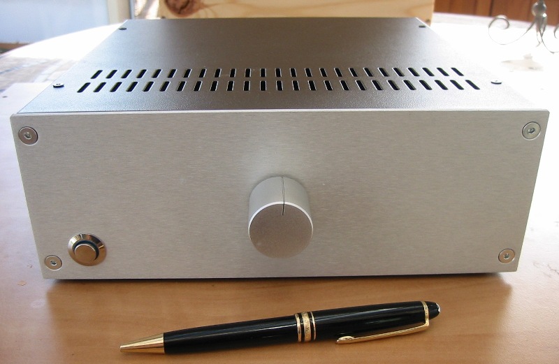

hello all
just want to show my amp.
Dual mono kit, LM4780, parallel
single 2x21V torroidal, 300VA
the plan
offset 23,4mV (right channel) and 15,1mV (left)
no hum at all 🙂
It looks good, is small and sounds great, but I am quite disapointed by its power. Also short on bass for my taste.
I expected more power in my 4ohm Zaph SR71 diy loudspeakers.
I will upgrade with a 2x24V torroidal and add 4x10 000 µF capacitors in parallel to the 10µF on the rectifier board.
BTW, yes I blew up the chips and capacitors when I first mounted the MUR diodes reverse on the rectifier !!

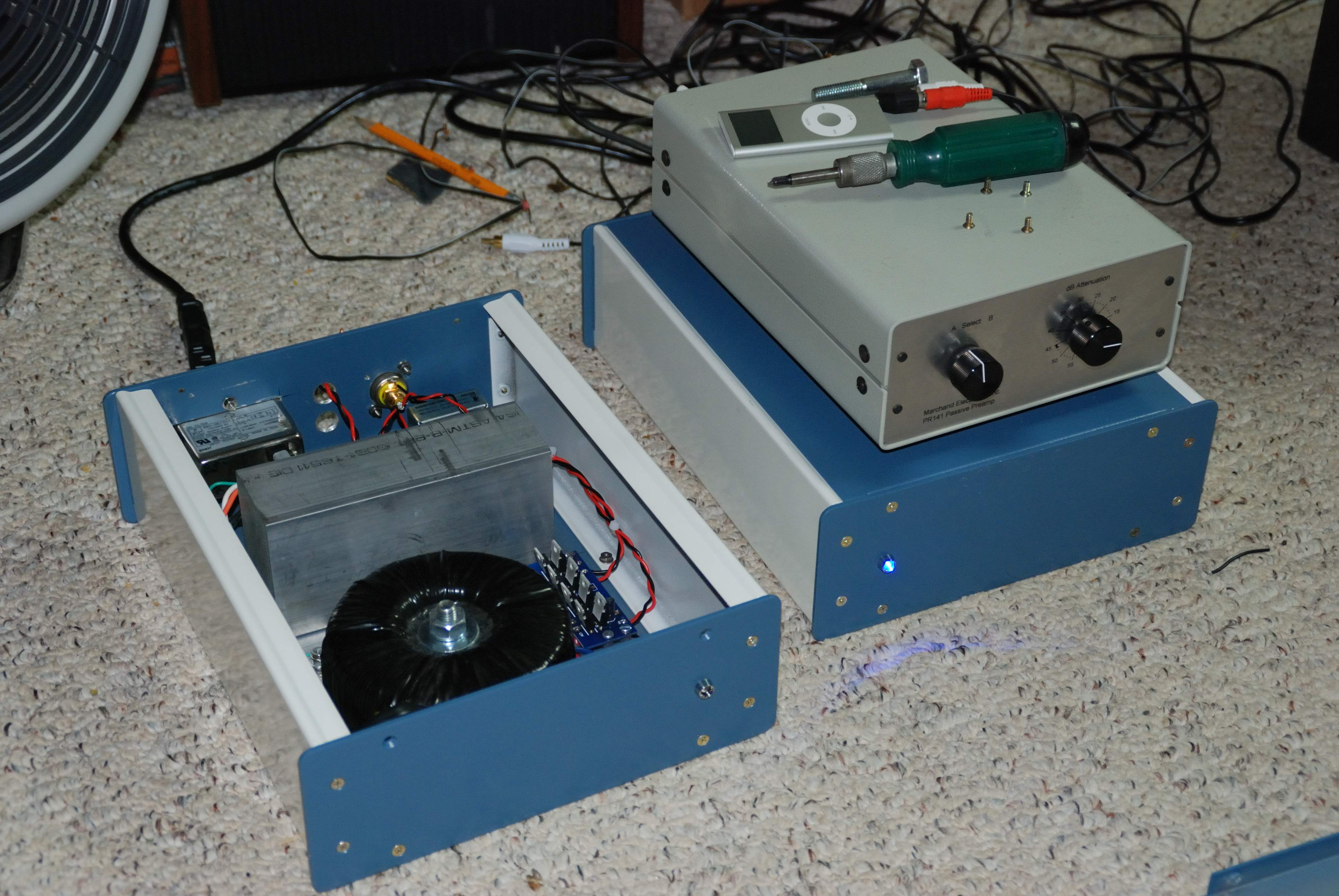

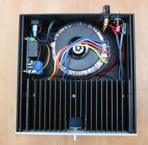

Finished at last
Two bridged mono LM4780s. They work. (Except I forgot to get feet, so they balance on the transformer mounting bolt). This (and related threads) have been really useful.
