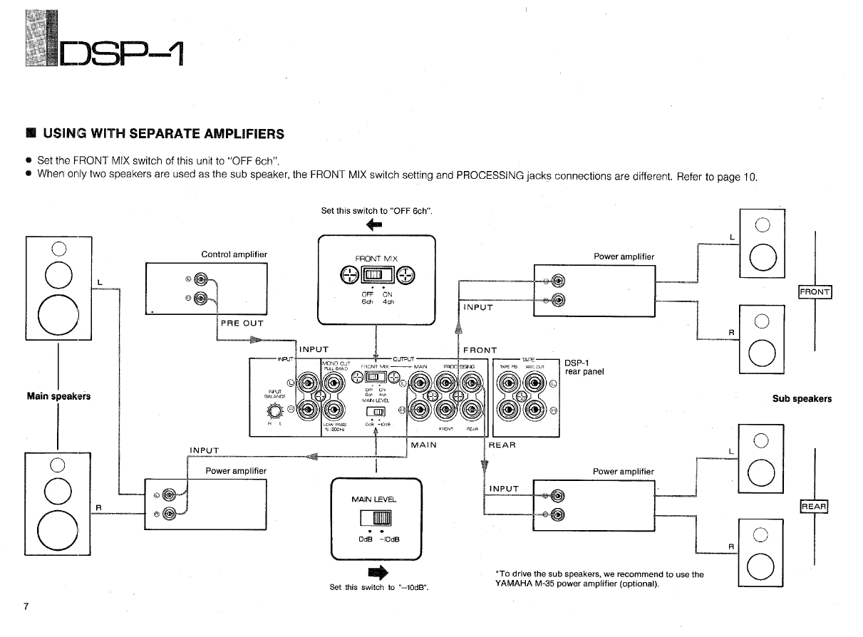

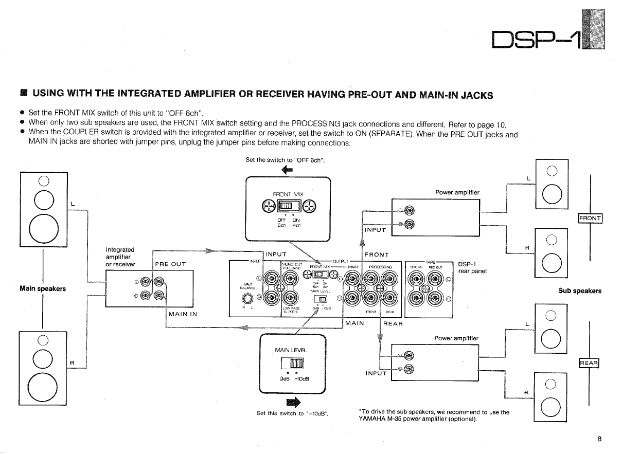

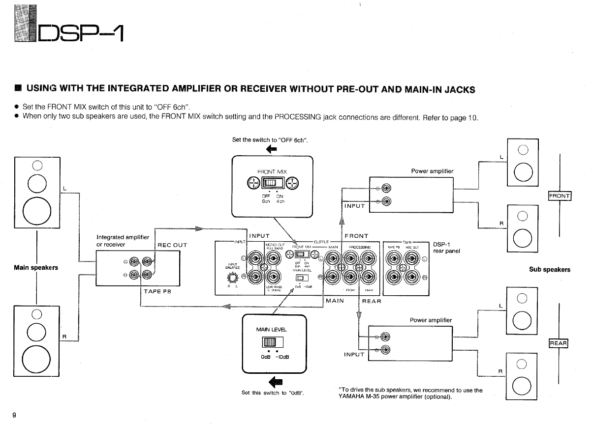

I have an old Denon DRA550 receiver with a blown right channel. As it is expensive to fix it I thought I might use it for parts.... is there anything in there that I can pilfer for this project?
I also have some Yamaha gear that has been in storage and I was thinking of maybe reviving it - one unit is a DSP-1 Surround processor and an M35 power amp. What would I need to connect one of these little amps to the DSP-1? I have attached the 3 possible methods explained in the DSP-1 manual....
If none of this is possible, I will just build a standard unit and have a play 🙂
