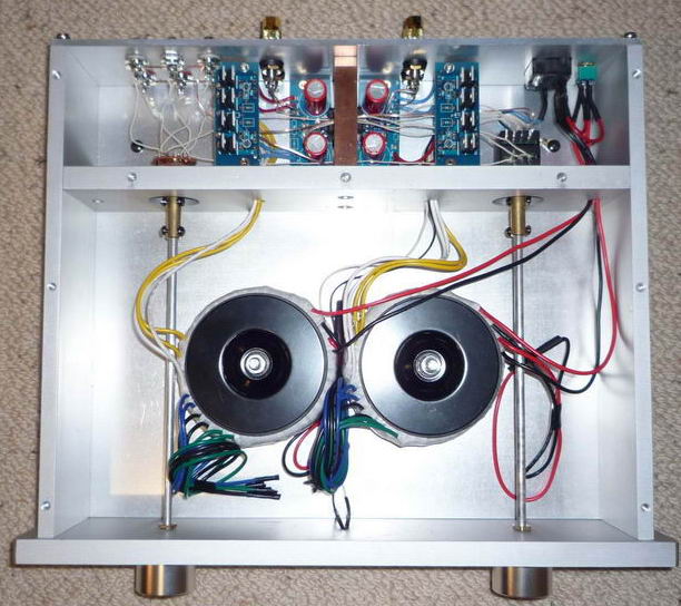

dual mono

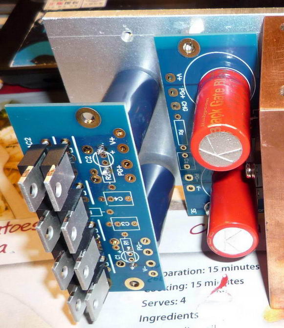

beauistheman said:
cyxg,
what caps are those on the rectifier pcbs? What are the results of using different value caps on the rectifier boards? (sorry noobie here) Also, where did u get that chassis, im struggling to find good aus cases haha?
it's panasonic caps on the rectifier pcbs.
chassis is DIY by my self, use CNC machine.

yeah i have read through it, but i get confused sometimes. In one set of pictures caps are installed on the rect board, then in another, the caps are gone and different caps are installed on the amp board etc. Im trying to figure out the effects that each component has on how the system operates. In some pics there are no caps on the rect board and no resistors on the amp board.
I dunno, i just get confused because i keep expecting it all to be the same and i believe the kit has different components now. Anyways...
