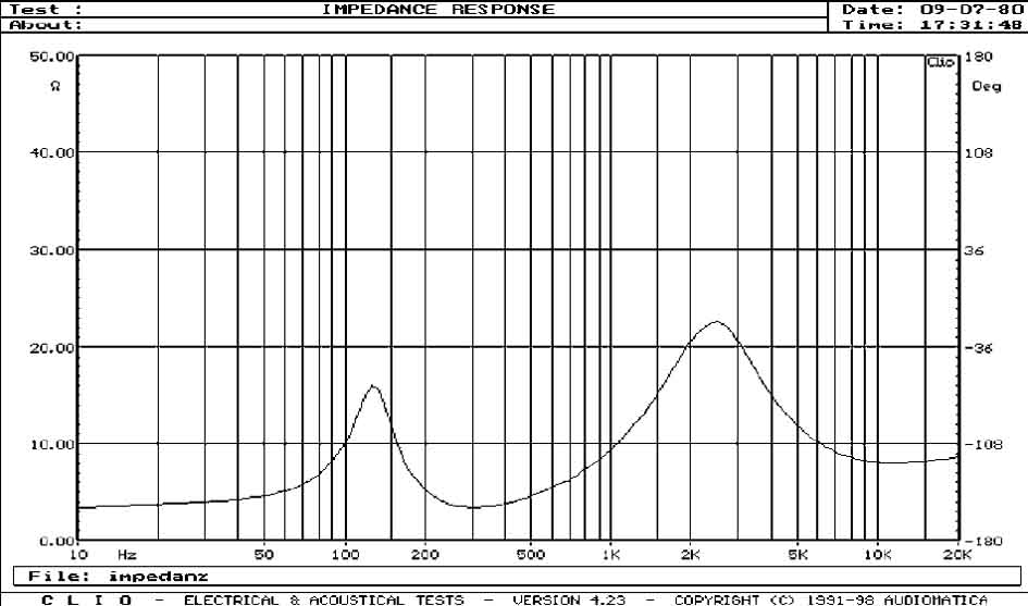

use of LM3875 kit from Audiosector with a 4 ohm loudspeaker
Hi all
I’m very interested in build a LM chip-based amplifier for using it in my secondary system, connected to an old Meridian 206 CD player and a pair of DIY loudspeakers. My doubt is what chip to use. The LM3875 kit from Audiosector is very interesting, because there is a Premium version available (chips selected for very low DC-offset, high quality components), its rectifier PCB is very small (the same size as the amplifier PCB) and Peter Daniel gives very good technical support for builders here. However, I’ve read that this chip is less appropriate for low impedance loudspeakers that the LM3886, so I hope you can give me some advice.
The loudspeaker I’m going to drive with the chipamp is a small DIY loudspeaker from the Intertechnik catalogue, the model called “Kohärenz”, based on the Seas MP14S/H719 4 inch 2-way coaxial driver. My 15x15x30cm enclosure (internal volume= 4.3 litres) is a little taller than the described in the kit.
The loudspeakers are used in a small room (11 sq. metres), placed directly on a desk and against the rear wall. I like its coherent, clear and controlled sound. I listen to them from two different positions (one at 60 cm and other at 2 m distance), mainly classical music at low volume, and I’m not a bass-freak. According to the Intertechnik catalogue, the Kohärenz bass driver is 4 ohms nominal, and the impedance vs frequency curve is as shown in the attached image. It is rather low, with a minimum of 3.5 ohm at 300 Hz.
Do you think the LM3875 is suitable for this specific loudspeaker and my listening habits, or would the LM3886 be a better choice? If so, is it possible to use the Audiosector kit with the LM3886 chip or I need to buy the Chipamp.com kit?
Thanks in advance

Re: use of LM3875 kit from Audiosector with a 4 ohm loudspeaker
I say stick with 8ohm or greater.
There are many that use and recommend 4ohm speaker driven by chip amp from a lower voltage PSU.spendorspain said:the Kohärenz bass driver is 4 ohms nominal, and the impedance vs frequency curve is as shown in the attached image. It is rather low, with a minimum of 3.5 ohm at 300 Hz.
