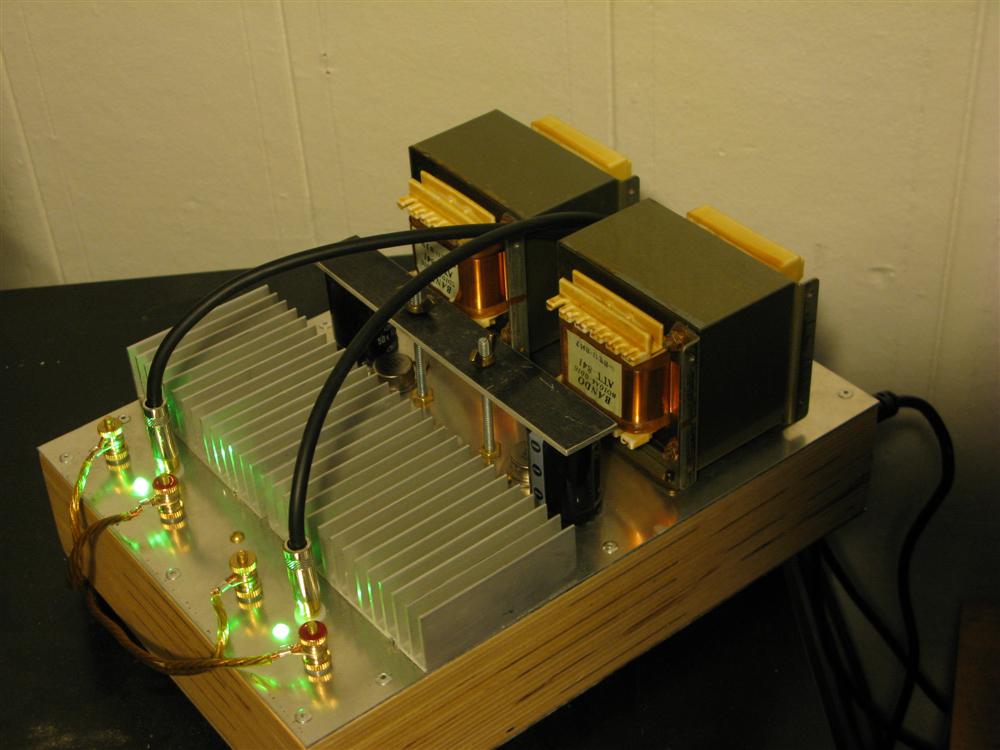

Here is how she turned out. I opted to use my salvaged transformers and build a regulated PS. Everything went pretty smooth until I started testing it and the left channel of my wife's ipod went out and decided to have a 1200 mV bias on the left channel while playing nearly at full tilt. This caused the left channel to be offset at 29 v and quickly destroyed the LM3875. I shut it down quickly enough that the speaker survived unscathed. It took a bit of time after that to figure out the ipod was the culprit.
Nothing a quick digikey order and a new ipod can't fix. I seem to be back in business now. I have to say, I'm really quite impressed with the bass control of these little chips.

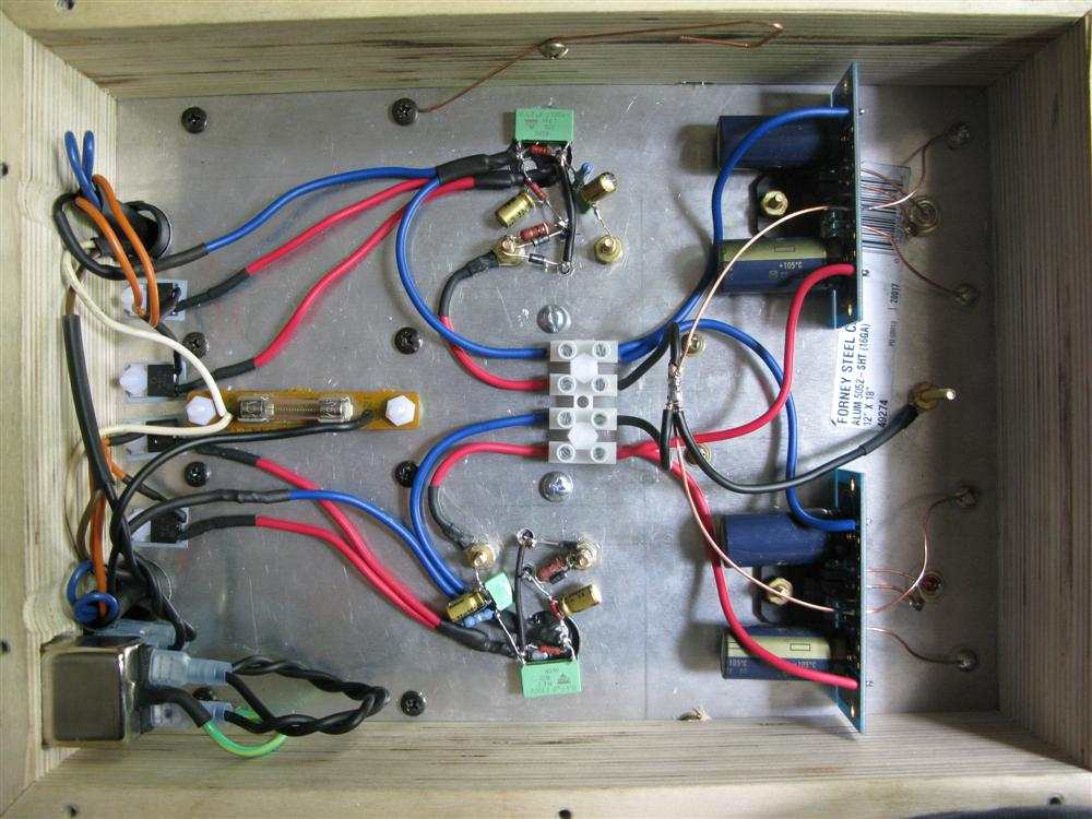

Here's an inside view.
Power supply wiring has changed since this picture was taken. The fuse is now before the switch. The IEC ground can be seen on the bottom left. The copper wire on the side of the amp grounds the top of the amp to the bottom.
Rails read +/- 30.7
Rails read +/- 30.7

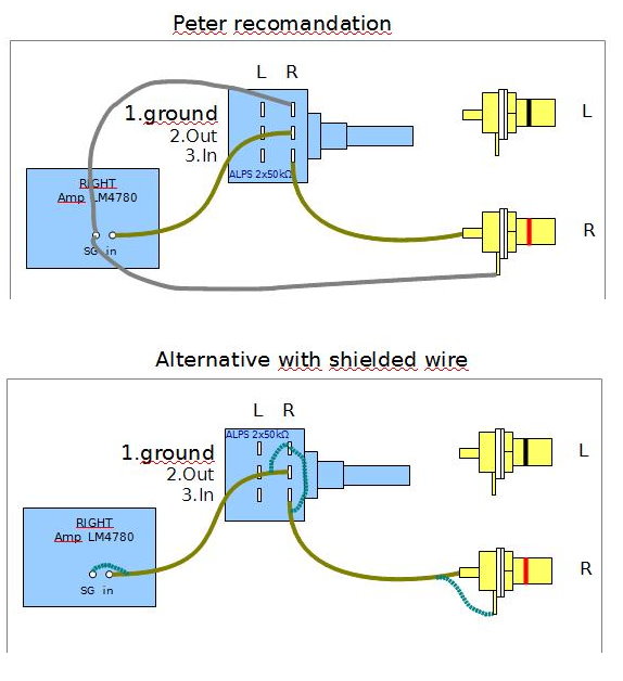

i start to build a LM4780 parallel mode.
Input signal cable will get very close to the transformer in my layout. I was recomented to use shielded cable.
two options
1) recomended by Peter (use SG as star ground)
2) my suggested alternative with shielded cable
any opinion about my wiring proposal ? any other suggestion ?
