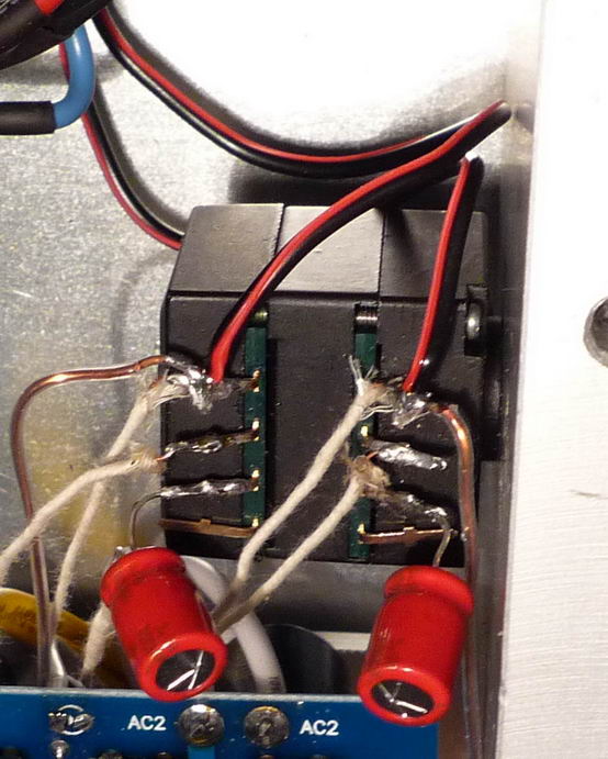

I found out something quite interesting today about my slight low level hum problem (even though it's not really a 'problem' to me):
When I powered the amp on for the first time I used a 0,5m USB cable to connect my laptop (IBM T22 with PCMCIA USB 2.0 card, because USB 1.0 doesn't work with USB DACs) to the DAC. This cable has a ferrite ring on the end directed to the laptop. Today I tried a different cable, also of 0,5m length, which hasn't any ferrites. With this cable the hum increased quite a lot!
Then I tried another cable with ferrites on both ends of the cable, and with this one the hum was almost gone completely!
So I think with a high quality USB cable with large ferrites on both ends I can live with my grounding method easily without the urge to reconnect (and resolder!) everything.
Regards - martin

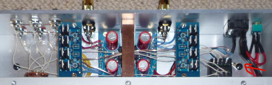

If the hum changes with different USB cable types, you grounding is most likely fine. Please note that amp has relatively high gain (33dB or so) so any noises from the source are more audible.

after built my amp, first time i open it. i can heard the hum at middle volume. the ground only 1 point connect to chassis,see pic

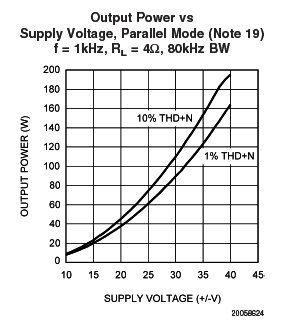

I think about building the LM4780 dual mono kit (paralel mode). I have 4ohms loudspakers.
I have a question regarding the transformer voltage. The diagram show on page 1, and recomendation in this topic is 2x18V, which would be 18x1,41=25V DC
this graph below is from the LM4780 datasheet. This suggests that 30V DC or even more is adequate. Is this correct ?
