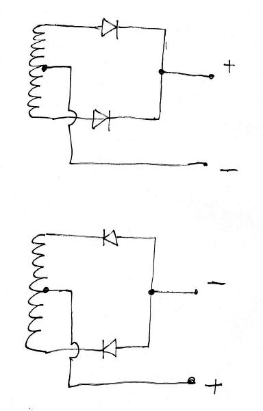

I suppose the easiest way to go about this is to give up on dual mono and have a single PSU power both channels. That way I can use each transformer to power each rail of a regulated power supply (with center tap wave rectifier).
Building a dedicated regulated supply for each channel isn't straight forward enough for me to attempt given my very limited experience. Since I have center tapped transformers building one seems to require a 5 amp negative voltage regulator (complementary ICs to the LM338) which don't seem to be commonly available.
Does this plan seem reasonable?
Roger
If you use half of each transformer, you can build a positive regulator on each.
Couple the two +ve supplies together to create a dual polarity supply.
What a waste of resources.
If these transformers are so important to you then buy amplifiers that suit +-50Vdc supplies.
You can use one (complete) transformer per rail, if you wire them as in attached schematic. This setup will also allow positive regulator in a negative rail.
Such supply would be powering both channels.
If you need dual mono configuration, with separate supply for each channel, you need to source suitable negative regulators.

Thanks for the advice. I'm dead set on building a gainclone from a audiosector kit due to their simplicity and the detail Peter has put into the instructions. Whether I use these transformers with a regulated PS or buy toroids is still something I'm tolling over. I might just save these for a more suitable project down the road.
Peter,
I placed an order for a premium kit. Thanks for the schematic. We are still on the same page.
