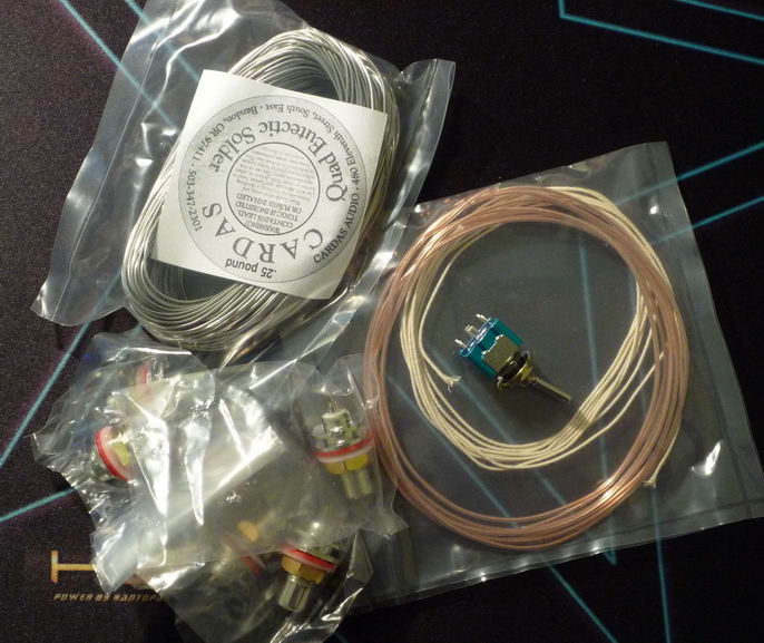

I want to add an input selector such as the one cyxg has built into his GC amp. I've found a few that look similar and don't clearly know what the specs mean and the specs required are.
I'd like 3 inputs, what kind of Rotary Switch should I go for?
Also for hookup wire, would this be suitable?

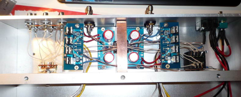

Hi,Matt
I use Rotary Wafer 3 Pole 4 Position, but i just use 2 pole(right/left)and 3 position.
About wire, the silver wire is better. i don't know how can i find it in Australir.

cyxg said:
Hi,Matt
If it's not too much trouble could you email/pm/post a few photos highlighting your hookup to the Rotary Switch?

Thanks, but I've found some decent enameled copper that I think I'll use.🙂
mattcalf said:
Thanks, was hoping for a closer shot of actual wiring but this should help. 🙂
