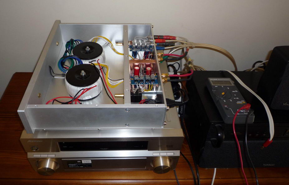

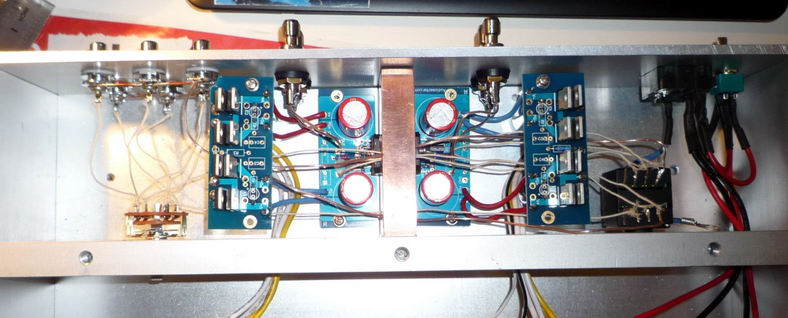

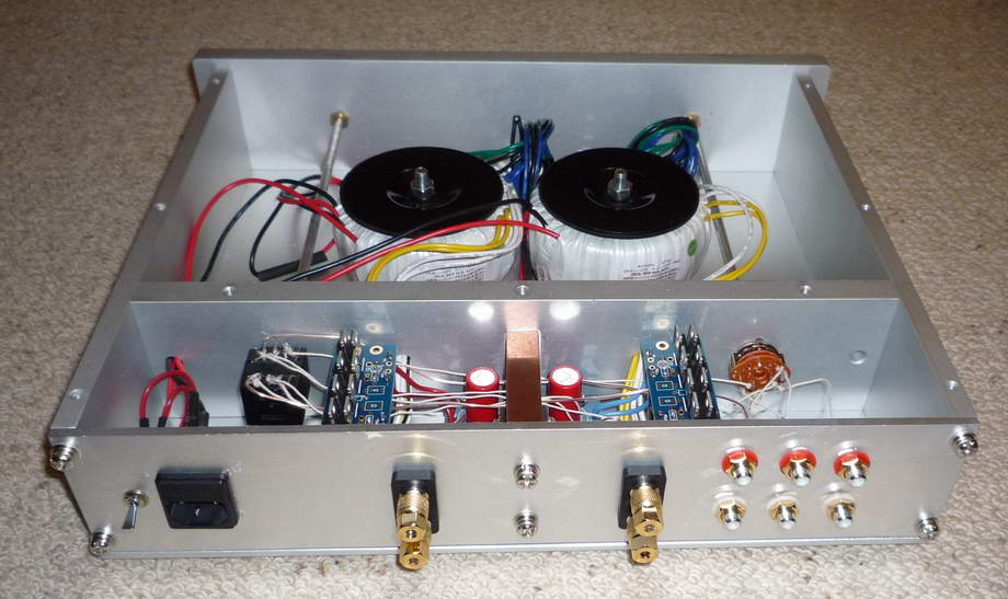

Peter Daniel said:Congratulations, it looks really good 😉
Hi,Peter
i running the amp 2 days.my speaker is PROAC response 2.5/8ohm. To compare with my another Velleman K4040 Stereo Vacuum Tube Amplifier. http://www.tubedepot.com/diy-k4040.htmlI feel lost some treble and bass not clear.
Could you tell me how to improve it.
