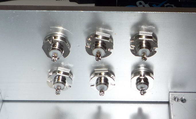

my RCA is direct ground to chassis.
Elsewhere in this thread Peter suggests insulated RCA. I am a newbie, but I guess that with your RCAs you completely change the grounding with respect to what suggested by Peter
Renato
There is nothing to worry about grounds. Some guidance was given here: http://www.diyaudio.com/forums/showthread.php?postid=1108820#post1108820
The RCAs need to be isolated from a chassis. You are using what looks like Cardas RCAs, they should come with plastic isolation washers.

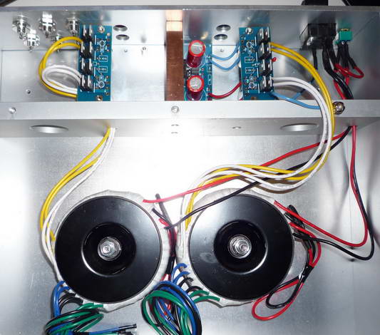

I would suggest rotating transformers to minimize wire lengths.
If you are adding source selector and potentiometer, please see this diagram: http://www.diyaudio.com/forums/showthread.php?postid=1516297#post1516297
The ground does not go through selector, but does through potentiometer: RCAs --> pot --> SG on amp board
I would suggest rotating the transformers to minimise hum and buzz injected into the amplifying circuits. Then cut the connecting cables to length.Peter Daniel said:I would suggest rotating transformers to minimize wire lengths.
Remember to twist the flow and return wire pairs. This applies to mains and LV power and audio cables.
If there is a third wire to a pair, (eg. +ve, -ve, Zero Volts) then all three need to be twisted together.
AndrewT said:I would suggest rotating the transformers to minimise hum and buzz injected into the amplifying circuits. Then cut the connecting cables to length.
You may try that too, but in my experience, in a chassis like that, the hum caused by transformers is not an issue.
Hi Peter,Peter Daniel said:You may try that too, but in my experience, in a chassis like that, the hum caused by transformers is not an issue.
you are probably right.
It is worth experimenting just in case the thick aluminium is fighting against a strong field pointing in the wrong direction.
