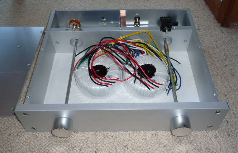

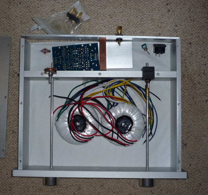

i am ready to build my first 3875 amp. i got the premium kit from you last week.

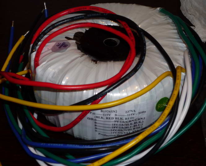

i have a question about transformer i bought locally.
237VA
input 115*2
output
1)24V---4A
2)24V---4A
3)18V---1A
4)18V---1A
5)9V---1A
i just use 24V*2,4A. is it ok.
should i ues the 4A fuse?

Just placed my order for the premium 3875 kit this week and am getting quite excited to start building. I have been hunting for a transformer and am having a hard time. I managed to find a ready wound transformer with these specs and am wondering it it would work.
"230VA Custom Toroidal Power Transformer. 3 Outputs: 12.0V; 24.00V x 2" Can I just use the two 24V rails?
I was hoping to get a 300VA with 22v rails. But this is apparently not all that simple. Or will take several weeks

Plitron lead time is approx 10 days. The problem though is their $250 minimum order.
If you use 24V rails only on the other transformer, it should work fine too.
