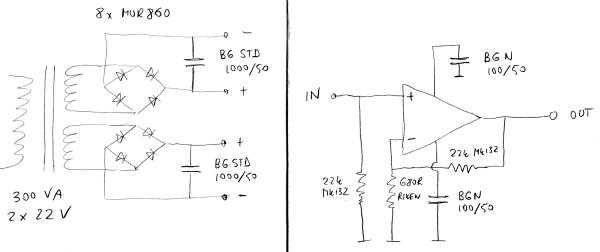

Which Schematic
Peter...
Which schematic are you using for the amp portion (LM3875)?
I have at least 6 versions... is it the "minimal" with only 4 resistors & no capacitors?
2nd question... How does one order the Black gate caps with the kit? It looks like even the premium kit does not include these?
3rd question... Can one use a CD player w/ volume control drive the Gainclone when not using a pot, IE using the CD player volume control?
Thanks in advance.
MDH
With kits I use schematic posted here: http://www.diyaudio.com/forums/showthread.php?postid=1508778#post1508778
The Integrated amp uses Premium kit components, including Panasonic FC caps, with exception of 220R Caddocks which are simply omitted.
With Patek, I'm using parts as in attachment.
I'm not selling Black Gates, as they are discontinued. AFAIK, BG STD 1000/50 are still available, BG N 100/50 not any more.
A volume control in CD player will work fine, although the sound quality may not be exactly the same as using quality pot directly at amp's input.

Capacitors ?
Peter...
Thank you for the information.
Two further questions... I'm ready to build using the Patec schematic.
1) Since the BG's are not available what brand / value are needed for the PS caps and the AMP caps?
2) If I use no pot, is a series resistor needed at the signal input? Say 200R.
