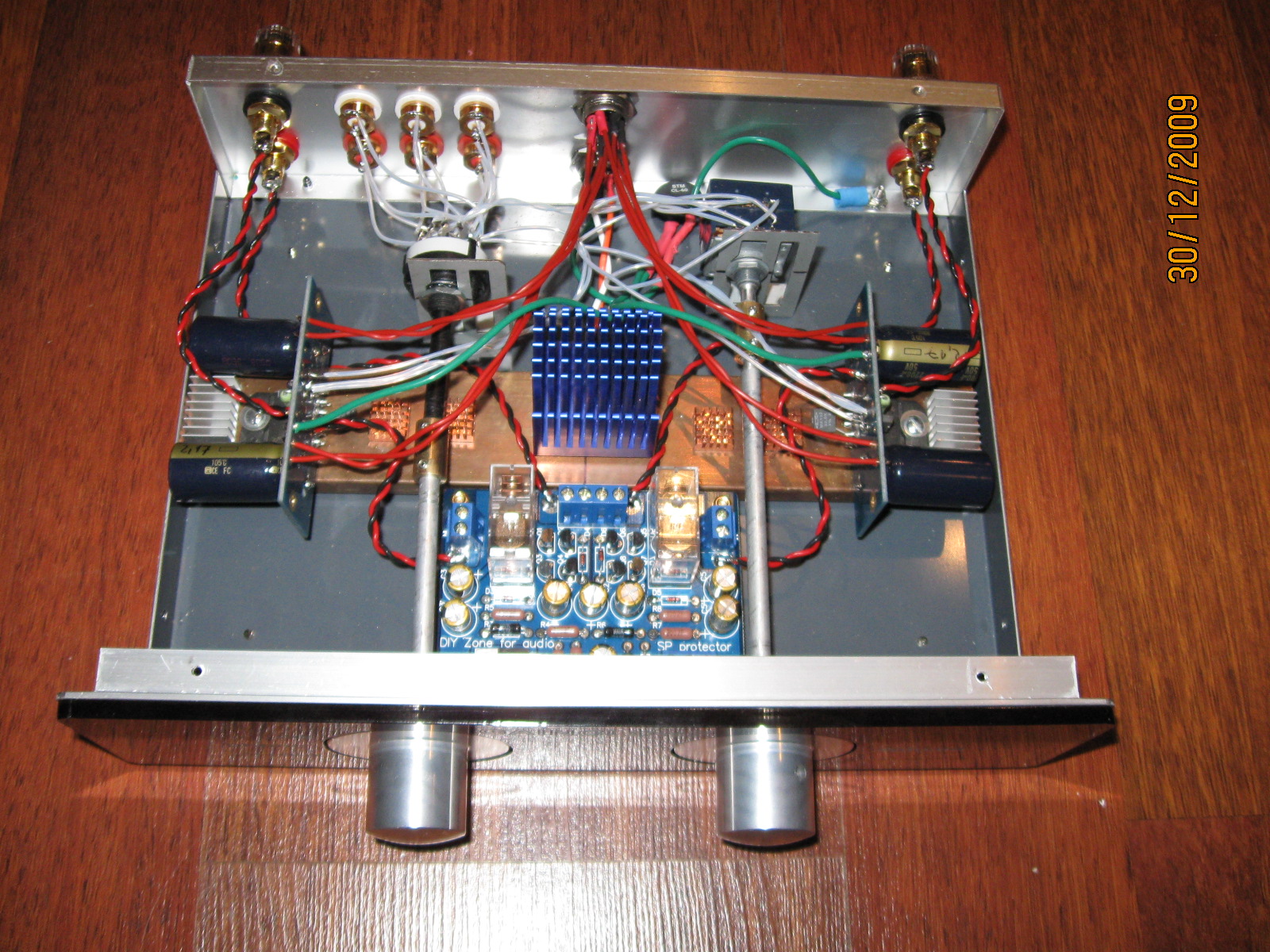

Can someone tell me why I can't reach fully output power/55W or so)? With cd player on I measured around 10V.I think that is 16W with 6ohm speaker.So I need to turn volume up to 50-60% to listen the music.
I'm using Peter's boards with recommended parts(22K,680R,220R,50K pot).
have you measured the voltage input yet?what voltage are you sending to the amplifier?
I tested with signal generator.1KHz and 400mV.Then measured with osciloscope.At ful pot opened it gives around 10V.
The amplifier gain is 33 so 400mV should give 13V output. Your readings are slightly low but around what is expected.

10Vac output from 400mVac input indicates a gain of 25times ~+28dB.
That seems to fit the normal gain from a chipamp.
If you want more output voltage you need to supply more input voltage.
I usually measure <2Vac at the output of my amplifiers, when playing music.
