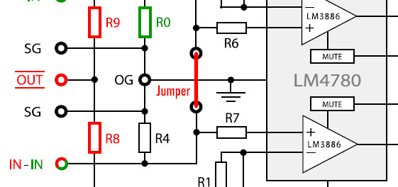

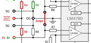

So, if I run it in stereo or parallel I can used unbalanced inputs? I know parallel is recommended for 4ohm speakers but can it be run this way with an 8ohm load? That was my only reason for using bridged mode is my speakers are 8ohms.
Yes, unblanaced signal is fine with stereo or parallel configuration. Also, 8hm load is perfectly fine here, as it's easier to drive.
Peter, thank you for your patience. Hopefully this will be my last question regarding this.
If running in parallel:
1) install jumper, R8, and R9
2)Regarding inputs. Being there is now a jumper, do I use just the Red IN and associated SG or do I split the positive side between both IN's and SG between both SG's?
3)Red OUT goes to + side of speaker and OG to - side of speaker?
When in parallel, install jumper, R8, R9, Do not install R0.
Use red IN and any of SG's (as they are connected anyway). For output, red OUT (//) and OG for output ground.
