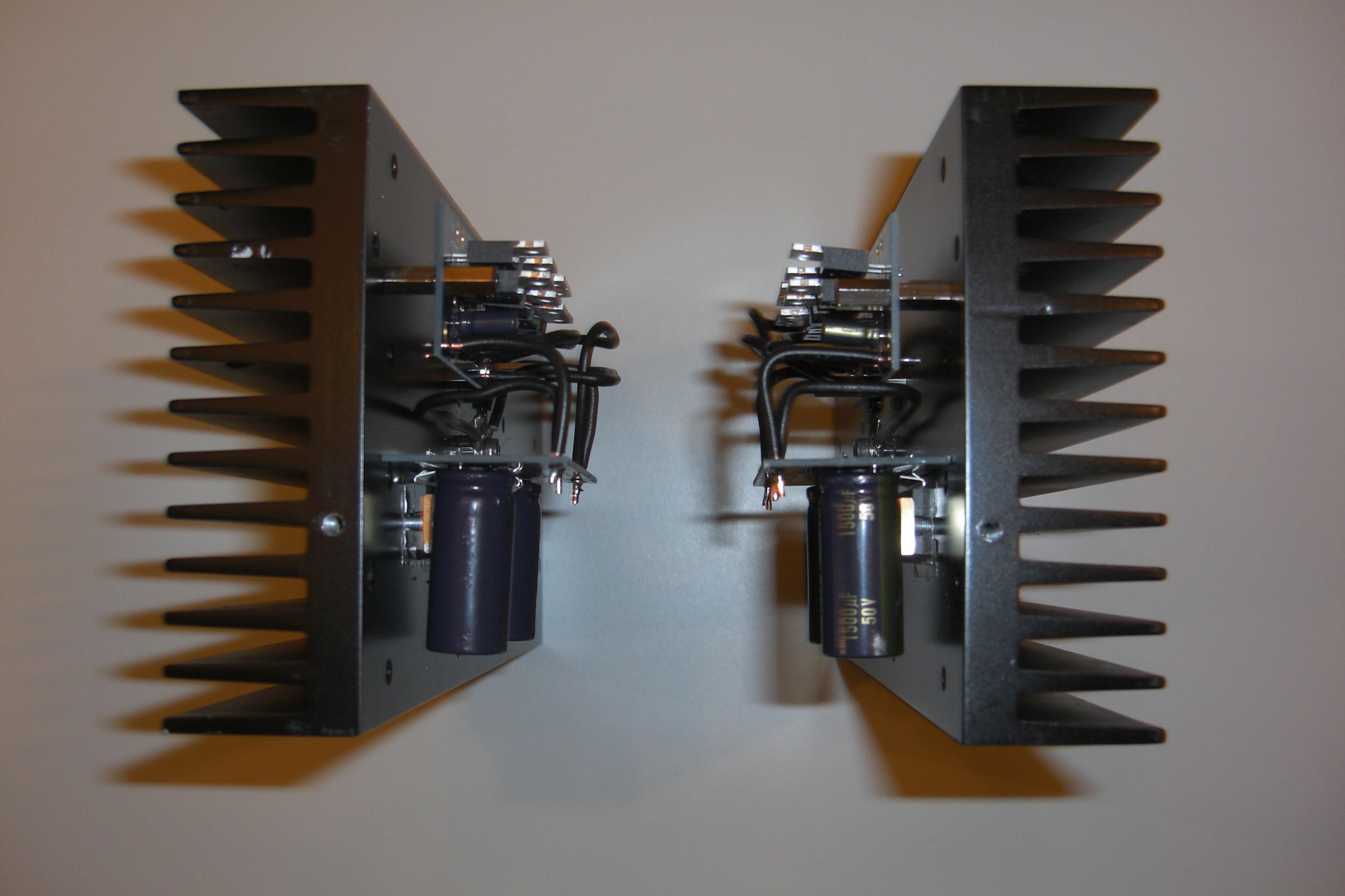

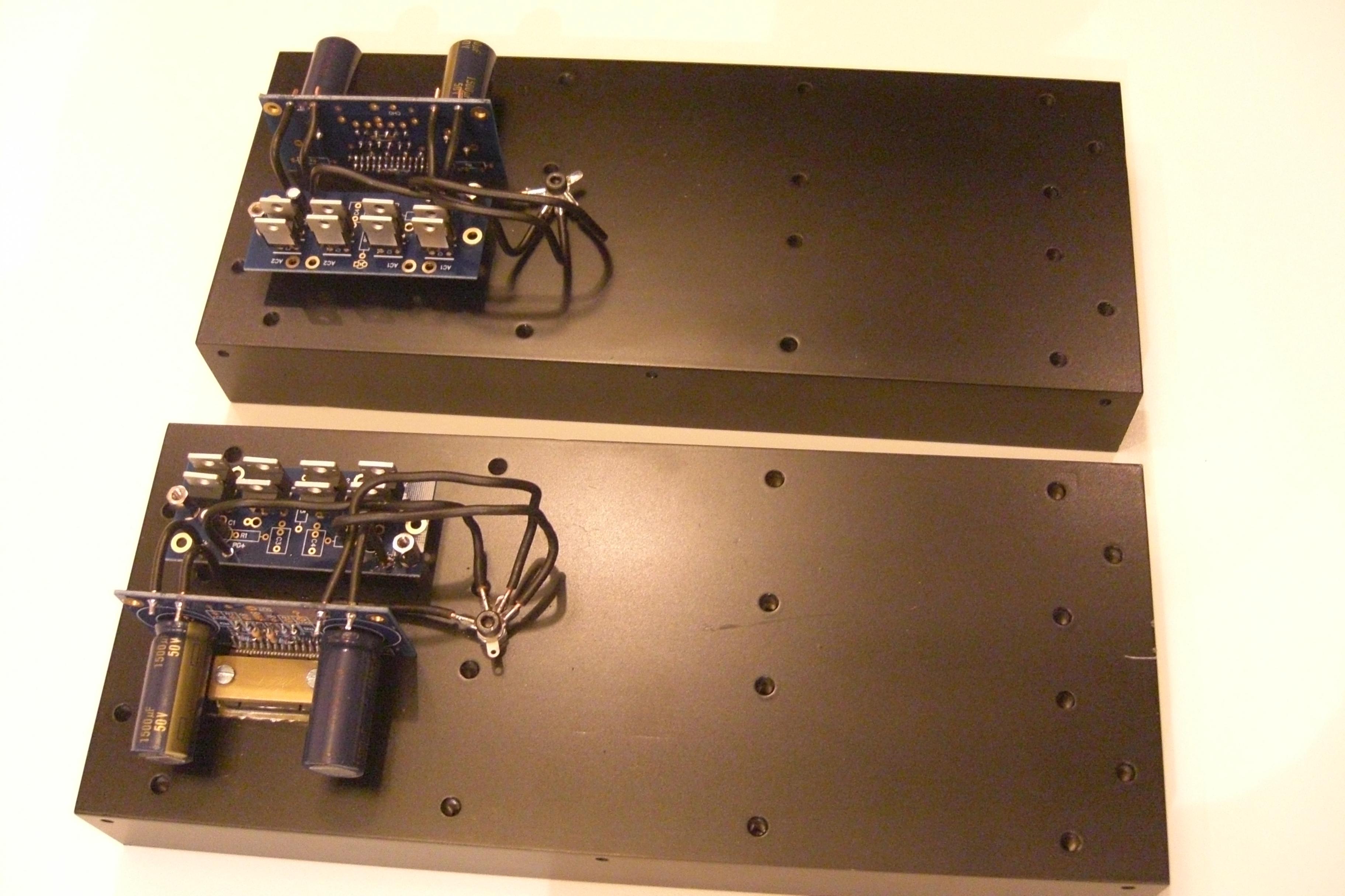

Attached you can see the progress of my gainclone with the LM4780 kits from Peter Daniel. The LM4780's will be bridged and are mounted on their heatsinks (left & right) with stips. Power supply star ground is on the heat sink.
The enclosure will be complete aluminium. The rest of the enclosure is being painted. But i did not find a solution yet for a nice front panel.
http://www.diyaudio.com/forums/attachment.php?attachmentid=162166&stc=1&d=1268338696
http://www.diyaudio.com/forums/attachment.php?attachmentid=162167&stc=1&d=1268338696
An identical second amp will be built. After that i will use them in an active setup.
