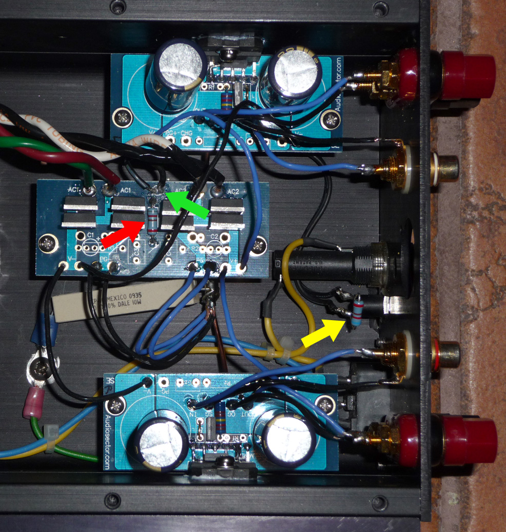

As discussed in earlier posts, I was looking to create a 12 volt trigger output from my GainClone to switch a subwoofer on and off. It's now up and running fine. Here's what I did:
The attached photo shows the inside of my amp. I made a voltage divider based on the portion of the rectifier board designed for an LED. The first resistor (R1 in voltage divider terminology) is mounted to the resistor space labeled R3 on the rectifier board (red arrow). The two wires to handle the trigger output are connected to the LED space (green arrow), with the positive lead in the hole with the square marking. Those wires connect to a 1/8 inch jack in the rear panel (yellow arrow). The second resistor in the voltage divider (R2) needs to connect across those two wires. Rather than mount R2 at the cramped rectifier board, I simply moved it to the other end of the two wires, at the jack.
On my board, I had 28 volts coming off the rectifier (powered by 21 volt transformer). I used the calculator at Voltage Divider Calculator, entering 28 for the "battery voltage", 0.020 (20mA) for the current, and 12 for Voltage Out. The calculator gave me back resistor values of 800 ohms for R1, and 600 ohms for R2. I actually used 820 and 620 ohm 1/2-watt resistors, and the circuit produces a measured voltage of 11.8, triggering my subwoofer very nicely.
Now for the tricky part. When I hooked up the amp in my system with the trigger connected to the subwoofer via a cable with 1/8-to-1/8 inch plugs, I got noticeable ground loop hum. The subwoofer and the GainClone are both connected to preamp ground through their interconnects. (The preamp has dual sets of outputs.) So I modified the trigger cable between the GainClone and subwoofer to disconnect its ground wire, and the trigger is now carrying only +12V. If I had known about the ground loop in advance, I could have wired up the voltage divider in the GC with only one wire, although in that configuration the R2 resistor (620 ohms) would have to go at the rectifier board, bridging the two LED holes. (The trigger output wire has to have the R2 resistor between it and ground.)
If anyone else wants to give it a go, just make sure to calculate the resistor values for your actual voltage on the rectifier board with the amplifier boards hooked up.

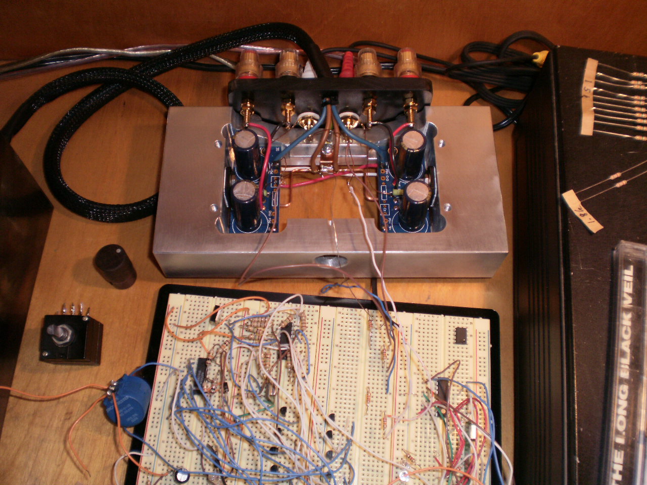

Here's my first effort at a gainclone amp. I managed to destroy the Noble pot by getting it too hot while soldering the wires too close to the body. Other than that the build went without a hitch, though way more time was spent machining than soldering.
For now, in place of the pot, I'm running with a few resistors on a bread-board borrowed from my son. I've got about a dozen hours on the amp now, i'm trying some higher volume levels tonight, and to my untrained ears, the sound is just wonderful.
The chassis is machined from a block of aluminium - plenty of mass, but not a lot of surface area for shedding heat. At the higher volumes, it does get a little warm. I'm wondering: What is a reasonable maximum temperatureand is there a significant risk of speaker damage with overheating?
