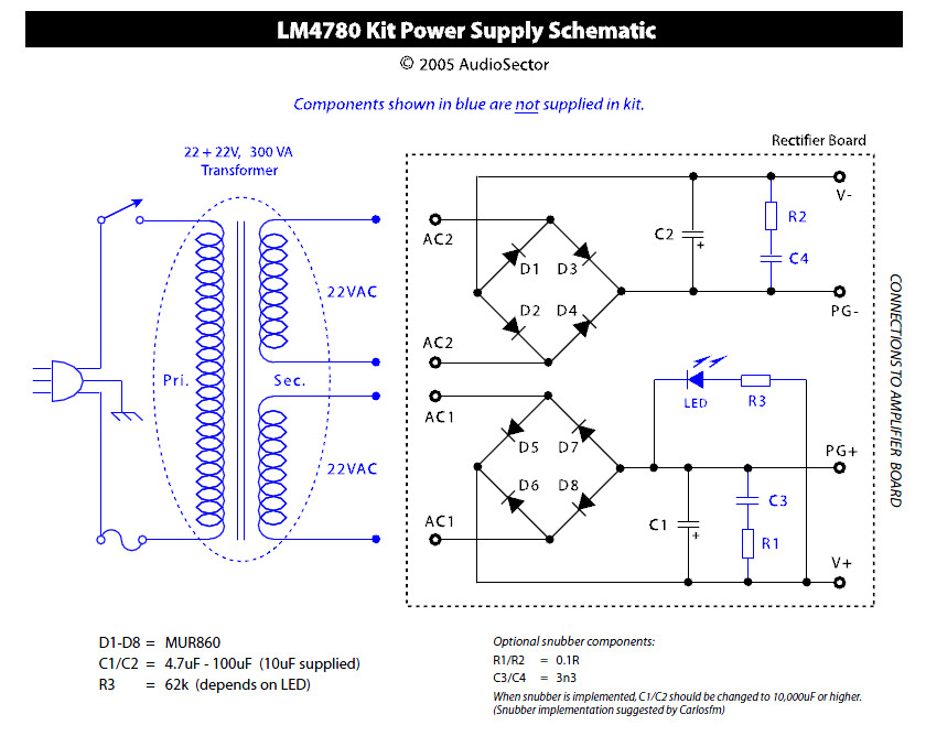

2. I'm interested in at least listening to the amp with a snubbed PS. I'm taking it that RZ and CZ on the amp board are the zobel. What are the correct values to use?
They also talk about an additional bypass C along with the series R-C snubber network. Where does this C mount and what is the correct value?
1. They perceive the coloration of resistor, if the circuit works you are not missing anything
2. Those additional parts have been specified in the schematic I include with LM4780 kit, this also applies to LM3875 kit. BTW, it has been posted on a first page of this thread.
Thanks Peter, I guess I missed that image.

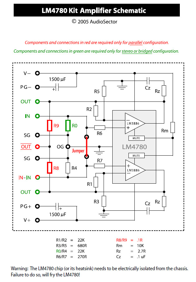

I think I've gotten myself confused over the snubber-zobel issue.
The Image you posted of the rectifier board and the extra series RC is how I understood the snubber network.
At some point I started thinking that RZ and CZ on the amp board were the series RC in the snubber.
Is the zobel on the amp board part of the snubber?
If it is, does it replace the series RC on the rectifier board or do I need both?
If it's not, what is it's purpose?
Sorry for all the beginner questions. Thanks, Scott
Zobel is separate circuit from a snubber.
You can read about Zobel here: IC Audio Power Amplifiers and Zobel Networks: One Size Does Not Fit All | Digital Home DesignLine
Snubber was introduced to chip amps by CarlosFM, in order to make large PS filter caps more "friendly"
I don't use any of them in my amps.

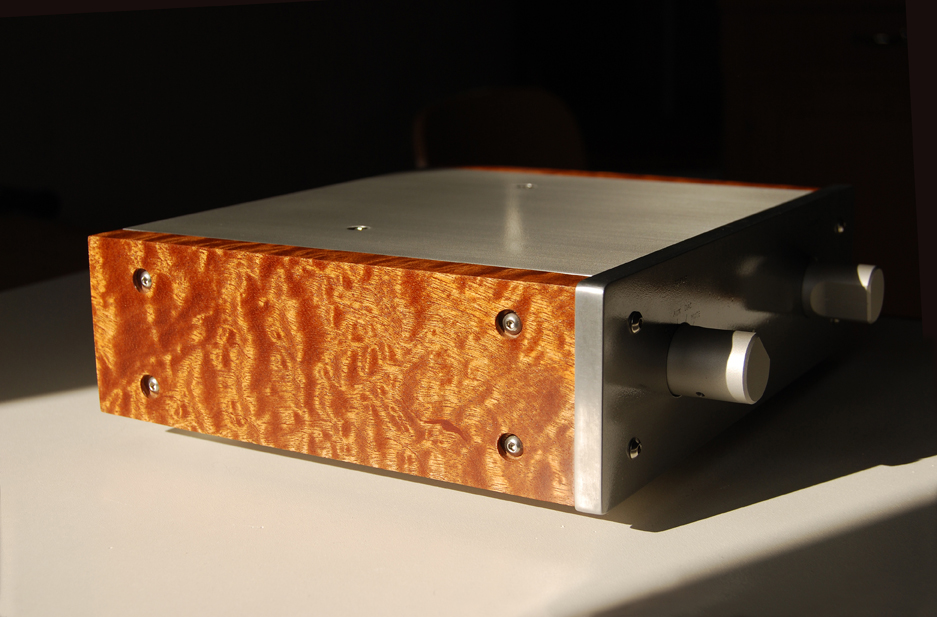

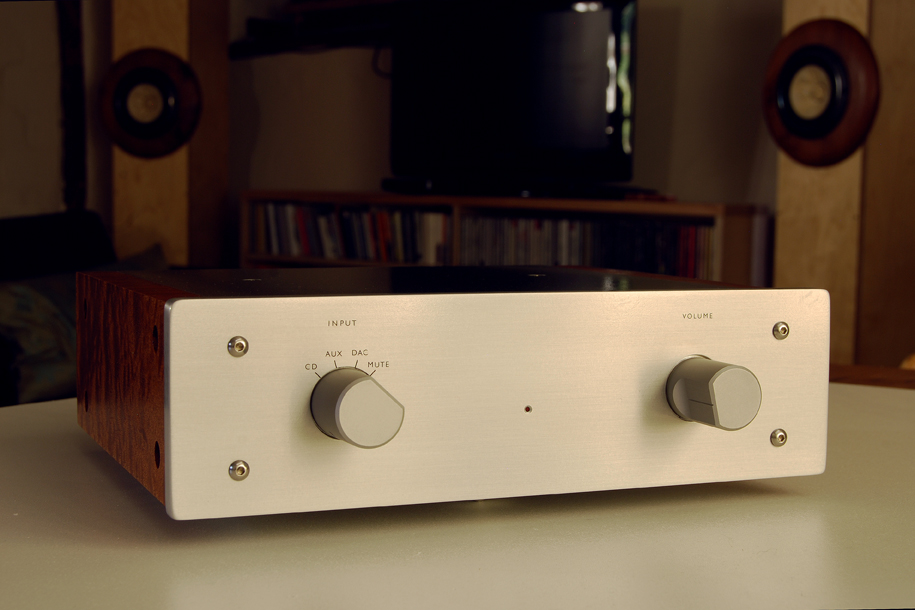

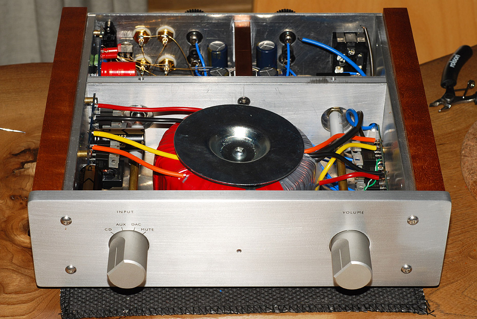

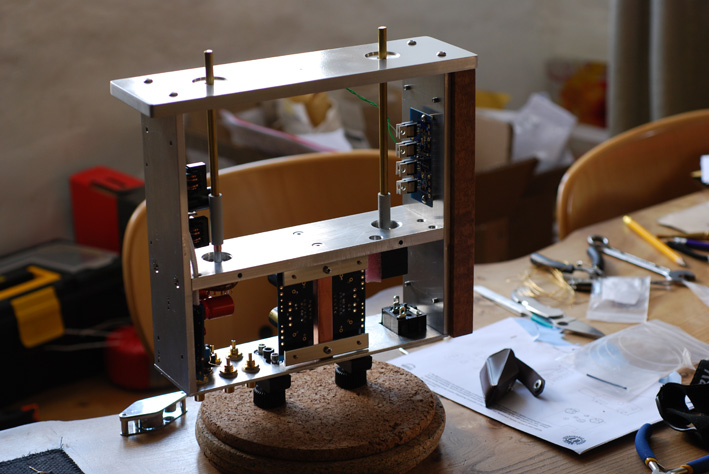

Pics of finished amp made using LM3875 premium kit (also build DAC into same chassis)
These things sound amazing. Breathtakingly good. No hyped detail just a rare mix of subtle delicacy and fast heavy punch. The DAC's bass weight through this amp is awesome. It registers as low as I can hear. I cannot imagine how things can be improved from here. Still, if it really can, I guess Peter is working on it
Thank you Peter for all your help

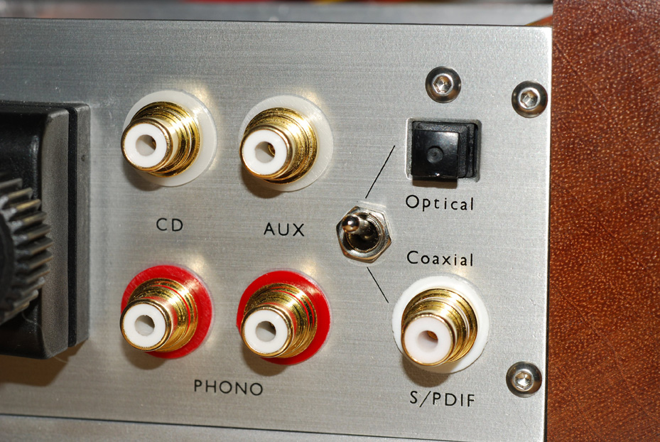

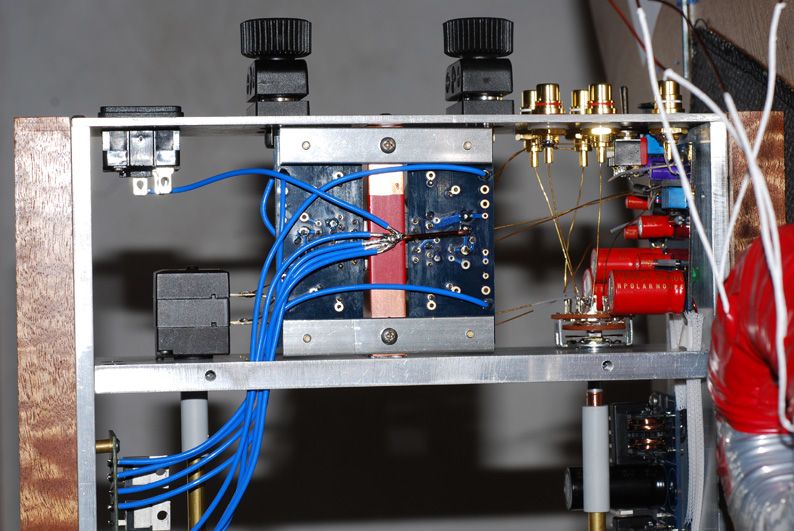

very nice indeed Martin any chance of some close ups inside
koogar
Rodmunch

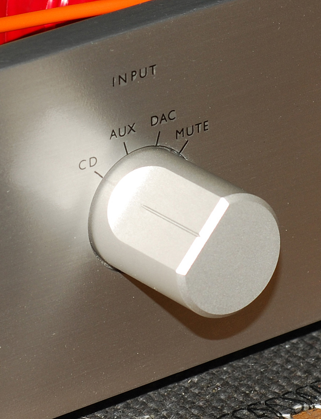

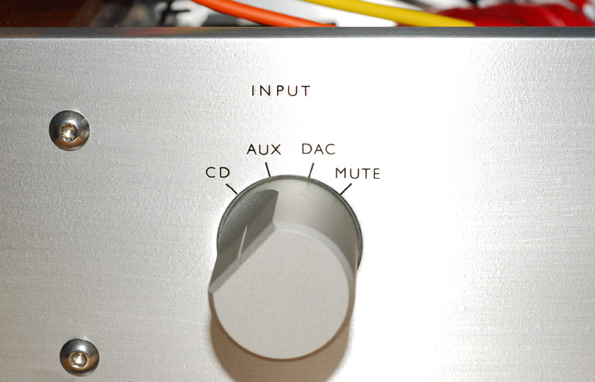

Lettering is wet slide transfers. I bought them here in the UK (normally supplied to the model railway folks). I couldn't source any Letraset with a font and size I wanted. These are 2mm.
A bit of a fiddle to apply. You need to have a gloss finish (no brushed bare metal) so I have to apply lacquer. Each letter has to be soaked in water and applied individually. Once dried you can apply the next one! I worked on bits of words all over the amp until the first one was dry. Then you need to apply lacquer after to protect.
Looks OK in most lighting conditions but under close examination you can still see the glue transfer sheet. (I am very particular so this bugs me...but hey, I listen in the dark most of the time!)
Rear took some time...
