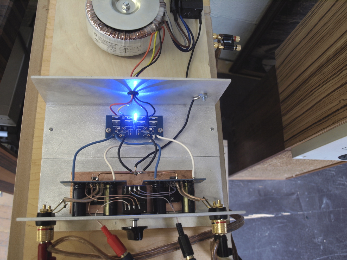

i just finished one of my gainclones using Peter Daniels kits. In total i will build two 2 channel amps, each having a bridged LM4780 per channel. I use balanced inputs.
So the first was finished this week, and i will post pictures later. After powering up, i measured the voltage over the loudspeaker outputs and had 0.02 Volts one one channel and 0.023 Volts on the other channel. Than i connected it to my speakers. Nu hum, noise or anything just quiet. Then i connected my preamp and cd-player, still quiet. Then the moment, press the play button, and then there was music. It has been playing now for some hours, and i am starting to like it more and more.
I found my Kenwood/Accuphase L-1000M power amp already very fast and detailed. But this is better. I cannot wait finishing the second amp and using my electronic crossover.

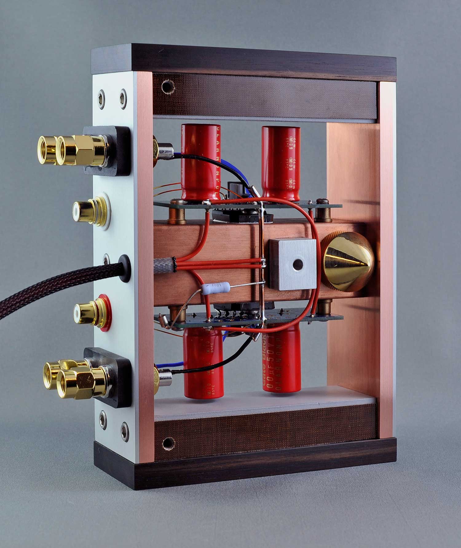

The important aspect about sharing a single transformer and common rectifiers per two amp channels is power star ground.
While you could simply run PG+ and PG- (ground) wires from rectifier board to each amp board, in some setups hum problems were reported and presently I always use star (power) ground in all my amps.
I simply achieve it by connecting output grounds (OG, on the opposite side of speaker wire connection) with a 14ga solid core copper wire.
The center of that wire is my power star ground and both PG+ and PG- grounds from rectifier board connect here. In the picture below the connections are so short that I used single runs of wire, normally I use two wires for both PG+ and PG-.
Please note that power ground is also directly connected to the chassis.
I specifically refer to it as power star ground, as signal wires from RCAs are not connect directly here. They connect through separate traces on PCB to OG (output ground) pads.
I solder the copper wire directly to output wires on the opposite side of the pads, it's very simple. With Patek, I do it as in attached pic.
