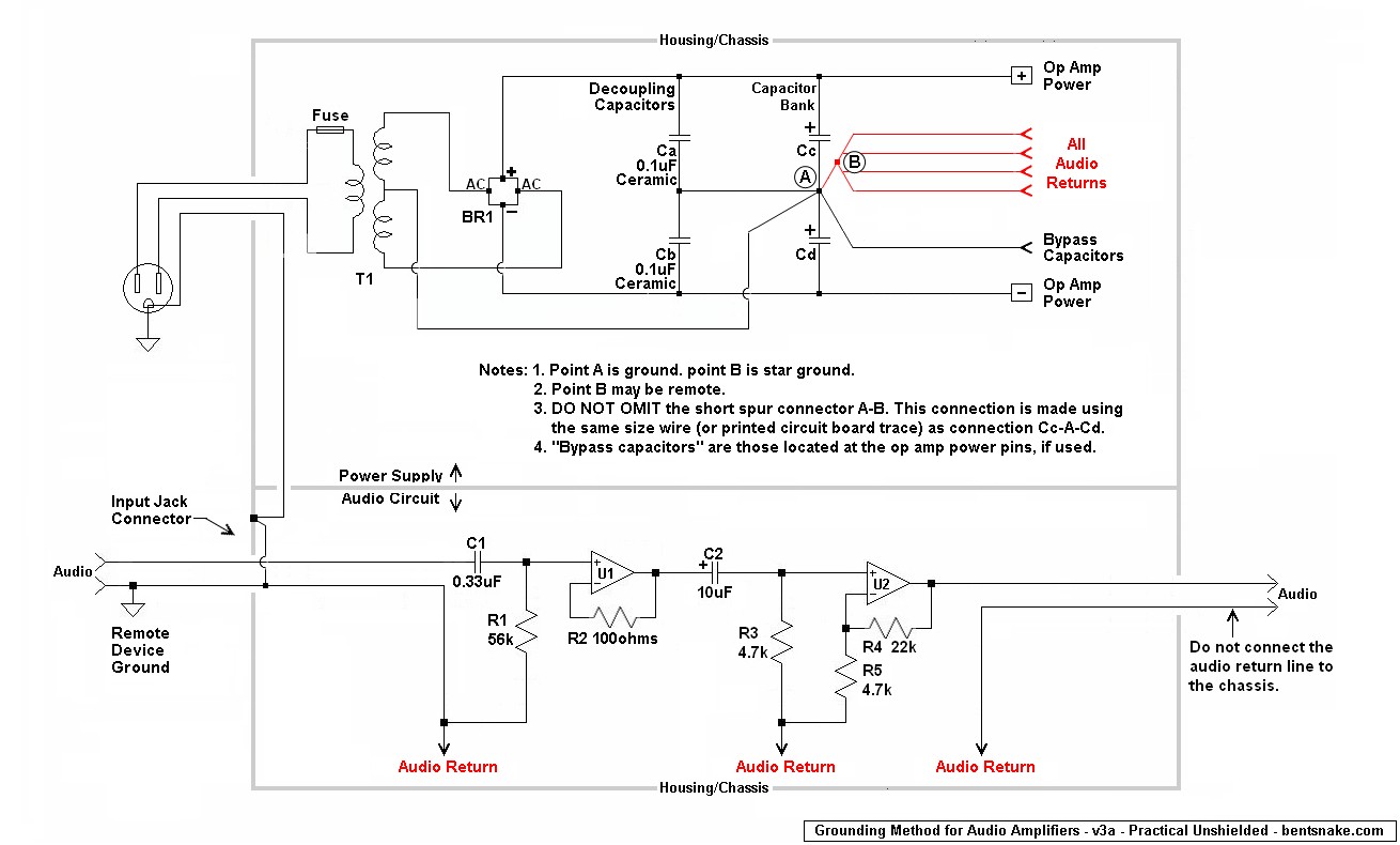

post34 tells you.Sort things out is exactly what I'm trying to do. But if you won't point out where on the posted schematic you see an error, then how do you think that could be possible?
I'm simply asking that you indicate where on the posted schematic any error might be. Everything is labeled, so simply indicate, that's all I'm asking.
post38 expands on that.
... At bottom I'm trying to come up with something that will answer the newbie's inevitable question, "How am I supposed to connect all these ground thingees together?" Come up with something simple enough to be usable...
I guess I belong to one of those newbie, was trying to build my first power amplifier couple of months ago, and here is my personal experience:
- When everything was ready and I needed to put them together in a chassis, like many newbie I searched in this forum on how to ground properly ...
- I found some posts by OP, advocating the scheme you're proposing in this thread. I found some posts by many others, recommending something very different ... as a newbie I was entirely confused.
- As the star ground concept seemed sexy, I tried using it - and there was a problem, it leaves many sections of wiring which are alone and cannot be twisted. I didn't feel comfortable with it so I switched to the other camp.
- I used the "minimizing the loop area" method then, wiring are mostly twisted and I felt more comfortable. The amp is dead quiet using this scheme.
In your scheme at post #67, for example, for the audio output, how can one twist the audio return line all the way to point B? The best I could do was to twist the wire with the audio signal back to the audio circuit PCB, and then the audio return line has to go to point B alone, untwisted.
Please forgive me if this is a stupid question from a newbie.

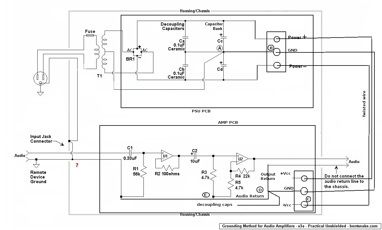

You came to the same conclusion as I did, one solution is to move point B to the output. This is also a good place to start your layout design.
The speaker current flows from the PSU through the amplifier.
The speaker return current has to follow the same route back to it's source.
So we could place local GND (B) near to the output of the opamp, run a clean GND and +/- rails from the PSU to the opamp. Or even better as suggested by Bonsai in post 45: +/GND GND/- from two PSU to the opamp.
This is also starting to look a lot like the advice given by TI in their LM datasheets.
Which post shows the sch you are referring to?So we could place local GND (B) near to the output of the opamp, run a clean GND and +/- rails from the PSU to the opamp. Or even better as suggested by Bonsai in post 45: +/GND GND/- from two PSU to the opamp.
No schematic yet, just thinking out loud, trying to translate the rules into a layout, working backwards from output to chip to PSU.
The closest so far would be the one at post#2

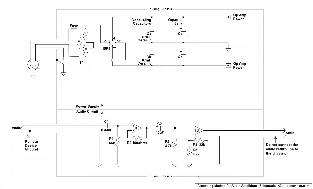

You might notice that I keep asking people to indicate where on the posted schematic they see a problem with loop area, or with twisted pairs.
Of course that can't be done because schematics don't show loop area, or twisted pairs. Those are real-world wiring, which is dealt with in printed circuit board layouts, or in circuit notes. Nothing to do with schematics at all.
So the ruckus is people avoiding saying "it's nothing to do with the schematic, it's just an idea I had." Which might be very good ideas, but they're ideas that have nothing to do with the business at hand.
Neither do "ground lift" schemes of various names. In my opinion all such schemes are: a) Sloppy workarounds. b) Dangerous. c) Quite possibly illegal. But whatever else they may or may not be, they're not something that relates to the business at hand.
There is, in fact, business at hand. My job now is to reconcile theory with real-world reports of problems, and posted questions. I wonder if I'll be able to do this? The excitement builds.

post2 has no "B" shown.So we could place local GND (B) near to the output of the opamp, run a clean GND and +/- rails from the PSU to the opamp. Or even better as suggested by Bonsai in post 45: +/GND GND/- from two PSU to the opamp.
What is of concern is that people are trying to build these Bentsnake schematics. They are posted as the best layout possible.
Indeed the excitement builds.
That is precisely the problem
Bentsnake has posted dozens of these incorrect and/or misleading schematics in various Threads, many intended for Beginners who know no better than Bentsnake.
Bentsnake has continued to post these erroneous schematics after being informed that they are misleading !
Part of the "problem" is that Bentsnake cannot see that labeling everything as GND is the single most confusing item on this Forum.
Not mine. What, I'm making this stuff up? Not.

Meanwhile, it might be helpful to post a slightly updated version. Not actually for itself, but for the purely schematic version, which is also posted.
The two circuits are electrically the same, so maybe having them side by side will be convenient for comparison.
