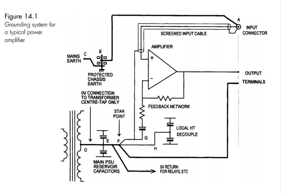

The first safety requirement for ClassI equipment is that the Chassis MUST be directly connected to the Protective Earth wire in the mains cable.
There are other requirements, but that is the major one and it affects the comments being made in the last few posts.

"The metal parts of Class 1 equipment could assume a hazardous voltage if the basic insulation fails, so there is a requirement that the metal parts are earthed via the protective conductor."
How do you earth the amplifier outputs? Speaker connections are often exposed metal parts.
Disconnecting Network between exposed conductive parts and the Safety Earth.
All exposed conductive parts must be connected to the protected chassis.
These parts if they become "Live" would conduct the Fault Current to the protected chassis via the "connection" from Main Audio Ground (MAG) to Chassis or via another specific route installed by the Builder. eg a wire from the metal case of an adjustment pot direct to chassis.

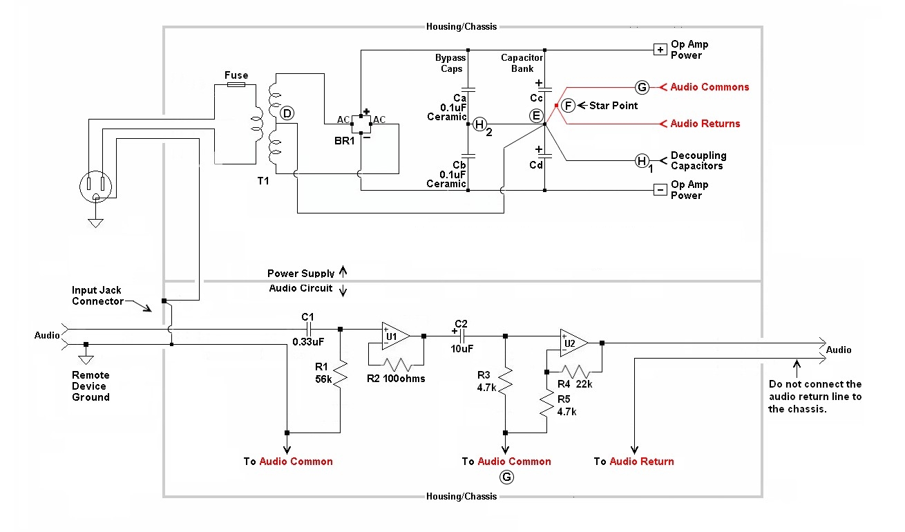

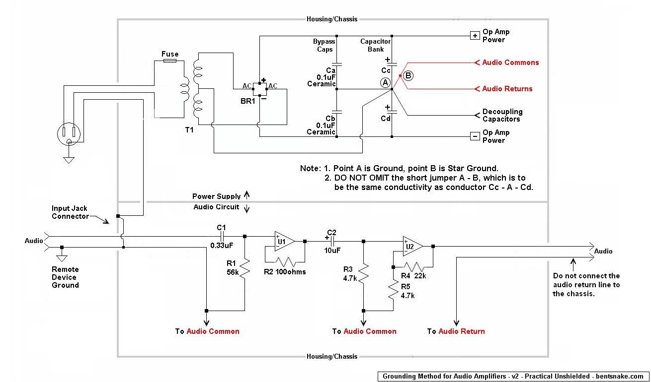

Some amplifiers, particularly multi-channel amplifiers, perform better if the MAG is not "wired" to Chassis. But MAG MUST still be connected to pass Fault Current to PE if any exposed part is indirectly connected to some exposed conductive part.
To enable that Fault Current to pass without a DIRECT wire connection, many suggest a power diode/rectifier as a route that passes the current and inserts an impedance between Chassis and MAG.
esp discusses this at length. He appears to have followed the extensive discussions on this Forum and then formulated a very informative article showing OUR conclusions.
I have called this circuit a Disconnecting Network.
Because it effectively disconnects the Audio side from the Safety side.
But very importantly allows Fault Current to pass to comply with "All exposed conductive parts must be connected to Chassis".
If one passes 25A through a DN, then the voltage drops will be the sum of wire resistances times test current + leadout/connector resistances times test current + Vf of the power diodes.
I use two parallel connected 25A or 35A diodes inside a bridge rectifier. (esp recommends the same parallel arrangement)
The Vf of these will be around 1V to 2V when passing that 25A.
If all the other resistances add up to 0r05, then the total voltage drop will be around 2.25V to 3.25V
This is well below the 12V quoted by Udok.
It is also well below the limiting value in the UK regulations (even though I can't remember the clauses).

I tested my version of the DN.
All the components (rectifier, 100nF MKT & 10r 600mW metal film) survived the Fault Current (presumed to be >>>100Apk) undamaged for the time it took to rupture the Mains Fuse.

Yoo hoo. Anybody remember me? The poor sap who asked a question, not understanding that you need an MS in vibration mechanics before you're allowed to build a chip amp? Not that I shouldn't have known in advance. After all, a chip amp is liable to have as many as four components. Six if you count the input circuit.
Willy-nilly, I thought I'd jump back in with the latest, and also with many thanks to 00940 for helping me finally see through what previously was a blind spot.
Posted is the current state of the art...so to speak. A bit anticlimactic in its simplicity.

All of which stands well to reason until you look at figure 14.1 (also posted), in which he cheerily returns the "local HT decouple" capacitors (H) to Star Point F.
I don't know whether Mr. Self means these HT capacitors are "local" to the power supply, or "local" to the op amp(s), and I find no clarification in the text. So I've taken the position that decoupling (or bypass) capacitors have no business being connected into the audio circuit in any case, and routed them to my point A, ground, which is Mr. Self's point E, his Reservoir Ground.
Right? Wrong? Research continues, while as before correction is implored.

Compare D.Self to your diagram.
look very carefully at the routes D E F G and D E F H
D is the link CT to PSU Zero Volts. This MUST be a direct link. It MUST NOT be taken on a long looping journey around the amplifier.
This DE link MUST be close coupled to BOTH AC secondary wires from the transformer to the smoothing capacitors, even as it passes through the bridge rectifier.
re-post with that bit corrected and Someone will give you the next bit to remove your errors.
The DE link doesn't pass through the bridge rectifier. Hoping for clarification, I've re-labeled my schematic below with Mr. Self's reference points.
YOU must route the DE link across the rectifier to minimise the LOOP AREA of the CT current and the secondary currents passing through the rectifier.
The closer the DE link to the rectifier diodes the smaller the Loop Area.
I see you have relabeled your diagram.
Make the CT connection to H, DE link is now DH link
Could you use a different colour for the DH link. That way it can pass straight across and we can see there are no electrical connections to the rectifier.

Only for explanatory purposes:
So you're defining the audio input as point A? A bit confusing since on my schematic point A is ground, but let's go with A = audio input, why not.
And you're defining G as circuit ground? OK. Or it's OK unless you mean the G on Mr. Self's schematic, but you don't say so I don't know.
Point "output terminal" is the audio output terminal? Power supply output terminal? I have no idea what you mean by "output terminal reference point." There is no such point on either posted schematic.
In any case, "...if the local rail decouple current flows through point G, this is bad..."
So this local (to what?) rail decouple current is not to be directed to ground, which is your point G? Then where?
And, "...the output voltage depends on the current through the decouple caps."
If you mean the power supply output voltage, then that's the output voltage of the bridge rectifier, it has nothing to do with any capacitors anywhere.
If you mean the audio output voltage, then of course no it doesn't.
Sorry, I simply have no idea what you're talking about.
If you're actually talking about either or both of the posted schematics, it would probably make things clearer if you referred to those.
I assume he is referring to Fig 14.1 in post 37. Point A is the ground reference for the input. Point G is the ground reference for the feedback network. These two points need to be at the same potential, otherwise the feedback network is not just sensing the difference between input and output (as it should) but also the difference between A and G. By 'output voltage' I assume he means the signal output voltage from the power amp, which will be affected by decoupling ground currents if these are allowed to pollute point G.
The point he is making is that every connection has impedance, so if you want two different points to have the same potential then you have to ensure that no current flows along the path between them.
