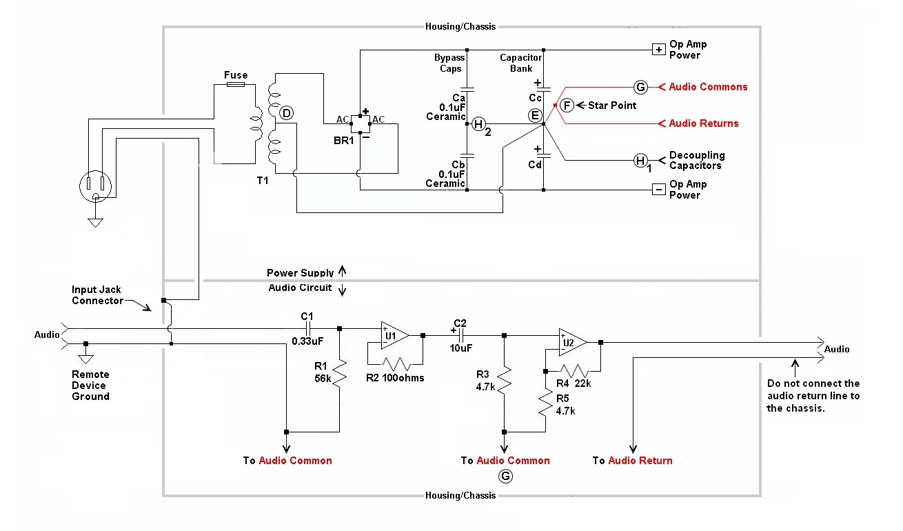

YOU must route the DE link across the rectifier to minimise the LOOP AREA of the CT current and the secondary currents passing through the rectifier.
The closer the DE link to the rectifier diodes the smaller the Loop Area.
I see you have relabeled your diagram.
Make the CT connection to H, DE link is now DH link
Could you use a different colour for the DH link. That way it can pass straight across and we can see there are no electrical connections to the rectifier.

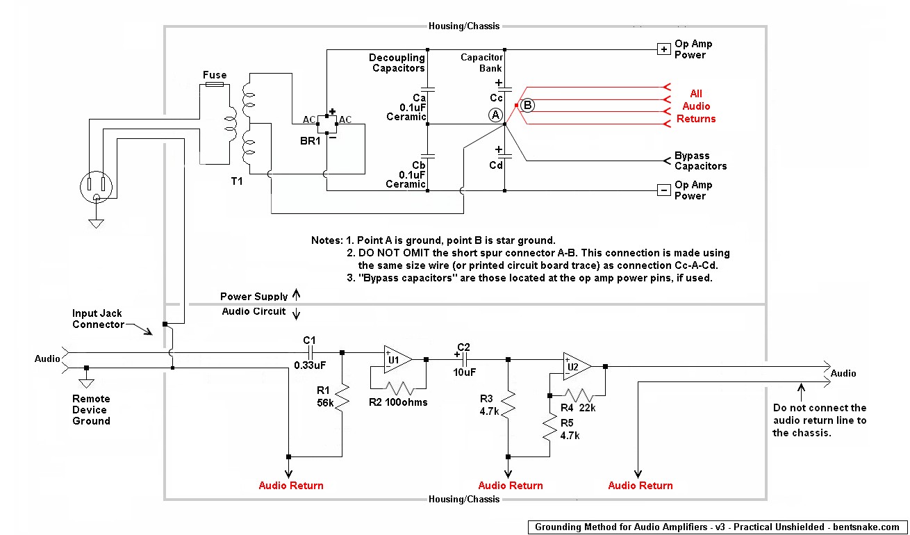

For clarity, I'm yet again posting my re-labeled schematic. This is the only schematic I'm referring to in this post.
If I at all understand what you're saying, which I might not, you want to run a wire from point D (the center tap of the transformer), up over BR1, and down to point E? I have to disagree, I can see no possible point in doing that.
Are you, perhaps, concerned about the physical length of conductor D-E? Not to worry, in the real world this conductor is quite short, schematics are not drawn to scale.
Additionally, if I understand, you advise that circuit ground be the junction between Ca and Cb?
Again I have to disagree. Typically Ca and Cb are very small ceramic capacitors, often soldered directly to the terminals of Cc and Cd. In my view not at all a wise choice for the ground point.
Then again, if Ca/Cb are, in fact, soldered to the terminals of Cc/Cd, then point E and the Ca-Cb junction are the same point, so it's a non-issue.

What will happen in your proposal if there is a differential between the earths of of the device shown, and the source?
Self's scheme BTW is not without its problems, and assumes all equipment is well earthed (as it should be) but does not deal with what happens if earth loop currents flow on the return screen of the interconnects.
- follow the advice and minimize loop area wherever possible.
-'T' off to avoid injecting common impedance coupled charging current I*R drops into the amplifer circuitry
- if you can, recitify and smooth the secondaries independently and then combine them (costs an additional rectifier)
- a ground lifter can work wonders - especially where there may be ground differentials between equipment
- use a low value (15~22 Ohms) decoupling resistor in the signal ground of the input of the amplifer. This forces any ground circulating currents to flow through the chassis earth connections and not the interconnect cables (the potenial problem with Self's implementation)
- for RF, dont forget to couple the incoming ground at the connector to the chassis directly with a 1nF ceramic cap - works wonders
- a snubber across each secondary (1K and 1nF) will also reduce diode switching noise - a problem in some arrangements.

<< What will happen in your proposal if there is a differential between the earths of of the device shown, and the source? >>
The same thing that happens with any proposal. The short A-B spur is the significant difference in this circuit, can you see it causing grounding problems?
<< follow the advice and minimize loop area wherever possible >>
Would that one could. But so far only the vague "minimize loop area" admonition has been offered. No specific problem has been pointed out, and no specific solution has been offered. If you can see a problem, will you please clarify?

It is not that vague. The problem is magnetic induction, which is proportional to loop area at both ends. The charging loop (from secondary, via rectifiers, to reservoir caps) carries sharp pulses, so you don't want that inducing voltages into signal loops. Keeping loops small, and well apart, reduces this problem.bentsnake said:But so far only the vague "minimize loop area" admonition has been offered. No specific problem has been pointed out, and no specific solution has been offered. If you can see a problem, will you please clarify?
post44 is yet another misleading diagram that many here keep telling you is wrong.
"Many" seems to be pretty much you. Again I ask: will you please identify the specific problem you're referring to? And can you offer a solution?
Yes, I'm afraid it is vague, in that advice to "minimize loop area" applies to every circuit in the world.
If there's any specific problem having to do with the posted circuit--the one supposedly under discussion--I sure would like to hear what it is.

I described how to route the transformer CT to smoothing cap wire.
you rejected that so I answered withlook very carefully at the routes D E F G and D E F H
D is the link CT to PSU Zero Volts. This MUST be a direct link. It MUST NOT be taken on a long looping journey around the amplifier.
This DE link MUST be close coupled to BOTH AC secondary wires from the transformer to the smoothing capacitors, even as it passes through the bridge rectifier.

I am unclear what you are asking for, which has not already been provided. We have said that loop areas need to be minimised. We have said why (magnetic induction). We have given an example of a particularly important loop (the charging pulse loop) which appears in your circuit and said how to optimise it. As far as I can see, we have pointed out a problem and offered a solution. These comments relate to the circuit you posted. Could you be less vague about what it is you feel we have not delivered?bentsnake said:The precision I ask is that you relate your comments in some way to the posted circuit. Hopefully pointing out a problem, and ideally offering a solution. If so inclined, would you please do this?
<< We have said that loop areas need to be minimised. >>
I think there must be agreement here. But could you please point out where in the posted circuit a loop area problem occurs?
<< We have given an example of a particularly important loop (the charging pulse loop) which appears in your circuit and said how to optimise it. >>
Optimization is desireable, of course, but not the present issue. The present issue is problems/not, that is, will it work in the first place?
After all, there's no use trying to optimize something that doesn't work. So again, could you please point out the problem with, in this instance, the charging pulse loop in the posted circuit?

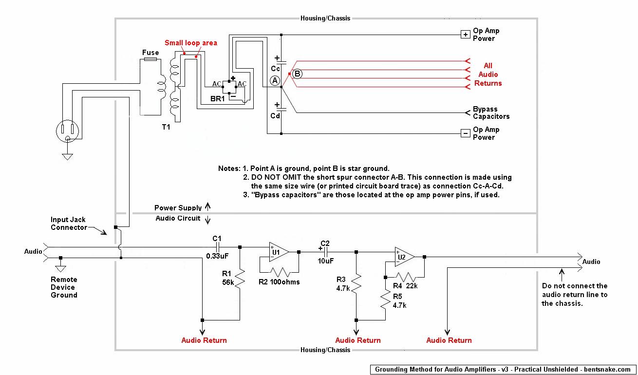

They mean this. I had to draw over some of your capacitors to make it obvious, but you get the idea; the wires which carry ripple current should be bundled together to minimise the area of the charging loop. Also, try to keep the transformer, rectifier and reservoir caps in close proximity, as this also keeps the loop as small as possible:<< We have said that loop areas need to be minimised. >>
