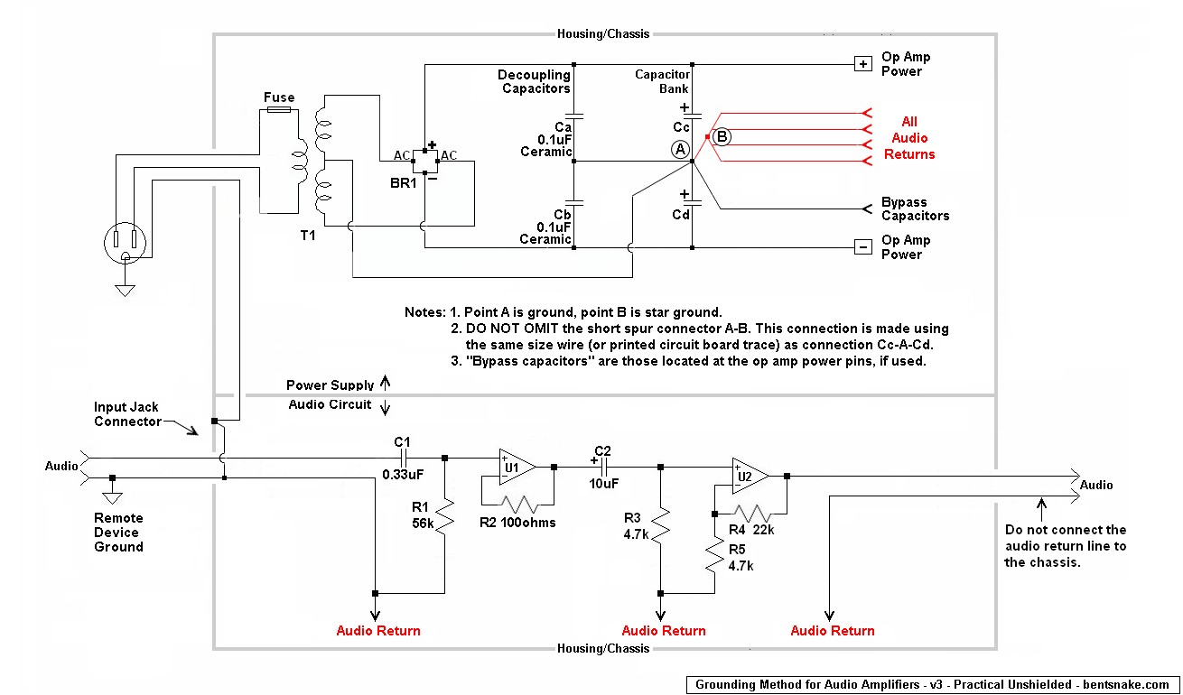

Now if you'll please point out how it relates to some problem you see in the circuit I posted, I'll be grateful.

They mean this. I had to draw over some of your capacitors to make it obvious, but you get the idea; the wires which carry ripple current should be bundled together to minimise the area of the charging loop. Also, try to keep the transformer, rectifier and reservoir caps in close proximity, as this also keeps the loop as small as possible:
Thanks for your post, Mrelinb, yes I do get the idea.
Even if the idea does seem a bit off kilter. If you're right, as I believe you are, then all of this fracas has basically been over twisted pairs. Or that is to say, good wiring practice, or in the case of printed circuit boards good layout.

Meanwhile, a revision. As always I hope for corrections. But I think the subject of twisted pairs has been pretty well covered.

Will you please say what would be a better scheme?

Sorry, I just can't see the "ground differentials between equipment" that you refer to. Would you please clarify by pointing out the problem in the posted circuit, and how it's corrected in the circuit you linked to?

To put it in perspective, its quite easy to end up with mA of ground loop current in an interconnect shield - you will get hum from that.
Rule 1 is twist the 'to' and 'from' wires tightly together (see the 'colorful' drawings in my link)
Rule 2 - make sure ground loops cannot form. In your diagram, you connect the incoming ground to the chassis, and then connect the output retrun to the star ground and then also have the main earth connection going to the chassis.
You are going to have loop currents all over the place with that, and every chance that they will flow in the interconnect return (usually the shield).
Use a ground lifter between the chassis and the star ground (see slide #2 on my articale on how to do this safely) and use a 15~22 ohm 'decoupling' resistor in the between the input ground on the amplifer board and the ground return. This works exceedingly well because the usual ground resistances are a fews 10's to 100s of mOhms. So with the resistor in place, the ground currents will prefer to flow in the equipment earth connections and not along your shield.

Will you please indicate where on the posted schematic you see a problem?

Sort things out is exactly what I'm trying to do. But if you won't point out where on the posted schematic you see an error, then how do you think that could be possible?
I'm simply asking that you indicate where on the posted schematic any error might be. Everything is labeled, so simply indicate, that's all I'm asking.
...In your diagram, you connect the incoming ground to the chassis, and then connect the output retrun to the star ground and then also have the main earth connection going to the chassis.
You are going to have loop currents all over the place with that, and every chance that they will flow in the interconnect return (usually the shield)...
Thanks for this post, it seems we're making progress at last.
But no, the "main earth ground" (point A) does not connect to the chassis. Or not directly, which is what you seem to mean. So taking this into account can you please re-state to clarify?
Or else, if I'm not getting your meaning, will you say how the connections you speak of should be made?

Excellent questions. I've asked them myself. No kidding.
This is a building project, not something I claim is "right." At bottom I'm trying to come up with something that will answer the newbie's inevitable question, "How am I supposed to connect all these ground thingees together?" Come up with something simple enough to be usable, I should say.
Bearing that in mind, my best information at this time is:
<< The usual 10/22 uf charging cap for opamp and 0.1uf decoupling cap to be treated same, combine their ground and return a single line?...all decoupling caps (for both the rails for multiple opamps?) can be wired together and brought as a single line to the grounding point? >>
The ideal would be to run all decoupling cap lines individually. But with several op amps in a circuit this can get ridiculously complicated, so my thinking is run them to a bus reserved for decoupling caps.
<< I guess its a good idea not to merge signal ground with the decoupling ground before bringing to the star ground. Run a separate line to star from audio ground on the amp pcb to the star ground on the psu pcb? I assume the star ground point is the 0V output at the psu pcb. >>
If I understand your question, star ground (point B) might be 1/4" away from circuit ground (point B) or several inches. Or several feet for that matter.
Run all the audio returns to a point that you define as star ground. This point is probably on the amp (not power supply) board. Then run a single conductor from there to circuit ground, which is on the power supply board.
One star ground and one only, there can't be one for the audio circuit, and another for the power supply. Nor would there be, since the star point is for audio only.
<< About twisted wires, for trafo to psu pcb, twist all three together? from psu pcb to amp pcb, twist all three together? >>
The custom I'm aware of is to twist all 3 together. I have suspicions about the math of this, but everybody seems to do it and it probably doesn't hurt anything.
<< Audio return from amp pcb to psu pcb goes solo? >>
Goes to the single star ground, which as above is probably on the amp board.
<< why connect input ground to chassis >>
The best question of all, and one I've wrestled with. Quoting from Douglas Self's "Audio Power Amplifier Design Handbook," page 402:
"Mains/chassis ground will need to be connected to the power amplifier at some point. Do not do this at the transformer centre-tap as this is spaced away from the input ground voltage by the return charging pulses, and will create severe groundloop hum when the input ground is connected to mains ground through another piece of equipment.
"Connecting mains ground to starpoint is better, as the charging pulses are excluded, but the track resistance between input ground and star will carry any ground-loop currents and induce a buzz.
"Connecting mains ground to the input ground gives maximal immunity against groundloops."
So the why is 'cause he says so.
If you have other ideas about any of this, or see an error I've made, I'd like very much to hear about it. Don't judge by this dialog of the moment, I'm just trying to get these guys to be specific. In the context of this thread, finding out I'm wrong is what I'm all about.
