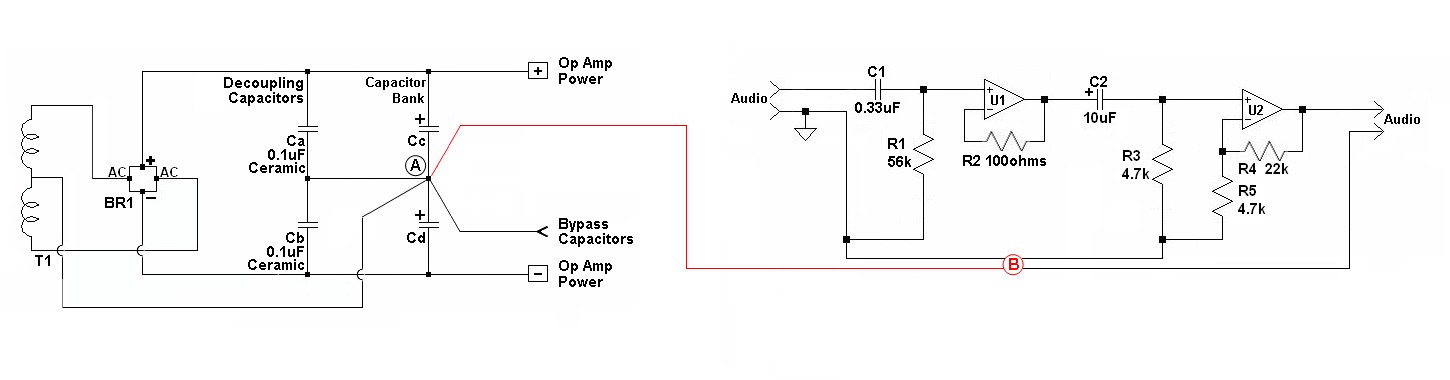

If separate amp and PSU boards are used, then point B would probably be on the amp board, not on the PSU board. So I'm thinking doors66 has a logical approach.
Also thinking that conductor A-B is an audio line, so possibly a shielded conductor. Except I have no idea how to connect the shield.

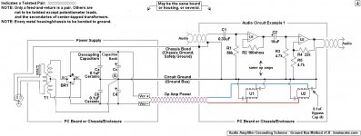

Those new block showing power/gnd/-power are basically connectors on the pcb. So point B is the gnd connection point on the power connector (or a solder pad) on the psu pcb. The other connector showing vcc/gnd/-vcc is on the amp pcb. So A-B is a trace on power pcb..
Yes, I see that you've moved connectors from one board to the other. Logical way to go.
However, I wonder about twisting the triplet Vcc/gnd/Vee. I don't mean I disagree with it, I just wonder about it. Even after filtering the Vee/Vcc lines are not perfect DC, so...well, so I wonder.

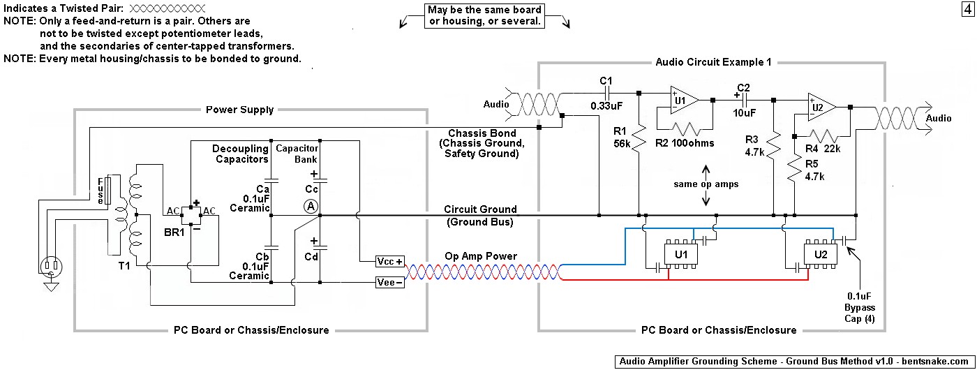

The pic below is actually basically the same as yours, just laid out horizontally. Sometimes moving the blocks around makes something show up.

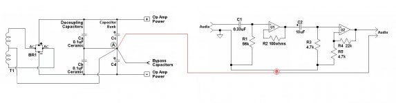

Two steps forward, one step back. Your schematic is not "basically the same".
You have again split the audio GND into two parts instead of an Audio GND with a single connection to Power GND and you have moved the Bypass GND back to A.
I still think that if you actually placed the Bypass Capacitors in your schematic things would be more obvious to you why your layout is so wrong.

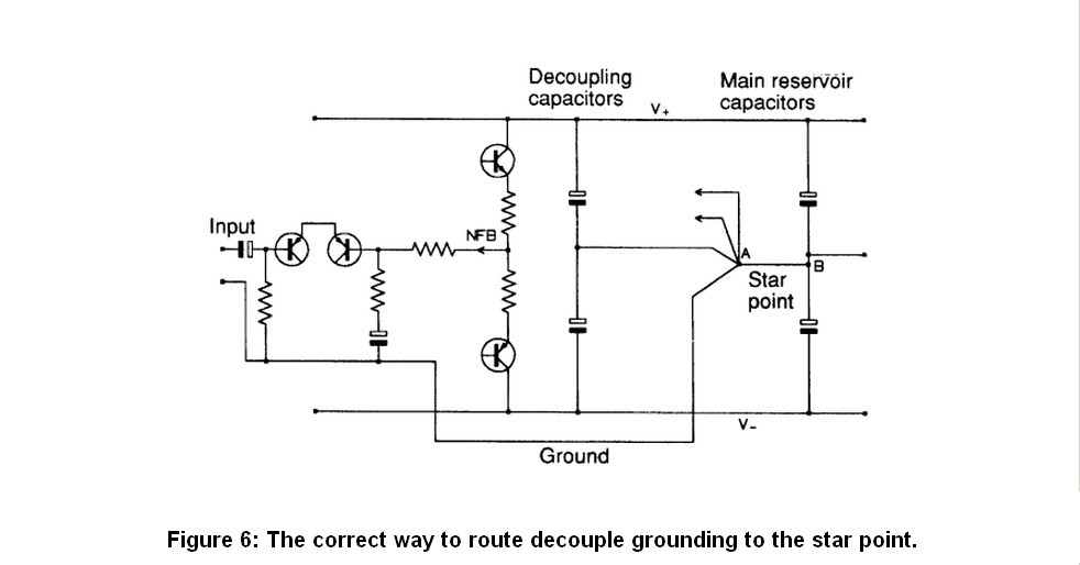

"The contribution of Distortion 6 can be reduced below the noise floor. Firstly, rigorously minimise loop areas in the input and feedback circuitry, ie keep each signal line very close to its ground. Secondly, limit the ability of the supply wiring to establish magnetic fields in the first place, by minimising the area of circuit loops carrying half- wave pulses." - D. Self.
This clearly describes how the Audio GND and the supply rails should be designed according to D. Self.

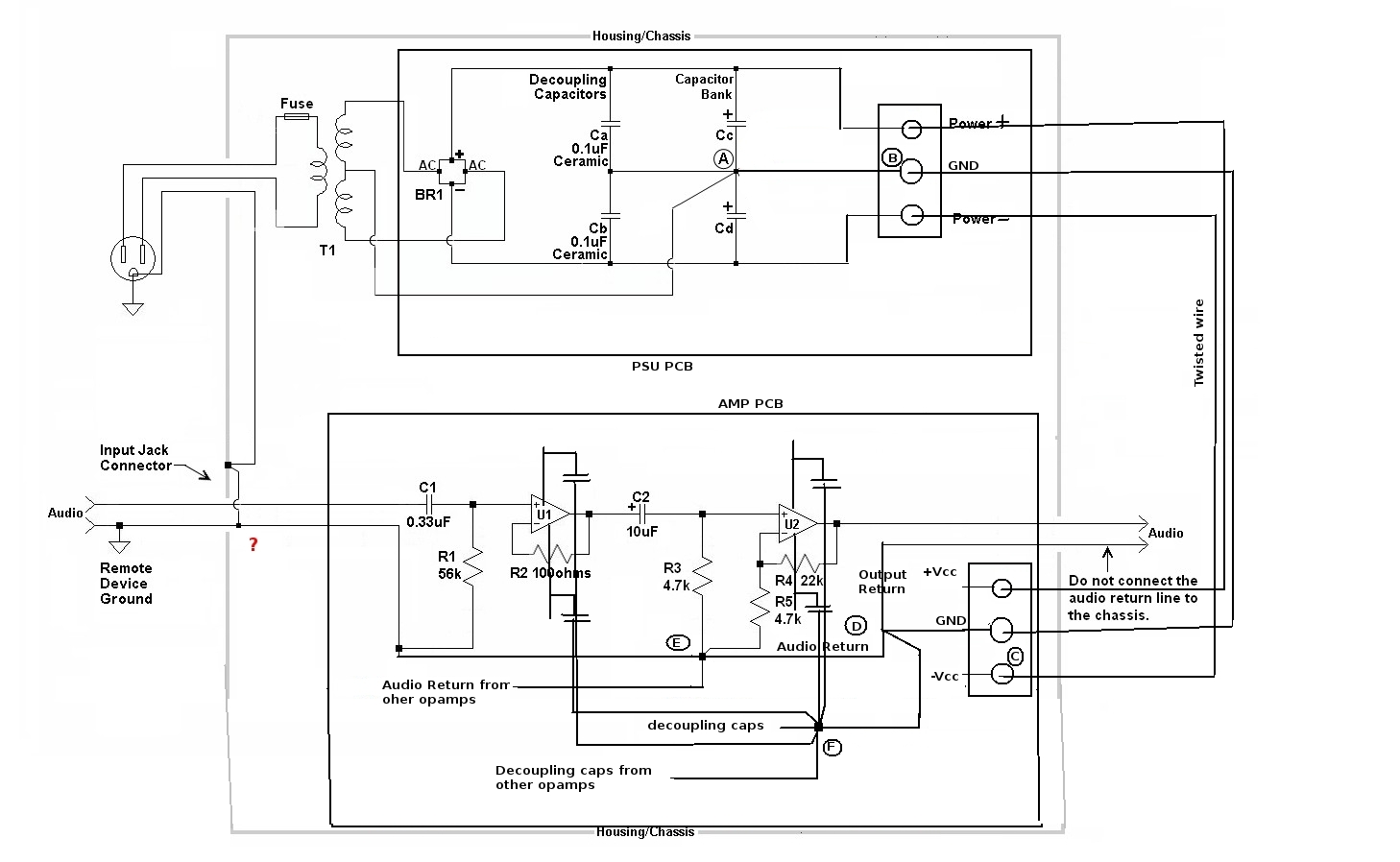

I have added the caps.
Wait a sec. I thought before that I understood what you were doing in post 99, but now I don't think I did.
It seems you're picking up the whole shebang from the PSU board, and moving it to the amplifier board? Hmmm.
Either you merge them on the amp board itself, or you run a separate line back to the psu board. Or do you merge C, D and F into one point by using a ground plane. Thats what we are discussing, whats the best way to do this. The image probably shows a common way to do it where there is a single ground return connection between amp pcb and psu pcb, rather than dedicated ones for different returns.Wait a sec. I thought before that I understood what you were doing in post 99, but now I don't think I did.

In your scheme at post #67, for example, for the audio output, how can one twist the audio return line all the way to point B? The best I could do was to twist the wire with the audio signal back to the audio circuit PCB, and then the audio return line has to go to point B alone, untwisted.
As I said before, all good questions. Certainly good enough to throw me for a loop...no pun intended. But after some thought and re-study I think I can provide answers.
As usual, the answers are one step earlier. That is, what appears to be a problem now isn't one at all. The real problem is one that occurred earlier and was left unsolved, so now, later, it's multiplying and screwing the works.
The earlier unsolved problem in this case is the sister concepts of "twisted pair" and "minimize loop area." I say sister concepts because they're both actually the same concept, which is, broadly, "minimize inductive effects." But "twisted pairs" applies to point-to-point wiring, while "minimize loop area" usually applies to printed circuit boards, which obviously can't have twisted pairs.
I think the exact problem is not understanding what a "pair" is, so herewith a definition. A pair is two conductors that feed-from, and return-to, the same source. The "source" might be many things, a transformer, a battery, an op amp, a wall receptacle, but in all cases a "pair" feeds from and returns to that same source.
Other conductors are not pairs, and are not to be twisted together with each other. Emphasizing that, do not just twist random wires together because it looks neat.. There's no evidence that electrons care about neat.
It's really as simple as that. Pairs is pairs, others ain't. So getting to specific questions:

So far you have this right.................. A pair is two conductors that feed-from, and return-to, the same source. The "source" might be many things, a transformer, a battery, an op amp, a wall receptacle, but in all cases a "pair" feeds from and returns to that same source.
Every "circuit" must form a loop. That loop brings the current from the source AND returns the same current to the source.
WRONG !!!!!Other conductors are not pairs, and are not to be twisted together with each other. Emphasizing that, do not just twist random wires together because it looks neat.. There's no evidence that electrons care about neat.

a source sends out current. That current MUST return to the source from whence it came. There are no exceptions.
All that follows seems just as mixed up. Sources send current around a circuit.
To minimise the interference effects minimise the Loop Areas. That includes traces on a PCB and includes point to point wiring and includes wiring between the terminals of big two lead passives, eg. capacitors and rectifiers.

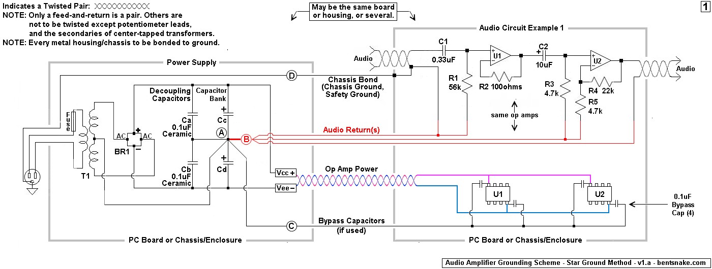

The goal is to illustrate a practical grounding scheme, while keeping the audio signal separate from all other voltages and currents.
Isolating the audio signal is desirable because all conductors have at least some resistance, however small. The result is that the conductors in an audio circuit form, in effect, a mixing board. This can mix power supply and other signals directly into the audio signal, causing noise and distortion.
These problems are usually (not always) very small, but they can add up. So the idea is to avoid problems in the first place by keeping the audio signal isolated.
Corrections/comments/questions are much wanted, especially if you're new to this stuff and think you're asking a dumb question, which you're not.
CIRCUIT NOTES:
A is circuit ground. As always there is one circuit ground point, and one only.
B is audio common, also called star ground, or star point. All audio returns (in red) are routed to this single point. As with circuit ground there is one audio common point, and one only.
NOTE: Points A and B may be very close together (perhaps 1/8"), but they must be separate terminals.
C is a bus line for the bypass capacitors (if used). This might be the most practical way to return these capacitors to circuit ground.
D is the chassis bond, which is its correct name. Usually this is called chassis ground or safety ground, but speaking correctly there's no such thing as either. It's a "bond," as in "bonded to earth." Here I'm using the correct name to, again, keep circuit ground (point A) as the single ground point.
NOTE: there is one chassis bond point and one only, located near the audio signal input as shown. But if there are two metal housings, as for a remote power supply, then of course there's one (only) bonding point for each.
WIRING NOTES:
"Twisted pairs" are feed-and-return pairs only, do not twist in additional conductors.
Only two exceptions come to mind: twisting the three conductors connecting to a potentiometer, or the three secondary conductors of a center-tapped transformer. In any case NEVER twist audio signal conductors together with power supply conductors.
It's understood that it's not always feasible to lay out an ideal circuit. But in every case try not to mix the return of the audio input signal with any other until point B (audio common) is reached. The input is the single most delicate signal in any circuit, so protect it in any way you can.
The shown circuit should be considered as a practical method, but not as "the only right way to do it." Generally, remember to apply the principle of "separate the audio signal from all other voltages and currents" and your circuit will be fine.
WIRING NOTES:
...while for clarity, I hope, and contrast, posted below is the all into one grounding method. As a matter of fact this method has worked fine in many circuits, but when it comes to avoiding noise and distortion there is a certain element of luck involved. That's the purpose of the star ground method posted above, not depending on luck.
