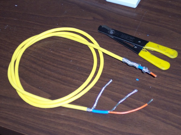

Yes, twisted triplet is important when you worry about the output current into the load. If you only twist pos and neg, then positive current into the load will not go back to the supply via a twisted pair. Same with negative current into the load. If you look at bentsnake's schematic in 119, he twists the supply rails, but the load return is somewhere else. No magnetic cancellation by common centroid.
Bringing the three supply current wires together and twisting or braiding reduces the radiated field by common centroids (on average). Triaxial supply runs actually cancel radiated field entirely.
EDIT: I added a picture of a triax I made back in 2006 for exactly this. I took a bog standard 14awg orange insulated wire, pulled some mike cable braid over it, blue heatshrink over that, another braid layer, then a yellow heatshrink over that. I used the outer braid as ground, inner braid as negative rail, and core wire as positive rail. Everything from parts express, they had a good deal on 1000 feet (maybe 500, been so long) of mike cable, so I picked it up. Plenty left..

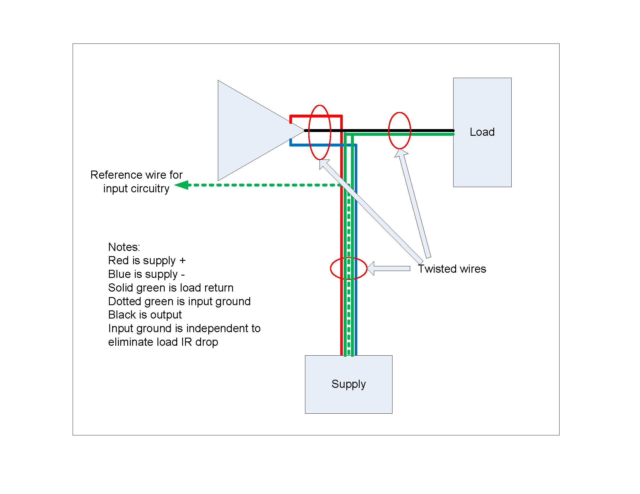

Doesn't matter. Your schematic in 119 is horrible, everybody is explaining why, you ignore.
Which actually leads into my main point, which is that in a rather long post #136 you make no reference at all to the posted schematic.
I left the trashing of your drawing on the cutting room floor (which is pretty much how I'd explain it.) I didn't see the need to point out how badly it considers EMC concerns within the chassis, violating simple understandings.
When you learn the concepts, you will be able to identify the errors in your schematic. Merely repeating what another says isn't getting you anywhere.
Waxing poetically using warcraft scenario's is not intellectual at all from an engineering perspective. I recommend you lose that attitude, and ask salient questions.
edit: btw, you've no idea what a long post is. Ask around..
But while all of that goes on I continue to solicit input regarding...pssst...wait for it...the posted circuit. The one away back there in the aforesaid post #119. Anybody got any thoughts, love to hear 'em.
It's garbage, drawn by somebody who has no clue as to electromagnetic theory, electromagnetic compatibility, faraday's law of induction, ampere's law...the list goes on.
Is that how you'd like it? I've been very gentle in trying to get you to step back and learn something, you've not been nice in return.
1. You've twisted the rails only, this does not cancel rail to ground currents.
2. You've shown load ground starred to signal ground. It is not possible to create orthogonality between multiple grounds connecting to the same point, so load currents will couple to the ground reference used in the rest of the circuit.
3. BY DESIGN, you are also creating external chassis to chassis ground loops. Horrid design techniques.
I've watched others spell out reality to you, but you still argue.
Don't.
Learn instead.
jn

I think you are exaggerating the case here. Both rails are at AC ground. The impedance between either rail and ground is tiny. 3 wires are awkward to wind regularly. Not that I intend to add weight to bentsnake's case.
Both rails are tied to ac ground via caps. Time varying currents will cause external magnetic fields that are time varying as well. That allows coupling.
The DC resistance is tiny. At frequency, it is no longer tiny.
Go to the diagram in post 119, and explain why that will not oscillate at high frequency. That is how badly the inter-chassis or board layout is.
