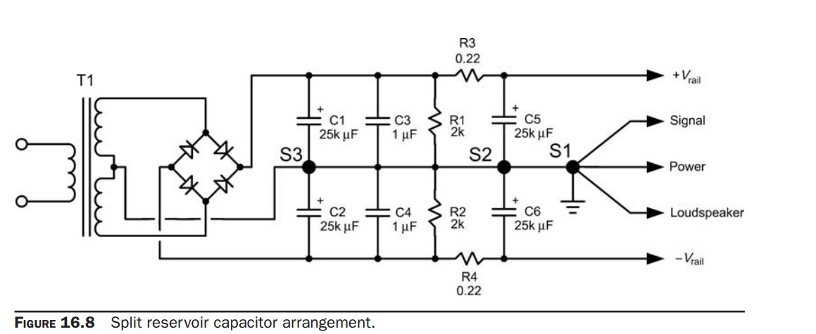

Necessarily in the context of the posted circuit, since if you don't refer to that then how do you expect your comments to be understood?

And now you dragoon into service poor Bob Cordell, who willy-nilly must join the affray. Well if that is your will, then sobeit.
The posted illustration is from Mr. Cordell's "Designing Audio Power Amplifiers." Obviously it's figure 16-8, discussed in section 16.9, "Grounding Architectures."
Don't be silly. That is a schematic, not a built device. It doesn't detail the mutual couplings, the loops to avoid by layout or design. He only prevents IR drop I/O coupling. He assumes YOU understand layout techniques. He can't draw in and caution against every screwup people like you can possibly make.
That is what we are trying to teach you. Perhaps you are spending too much time playing video games, and not enough learning E/M?

No. What we're interested in is minimizing the return loop area. If the AC voltage on the +ve rail is coupled onto the -ve rail, it will return to the PSU, if the -ve rail presents the most favourable path.. This is because each rail is effectively AC ground for the other rail. This is why it is important to twist the rails together, but not so important to include the ground.
...all output load current will return to the supply via a wire that is not near the rail wires.
This is normally the case. The speaker wire cannot be anything but remote from the rails. The load return is normally unceremoniously connected to a spur at the midpoint between the +ve and -ve PSU caps.
Go back to my simple drawing, it explains it all. post # 144
You speak of voltage.. I speak of current. Load current

Friends:
Looking at the document posted at HIFISONIX.com, titled, "How to Wire up an Audio Power Amplifier for Zero Noise Problems," I wanted to verify that the chassis isolation network, consisting of a bridge and 15 ohm resistor is correctly shown. In the figure, it seems that the + and minus terminals of the bridge are wired together with no other connections; one AC terminal goes to the chassis and AC inlet; the other AC terminal goes to the "T" ground.
This seems to be at odds with the ESP schematic, which has been posted (often without attribution, but then again I'm not sure who came first) on this DIYAudio site. The ESP schematic shows the AC terminals of the bridge tied together; and the plus and minus terminals tied together, with the resistor (and a capacitor) connected between the tied-together AC terminals and the tied-together plus/minus terminals.
Can anyone verify the proper schematic, or if both are alternate acceptable approaches?

Geary, you may be looking at an older version of the document. Here is the updated version
http://hifisonix.com/wordpress/wp-c.../How-to-wire-up-a-Power-Amplifier_Updated.pdf
One end of the AC terminal is attached to the chassis and the incoming GND from the inlet is attached to this point as well - so the chassis is solidly connected to the mains ground. The other rectifier AC terminal is attached to the amplifer 0V rail. The + and - are indeed shorted together but not connected to anything else. If AC mains is accidently applied to the amplifer circuit, the rectifier will clamp the fault voltage to 2 x Vbe.
You can also do it the way Rod Elliot does it, in which case the clamp voltage is 1 Vbe.
Both approaches work equally well.
