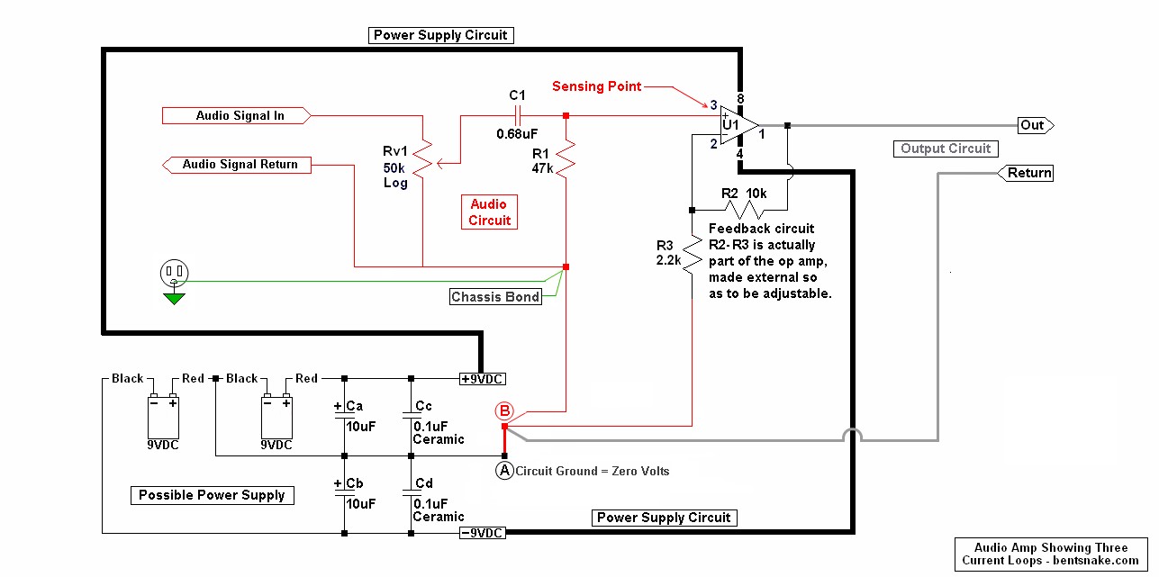

I would rate the star ground circuit as substantially worse then the common ground one (But neither are ideal), the problem is that you seem to be treating opamps as 3 terminal devices when they are really 5 terminal ones.
Consider for a moment the current flowing at the output of the audio circuit, and consider a time when the opamp is sourcing current from the positive rail, now, that current has to flow in a loop back to the positive supply pin of the opamp by some means... In the star ground circuit thus is via node B and some combination of the supply caps and node C (Via the decoupling caps), that is a lot of loop area.
In your ground bus based design the loop is simply via the decoupling caps, job done (But 10uF or so of elco across each of those 100n bypasses will get you substantially lower THD at low frequency).
My favorite approach is something of a hybrid, use a ground plane for the decoupling caps and be smart about where I connect audio reference nodes to the ground plane. For example R1,3,& 5 as well as the input and output could all be netted together and tied down to the plane at one location, which means that only audio current would flow in that net.
Planes (And monster copper pours) are your friends...
It is possible to get all kinds of complicated about grounds (and this is, for the most part, an audio disease), you just don't see it anywhere else, and plenty of other places deal with signals that are MORE delicate then line level audio.
Regards, Dan.

Many thanks to those commenting on the posted circuit. A hiatus while I carefully study these, along with others that might be posted.
Not including comments about loop area. Loop area does not appear on schematics, as I'm now officially tired of pointing out. If you want to talk about loop area, then post a parts layout so you'll be talking about something that exists.
Meanwhile, the below posted might be amusing. It's intended to show that any audio circuit consists of three current loops (NOT loop areas). They are:
1. The power supply loop. Theoretically the op amp is unaware of the power supply. As far as the op amp is concerned there's just a source of infinite current at a given voltage.
2. The audio circuit loop. Ideally the op amp is also unaware of the audio input circuit. It's only aware of a voltage change at the sensing point, in this case terminal three.
3. The output circuit loop, which is the one currently under consideration.
Interestingly, the output circuit does not exist until the op amp creates it. That is, at zero volume the output circuit is just a collection of wires, it has no electrical significance until there's an output from the op amp. To create an output the op amp valves (hence the term) a controlled amount of power into the output circuit.
This is interesting because it speaks to current return. At zero volume the large power supply conductors carry only the small current necessary to run the op amp, perhaps 10 millamps.
But as a for-instance, a 20 watt amp running at 20 volts must return a full one amp to the power supply (watts = volts x amps, so amps = watts / volts). This doesn't sound like much until you realize that it's 100 times the current running the op amp.
This points up why current return must be considered. If the input and output signals were perfectly clean, and in phase, it wouldn't matter. But of course no signal is perfectly clean, and the op amp itself introduces a phase shift, so mixing the output back into the input will inevitably result in distortion.
Admittedly this brings up the eternal question: does it matter? Phase distortion, for instance, is subtle, and it remains a fact that any given amp is far, far more accurate than any given speaker. So whether it matters might be a matter of taste. But still, why introduce distortion on purpose?

You repeated what I posted well enough.
Now,
Look at your drawing very carefully. Note you have two rails and the load return current drawn as 3 independent entities. You have drawn loops as you indicate.
The output must be intimate with the load return from the load to the amp. Your drawing does not indicate such.
At the amp, the load return must be intimate with BOTH rails. Your drawing does not show that either.
The amp reference ground needs to be considered as well for loop trapping. There is nothing on the drawing to indicate this.
Draw in methods to control those loops, then let's discuss.
