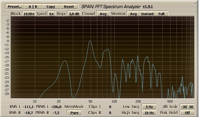

Do this only if you are prepared to start thinking about room treatment. The little notch due to unperfect addition around the xo will be swamped by numbers of much bigger peaks and notches from the room modes. I would say, if it sounds good, let it be, since you probably cant see it anyways.
As an example i added a picture of the inroom response of a loudspeaker, which would be flat from 20-300hz without the modes.

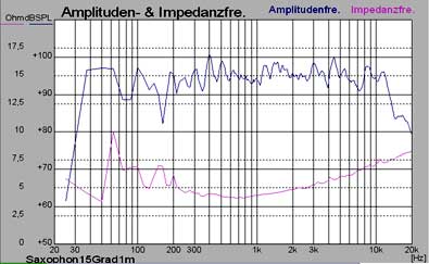

Hallo Mavo,
your simulation is with a active sub modul,
only useful for~ 50 Hz 18 dB, listenable ~ 90 Hz.
i remember my post, to use the horn over 100 Hz,
you can manage this with bass horn mouth distance,
a partial delete between 100-250 Hz, by taking two smaller TH.
SAXOPHON example
