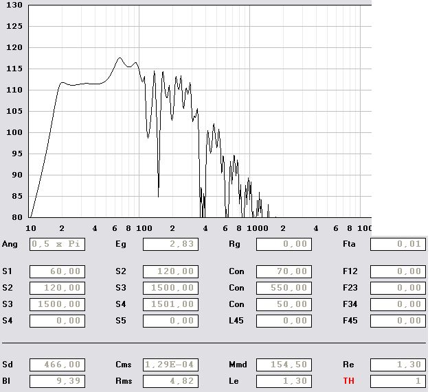

Hi aceinc: Try adding a series inductor by adding 0.25 Ohm under Rg and 7.62 mH under Le.

Hi Aceinc: The Tapped Horn is a very demanding box, that requires the driver to have a specific balance of T/S values. Some drivers do well with the taps at the throat and the mouth, while others require the taps to be well away from both.
Most drivers don't do well at all.
I had hoped that David McBean, or Tom Danley ... (or anybody) would give us a simple calculation that would allow us to qualify a driver as acceptable / unacceptable for a tapped horn. Perhaps some calculation involving CMS and BL would do it.
For the time being, we'll just have to plug values into Hornresp until something works.
True, and why using other than measured specs of your driver is a crapshoot at best WRT how well it matches the sim. For HIFI apps though, the room dominates, so I personally can't get too worked up over how flat the sim is.
Right, assuming you're trying to get the max HF BW out of it, then the higher the driver's mass corner (Fh), the closer to the ends it needs to be.
Well, within reason they can all be made to work, just maybe not in the particular BW we're most interested in.
Simple band-pass theory works well enough for me and manipulating Prof. Leach's horn math gets me the throat, etc. and why my sims are typically somewhat larger than some other's that seem to me to be more trial n' error Hornresp derived than based on any specific BP/horn design routine, though feel free to prove me wrong. 😉

Oliver:
I will try what you suggested when I get home. What affect will the inductor have on the FR? Act as a low pass filter?

The 10" Titanic has a small VAS, and a moderate FS, does this seem like it might work for a TH? I would like to slide the FR window down towards 18-20hz if possible.

Looks good to me in a variety of sizes and since less is always less WRT cab gain BW, how flat down to 18-20 Hz is a function of size, so how flat can you 'afford'?

aceinc said:I am playing Hornresp 1910-080422. I decided to see what I can do with some Dayton Titanic III 10" specs. I used the Parts Express DuMax report rather than the MFR specs.
I sure as heck can't get the pretty flat curves you guy's seem to get. Can someone please point me in the right direction?
Below is what I have so far.
I chose the Titanics because I currently have two in small sealed enclosures begging to be set free.![]()
Paul
If you think that 2db dip is bad, you'd cry if you knew how inaccurate published specs are. I've never measured a single driver that was even in the BALLPARK of published specs. The only exception I've found were prosound drivers like Galaxy Audio and B&C.
so....
I'd go and spend $100 on a PE woofer tester before making any sawdust. When you're done with your project, just sell it on ebay for $80.

aceinc, go look at Erik's design in post 666 and also a few posts later. Eminence 3015LF driver and huge output potential to 20Hz with a $US180 driver. Also check out his site www.volvotreter.de -> Tapped Horn and the drawings for it in the download section.

Hello aceinc:
Here is my take on scenario #1.
Probably needs a good x-over to reduce the wiggles or some tuning like Tom Danley used in his TH.
thats a phenomenal low end extension, killjoy, but the high frequency ripple is really ugly. i dont know how important it is, but i like plots which fall down on both ends of the passband.
William Cowan recommended the peerless xxls car audio driver 830877 to me, which i used in the following sim. Its much bigger than yours and doesnt go as low, but meets aceincs specs.
now if you could get a plot like this one, only half an octave lower, then i would be really happy.

Hi - Frequency Ripple
Hello MaVo:
I agree about the ripples. I have some ideas about how I will deal with those but I am working them out with a smaller test horn. I still like the idea of using an extreme slope x-over (120db). Even in your sim I beleive there will be some evidence of the higher frequency ripples in the response that may lead to distortion.
I just spent a week reading the "Beyond the Ariel" post started by Lynn Olson so now I can talk about stuff that sounds good but I don't know a lot about 😀
I also think I spend way to much time playing around with THs in Hornresp.

Digital or analog filters wont affect the distortion amplifying qualities of those peaks. So to get the lowest distortion, a falling response above passband and smaller ripples are nice.
