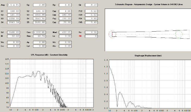

B&C 21SW150
Hi, just found this one: B&C 21SW150.
http://www.usspeaker.com/B&C-21SW150-1.htm
http://www.bcspeakers.com/index.php?sez=1&categoria=2&prodotto=201
In a 2'x2'x7.7' box it makes for a killer tapped horn in Hornresp.

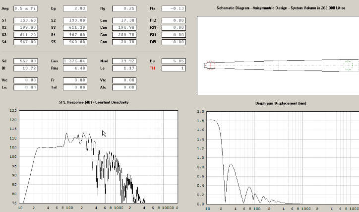

ok FINAL design i hope, i think i finally after months of learning have this thing right, and can convert between plan and simulation easly enough now
(here is the plan)
(and here is the prediction in horn resp)
(i used this method)
so as far as i can see im good to go, could someone just confirm that i have done this correctly? thanks
and anyone feel free to use this if u like, but im sure there is better options, ah well live and learn
(here is the plan)
come on guys lol, im building this tomorrow! gotta make sure i haven't made some stupid mess up that will ruin all the hard work😱

Naudio_Eminence_TH
Hi Naudio:
From what I can see I agree with Don Snyder, assuming that you are still going with the Eminence Definimax 4012HO. As a learning experience I redrew you enclosure, and attached the Hornresp labels for a four section horn. Naturally, it models just the same. It does give you another degree of freedom for you simulations though.
You may want to take a look at the dimensions at the turn-around in the long horn section, I don't come up with the same dimension as you do. Also, the location of "s3area" in your sketch should not be at the bottom end of the horn, but belongs at the point where the wave coming from S2 along the "L23" path interacts with the loudspeaker and the wave along the "L34" path. Neither one of those items changes the model significantly. According to Hornresp,this box/speaker combination seems to be very forgiving. I came up with one simulation that has a fairly similar frequency response with a system volume of 194.1 liters.
Have fun with you project.🙂
Hi Naudio:

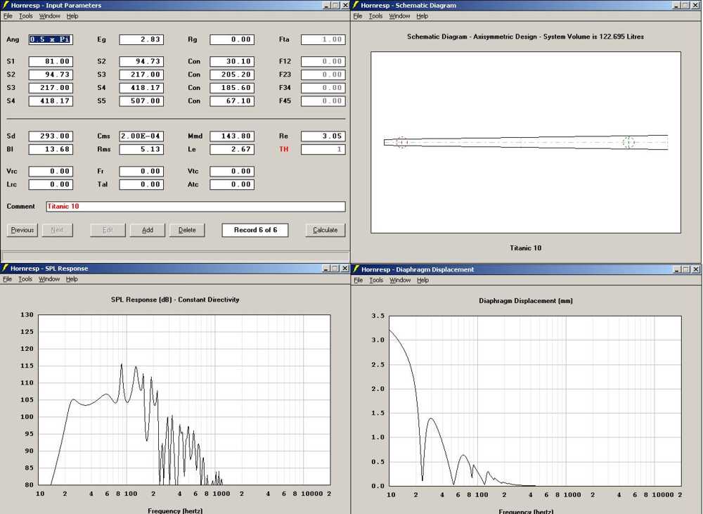

I am playing Hornresp 1910-080422. I decided to see what I can do with some Dayton Titanic III 10" specs. I used the Parts Express DuMax report rather than the MFR specs.
I sure as heck can't get the pretty flat curves you guy's seem to get. Can someone please point me in the right direction?
Below is what I have so far.
I chose the Titanics because I currently have two in small sealed enclosures begging to be set free.
Paul
Paul
