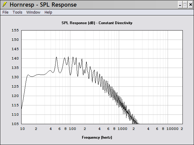

MaVo said:
.......but the high frequency ripple is really ugly. i dont know how important it is, but i like plots which fall down on both ends of the passband.
AFAIK, without using mass quantities of EQ there's no 'replacement for displacement' to get a ~smooth TH response from top to bottom, like ~3945 L! in the case of a $100 Eminence Delta 15LFA:
GM
