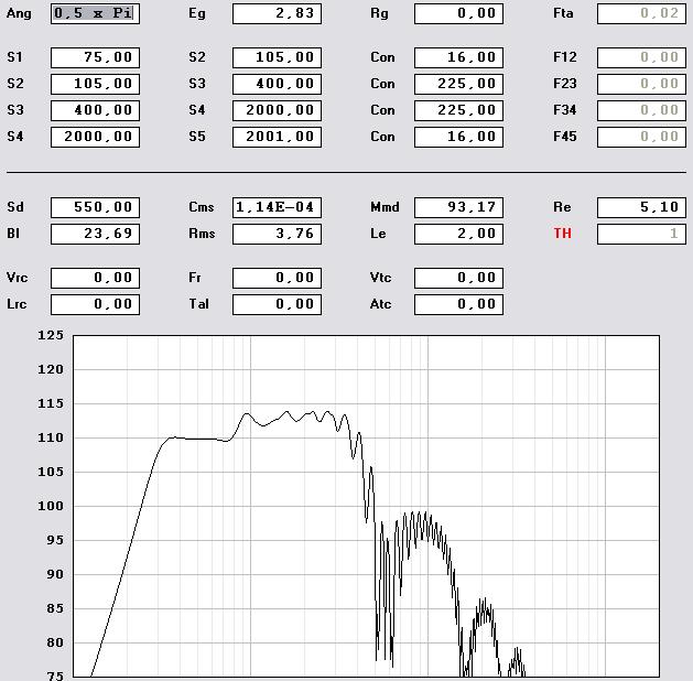

Hi there,
i want to make some changes to my system and maybe you could help me with it.
First the background: I decided to change my offset driver horns from 3 way to 2 way. I do this in order to place the woofers around the room for a smoother response in the modal area. My design goals are to have low extension, usable spl and a high frequency corner in the 100-200hz area for crossover to the horns. As i am stuck on the drivers, which are four Beyma 12P1000ND, i have to make them work in this setup. I want to use them in tapped horns. I can design digital EQ for them and use steep filters, so i have an additional degree of freedom here.
I have added a picture of the design, which seems to be the best tradeoff.
My questions are:
- Is there something wrong with this setup?
- How can i improve it?
- The horn is quite long. With a 3 fold, 4 segment horn, as posted on volvotreters homepage, i end up with a pathlength of each segment of about 160cm. Does the 1/2 WL resonance of around 100hz mess up the frequency response?
- The efficiency rises with frequency and the acousstic lowpass is quite high. I tried making it lower, but did not find a way to achieve this, so i made it maximally flat instead. Does this make the distortions stand out too much?
Thanks, if you made it this far. Maybe you even post a reply 🙂
Maybe i should sacrifice the < 20hz performance? This would make the response alot smoother. I dont know if the smoother response is worth the sacrifice, since i could eq the 20hz version. It would bring the upper band distortion level down a few db though.

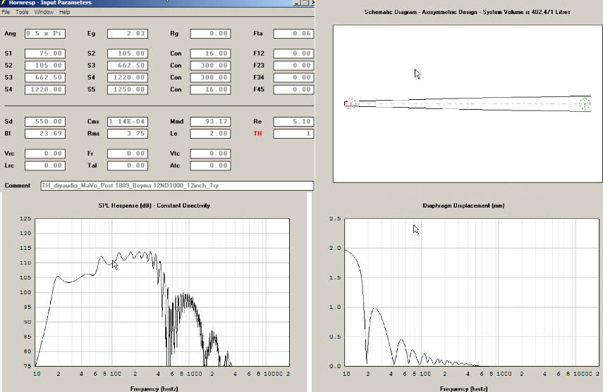

MaVo: Beyma, 3 v. 4 section TH
Hi MaVo: When I typed your values into Hornresp I got the same SPL response that you did. When I changed it into a 4 section TH the SPL response and the system volume changed quite a bit. I cannot find anything wrong with my input data, maybe you can take a look at it, or is there a problem in Hornresp?

MaVo said:
Hi there,
My questions are:
You don’t need simulated/modeled response flat to 20Hz in order to get it in your room. Room gain will naturally boost the low frequencies. The rule of thumb is it will boost at +6dB per octave when the longest dimension of your room is half a wavelength. So if your room’s longest dimension is 5.5 meters/18Ft. boost would get rolled in around 32Hz. Response would be +6dB at 16Hz, +4dB at 20Hz, and +3dB at 24Hz. In my personal experience, the room gain effect has been more than this. Provided you have an average sized room, I find shooting for around 27Hz (+/- 2Hz) nets me 20Hz response in most rooms. Having a falling response at the low end can actually help keep the bass response in the room level. You can always EQ down the response, but why don’t you let your room work for you. It will result in a smaller horn that still achieves its goals.
I would also advise you don’t try using a tapped horn up in the peaky high frequency range. Basically we are trading bandwidth for a smaller package. The trade is well worth it to me. Every time I have tried to stretch the performance of something, it has always backfired on me. Use it where it is intended. If you need coverage up to 200Hz, then build a couple smaller tapped horns, or a conventional front loaded mid-bass horn. Although, I would personally try to avoid using any kind of folding in a horn above 80Hz.
Rgs, JLH
