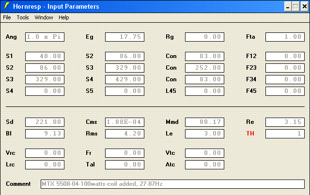

Hello Chris8sirhC,
The size of the TH increased from 455L to 557L on the 2nd attempt at modelling the MTX. I may be slightly off in the size increase since I am not looking at the pdf right now. 🙂
Chris8sirhC said:133db at 15hz or so isn't too shabby... I think i found my new HT subwoofer...
In your pdf you said "but it increased the TH some."
did you mean that it increased the size a little bit or it increased the total harmonic (distortion)?
Hello Chris8sirhC,

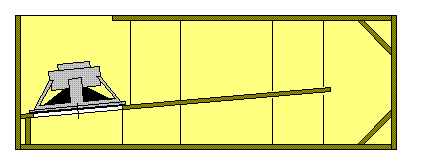

Here is where I intend to put the braces, one every 500mm, each one is 160mm long:
I found my wood was actually 16mm thick after measuring it, so Sketchup turned out to be pretty useful in working out what size wood to cut while keeping the same internal dimensions. I've also modelled both versions of the horn (again) in hornresp and found actually the 4.8mm throat version gives better results with my driver after all so I'm going for the new version of the enclosure. If can post the sketchup file is anybody needs it?
I really can't wait to get started now, hopefully my next post should have some pictures... 🙂

Question, William: Did you have a problem with any of your boxes buzzing?
It's not hard to visualize where the weak areas are. The left-most brace supports the speaker edge and the edge of the mouth, and the right-most brace supports the flare edge. A center brace wasn't needed.
I cut my braces on my table saw using a sled, and all four fit first-time. I cut all the 16 inch wide pieces in one setup, and the box went together with TiteBond II only, no leaks. I thought about putting a cross-brace in the mouth, but wanted to be able to remove the driver. It hasn't proven to be a problem.
The goal is to build a stiff box with good damping. If it's stiff, it'll be strong enough. If it vibrates well above passband, no one will ever know.

G'day Don
That picture that Mike attached to his last post is exactly how I brace my tapped horns. No problems with buzzing, even in the unbraced versions. The unbraced cabinets do flex a bit, and I think this reduces output a bit, perhaps also increasing THD a little. Not sure if it's all in my head, but I like the sound of the braced versions better.
BTW I have BAD problems with my house buzzing with some of these tapped horns
Maybe I need to brace that too 😀

I spent 30 years in aerospace, designing gear that had to go thru Shake-N-Bake (vibration & thermal cycling). We would take a piece of gear in to test, and the technician would tell us what part would fail first. They were almost always right. Sometimes, I wish I had one of those techs around.
I said, "A center brace wasn't needed" as my box is only 1.5 meters (60") long. I wouldn't build a seven foot box without two more braces.
After your box is assembled, take a small hammer and tap on it. Any place that sounds hollow or rings should have had a brace. Another trick that helps, is to lay it down, and sprinkle salt on the plywood while it's playing. The areas where the salt won't stay put is where you needed more bracing.

MikeHunt79, could u post your sketch and your horn resp input info please, thanks

about hornresp, if 2 drivers used, what values to double?

I'm at work right now so I have access to these files at the moment - I'll post them when I get home. I do have MSN but I'm not on there very much as I'd rather be cutting wood than clicking a mouse. 😉 I'll add you next time I'm on tho.
Your Lab12 driver is quite a different beast to my Magnum 12HO, and it may not work too well in William Cowan's 30Hz enclosure. Maybe try it out in hornresp?

As promised, hornresp parameters and I've done a mega high res shot of the model with as many measurements as possible.
