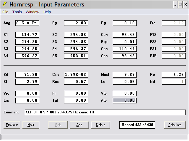

I made a simulation with KEF B110B out of the legendary BBC Studio Monitors Ls3/5a and KEF CS1. They are nice little 13cm long throw woofers 6mm linear peak-peak and 12mm xlim peak-peak.
Any tips on further improvements?
Simulations are based on the published specs by KEF long time ago, found here: http://www.hifiloudspeakers.info/Anatomy/KEFDocuments/KEFGermanGallery/pages/p35.htm
Some new TSP measurements couldnt hurt I guess.
regards, Micha
Quite the contrary. Your specs are quite a bit different from the published ones you linked to, which calcs a narrow ~28 - 43.75 Hz max BW, too little for a TH AFAIK:
