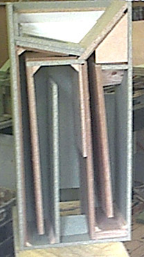

One of the earlier TH designs for a LAB12. I have the drivers, my home has a huge open plan room (so no LF gain) and excess is my true path. Once I build the shelves for my books and LPs, the TH because of their small footprint will blend in well. Two of them will be built into the iternal gardens my living room has so will be invisible.MaVo said:May i ask what design you have in mind which uses 6 Lab12 at home?
Do you think 3kW is enough power for them?
Not 6 LABhorns, but 6 TH with LAB12 drivers. I agree that 6 LABhorns would compromise the structural integrity of the dwelling.Sabbelbacke said:6 Labs at home sure would tear your house apart 🙂 Overkill at it´s best 🙂
Maybe, maybe not. My neighbour hated it when I played my bass through the LABhorns. Slapping E in the best Wooten style would get all her crockery dancing in her kitchen, but it didn't sound 'loud' in my room.MikeHunt79 said:

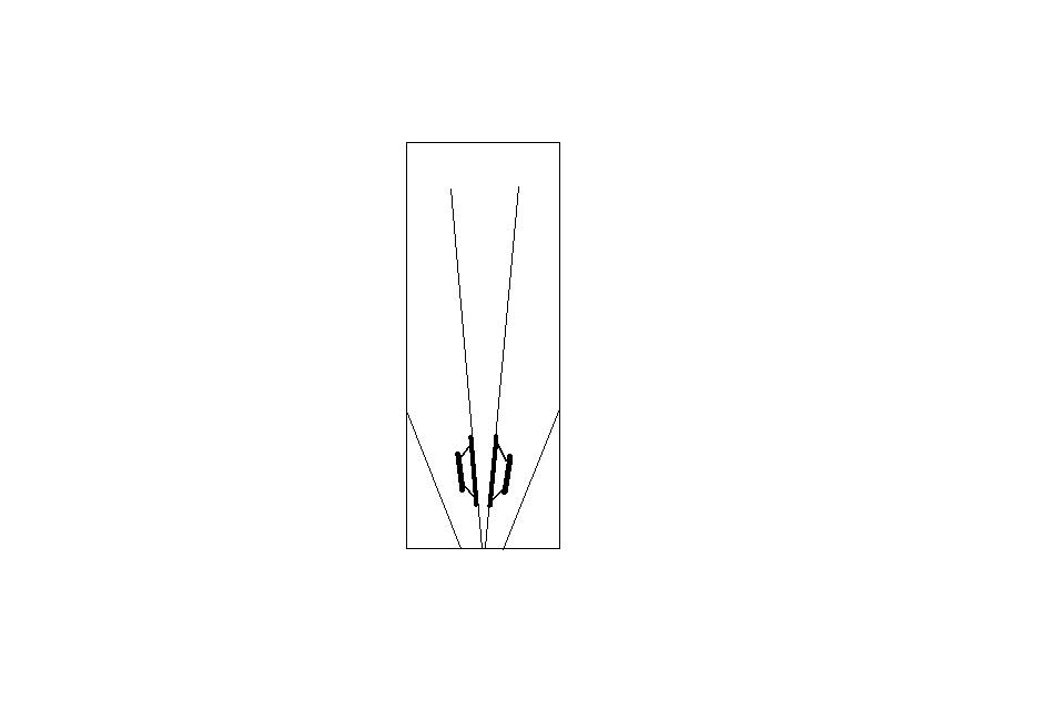

Hi HM, i think i get a grip on what you do.
You build one enclosure which houses two horns, driven by two drivers, one driver per horn. Those two horns have a different tuning. Both horns are rearloaded / without a closed volume on one side of the membrane. The hornmouths are placed in a certain distance to each other. The drivers are wired parallel and in the same phase. So you get a speaker which is one way, without crossover and has hornloading over a broader frequency range, than a single driver in the same enclosure space could do.
Here are my thoughts on it: Your horns are probably pretty small in bandwidth since they are small in size and because of that resemble more a resonant tube than a horn. By using two of this, you achieve a broader frequency range which has some loading. This is probably usefull in a passive one way speaker, as you get more efficiency and still dont need to use a crossover or several amps. Maybe i miss a critical point in the design, but it seems that it brings no benefit for speakers which use crossovers, as one can easily build as much horns for diferent frequency ranges as one likes.

Do you assume that there is a beneficial interaction between the two horns, besides the addition/cancellation of the sound from both sources?
i think so,
normally the short horn goes in the
(sorry) akustischen Kurzschluss you
see on the single simulation, but real system
measurement shows a bass bigger as the long
horn below 40 Hz, it is a 4 Ohm effekt, at the lowest
oktave you eliminate the reso imp, look in comparison
a single simulated imp of a tapped horn.
the parallel wiring may contol the stroke of the short horn by the driver of the long horn, so it does add SPL, what single driven not happend. Lower system movement, the step response of the Saxophon is better as can be!! , and i saw a lot of single 8" driver.
only if less large "change press ", (linearized stroke)which again
the mechanical Membrane charges minimized and so
Sound and SPL maximized.
P.S. i would test two tapped back to back in a corner,
mouth distance is "OK", corner loading, indirect sound.
wave length > 3,4 m- 20 m, listenable after the 4 wave,
ear brain system, so 40 Hz ~8,5 m, is 34 m on the run
before you get it, take this in relation to the dimension of your listening room.
sorry for the english, school 35 years ago.

say i wanted to build the 30hz horn the same as mikehunt, if i chose the right driver and added some lose stuffing along line, would it work as if the line was longer and get me down to 20hz? is is possible, im guessing it may filter the higher bass frequency slightly, but this may all fit together, even 25hz would be ok
if that doesn't work i would like to convert mavo's simulation for the lab 12 horn, into a atual design that will fit in my room, 220cm would be the max hight allowance, been sitting on this a while, i really want to get cracking now
