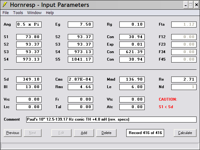

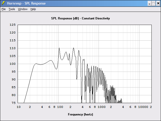

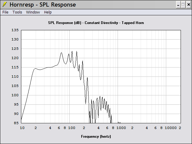

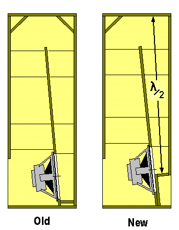

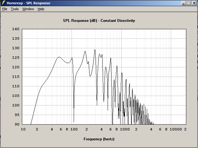

Getting back to what I was saying about dealing with the first large peak in response. Below are the insides of the DTS-20 taken from the international patent.
While not everything is to scale, it is easy enough to figure out from the mouth to the first bend is 86.5 inches. This works out to 1/2 WL at 78Hz. The next thing I did is model the DTS-20 in Hornresp using a Lab12 woofer. I know the Lab12 is not the same woofer Danley uses, but it should be good enough for our purposes. Here is what the response of the model looks like.
Well, look at that! It appears that I was correct in assuming Tom uses the folding length to attenuate that peak at 78Hz. I can also assume that the 5mH inductor helps bring down the next peak as well.

OK I did a bit more research on the driver and this is what I have come up with;
My intention is to not limit the size of the enclosure, my goal is to acheive the lowest loudest bass possible with these drivers. I do not need to worry about midbass or anything above 60hz for that matter.
Well, just running the numbers to put the first peak above 60 Hz yields ~317.1 L. With a low Xmax, only 14 W is required to hit DD/DTS reference if corner loaded and the room's well constructed. If you prefer to build one big one instead of two semi-big ones, then just double up the pipe area all along its length.

If you make at least one length of the tapped horn 1/2 WL at the frequency of that peak, it will be acoustically reduced by a fair margin.
I think it does help as you say - at least the PD1550 TH mentioned above seems to show less output around 80-100Hz than I'd feared. It is very hard to measure though, due to room interactions (hence I did not post results that far up).

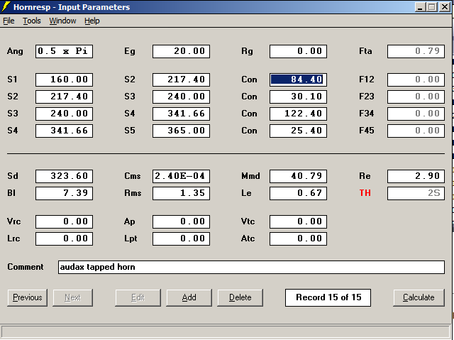

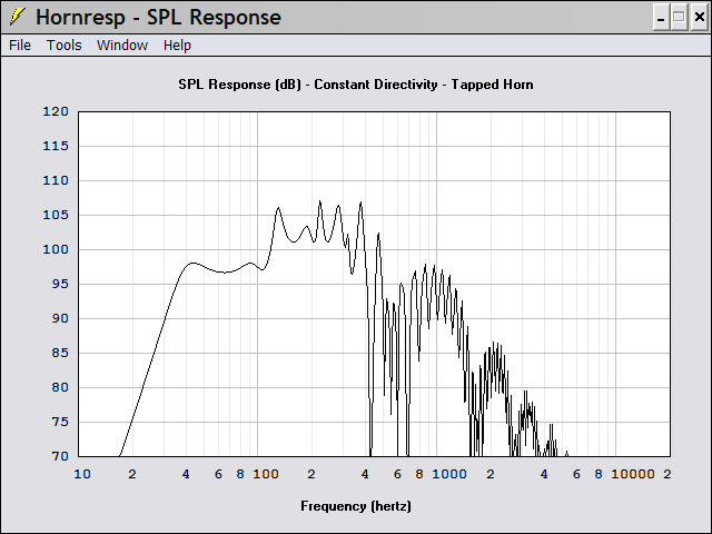

$56 tapped horn
Here's a tapped horn design using two of the Audax woofers on sale at P.E. for $28.
I already purchased two of these for another project, and they're great drivers for the money.
The response falls off dramatically around 50hz, but I did this on purpose. It's designed to be used in a car, where cabin gain will fill in everything below 60hz.
See attached.

Re: $56 tapped horn
Here's the dimensions. The driver is an Audax ht240g0.
Note there are TWO woofers in the horn. That's why L34 is so long. You can get flatter response if L34 is shorter, but it has to be a minimum of 25cm to fit both drivers.

JLH said:Getting back to what I was saying about dealing with the first large peak in response. Below are the insides of the DTS-20 taken from the international patent.
A single WL/2 resonator probably isn't enough to bring down such a high peak, but of course the DTS-20 has two of these resonant sections in series -- the one from the top to the mouth, but also the one before this from the bottom to the top.
The 5mH inductor won't have that much effect on the next peaks, but maybe these are taken out by the WL/4 pipe resonators (not in the patent, but shown on earlier photos of the internals) -- has anyone measured the length of these to see what the resonant frequencies are?
So maybe it is possible to largely eliminate the tapped horn peaks by purely acoustical means, but the design is now getting more and more complicated with more and more trial and error likely to be needed for this to work -- which I guess is where Tom's expertise lies...
