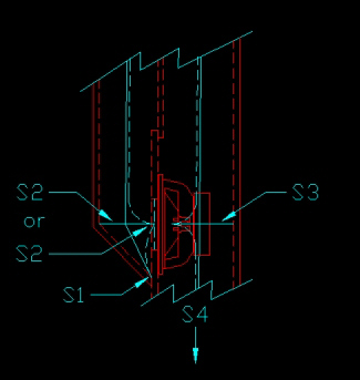

I used the xls file posted earlier to give me my box dimensions:
And I thought I would see if they work ok of I put the measurements over the lab12 pic posted on the last page, all dimensions are in cm:
Now, the main problem I can see is that L34 needs to be 60cm, which is longer than the box. Does this mean I have to move the driver up inside the box?
Would it be worth seeing if I can get L34 to be less than 30cm by trying out some more designs in hornresp?

Hi MikeHunt79:
Post #1520: you ask about the compression ratio (SD/S2) for the model in Post #1518, it is about 2.3 (522/240). I'll attach a sketch of the box construction I was trying to model. I think Hornresp does not allow you to put the driver/throat at S1, so when you model an enclosure with no or minimal S1 and no or minimal distance between S1 and S2 you have to make some adjustment in the model and hope that the end result is still correct.
Under Le I added 2.5 to your Le of 0.89, I also took a wild guess at the inductors resistance as 0.20 in Rg. When you add a series inductor you have to still optimize the elements in Hornresp to arrive at a flat response (if you care). To me it's half the fun of having a wonderful tool like Hornresp as a design aid to keep on manipulating the parameters and seeing what I can come up with 🙂.
Post #1525, quote: "...the main problem I can see is that L34 needs to be 60cm, which is longer than the box. Does this mean I have to move the driver up inside the box?" - Yes, the enclosure design has to reflect the model. For the simples enclosure construction it would be helpful to reduce S3 to S4, but, there are a lot of ways to fold a tapped horn as the different subwoofer by Danley Sound Labs show. Take a look at Tom Danley's patent for an interesting folding method (Post #1147 by Marcello) that uses no S1 to S2 distance, a small throat and a longer S3 to S4 distance.
And again
Maybe I'll get the right file this time. 🙂

This is as good as I could get for below 60Hz... It's not amazing, but it may be ok?
Volume = 125l
EDIT: Just seen your reply th46, exellent stuff. I also find I spend far too long in hornresp just changing the various parameters to see what happens, it's a great program.
I'll get reading about how to fold this thing, hopefully folding should solve more problems than it causes... 🙂 It would be good to be able to access the driver thru the horn mouth tho, to save having a seperate access panel. I'll also have a look at the patents, I did have a quick skim a while ago and a lot of it went over my head, but hopefully I should understand it a bit better now.
One last question, is there a way of calculating or finding the best taper or angle for the horn path of L23?
