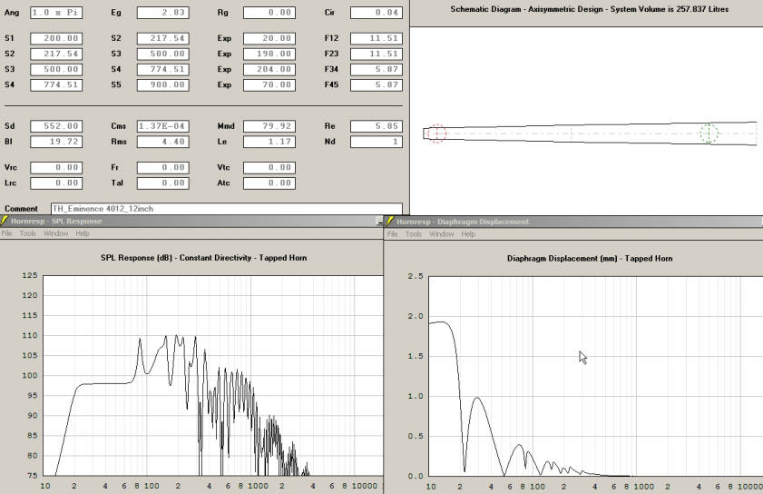

thanks tb46
i can now see how the different parts relate to the atual horn, i find if i change s4 from 1050 to 500, this gives me a desired response
this was from modifying the input perimeters you used, i am guessing from the huge difference it makes that the inductance is under the LE tab, what value of inductor do i need,
im guessing that if the driver le is 1.48 and the imput in horn resp is 7.40, that i need a inductor with a value of 5.92, if thats how there measured, seems simple, do these act as low pass filters as well? i heard that somewhere.
so im thinking if i basically make the mouth half the size i will get this response with your diagram, which is a tiny bit different, but pretty much the same as mine. am i correct?
Hi Naudio:
When you use a series inductor you should add the inductors ohmic resistance under Rg (e.g.: 0.25 Ohm). The exact value of the inductance does not seem to be too critical, give or take a half a mH. Yes, they do have their normal first order filter action.
I do not know if the reverse taper that you are applying between S3 and S4 is correctly modeled in Hornresp, generally I would advice against choking the horn that much, often you get a better response by increasing the flare from S3 to S4 over the average horn flare. Try entering it into the newest Hornresp V18.30, it has four active horn sections and the new Tapped Horn Wizard (just be aware that V18.30 does not do tapped horns with only three sections.)

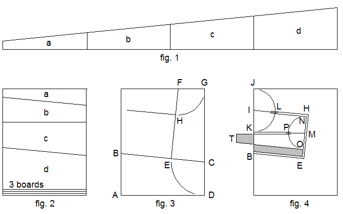

How to fold-up a Tapped Horn
Figure 1: The horn is cut into four equal length sections.
Figure 2: The sections are stacked, and some boards are added to represent the additional area of the edges of the flare panels. For our first attempt, consider the edges of fig. 2 as the inside outline of our horn.
Figure 3, 90 degree turns: Let AB be the desired mouth dimension, and set the slope of BC to match the slope of fig. 1. Next, arc DE is drawn using C as the pivot point and EF is constructed perpendicular to BC. Similarly, arc GH is drawn using F as the pivot point and a line is constructed from H perpendicular to EF.
Figure 4, 180 degree turns: To continue, we must consider the thickness of the flare panels. Add lines one material thickness above BE, to the left of EH, and below HL to show the other edge of those flare panels. To find point I, Construct the centerline of panel HL. Next, the arc JK is drawn using I as the pivot point, which establishes the length of panel HL and the point K.
Next, we construct panel KP. Draw a horizontal line from K to P and a parallel line a material thickness below it. To find point M, construct the centerline of panel KP. Next, arc NO is drawn using M as the pivot point, which establishes the length of panel KP and the point O. Complete the horn by extending the lower line of flare KP and a line from point O until they are separated by the throat height, T.
There are two corrections that we will need to make, one to the area of our box, and the second to the width. There are two gray areas, the right one is the area of the box that didn’t get used. The left one is the part of the horn that didn’t make it into the box. If the left one is larger than the right, increase the box area by the difference, else decrease the box area.
Last, measure the length of the horn that didn’t make it into the box, and divide by 3. That is the needed increase in width. From the new area and the new width, calculate the new height. Now, try again!
