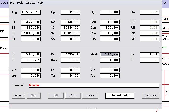

thanks for all the help so far
due to size restrictions (hight of my room) i have decided i will have to go back to the lab12 horn i was looking at in the first place
here is my technical (slightly crude) diagram, as i only have paint
the horn uses the eminence lab12 driver
http://www.eminence.com/proaudio_sp...etail_link=LAB12&speaker_size=12&SUB_CAT_ID=1
i have one final and big favor to ask, as i don't seem to be able to convert the technical s1 s2 or whatever i see in horn response to a atual design on paper/paint.......
could someone please run a quick simulation for this exact horn, and post me the graphs, im kinda stuck on this otherwise
in fact even the input perimeters would be great! that way i could run a simulation for different drivers (and i wouldn't feel so lazy)
thanks 🙄

would make sense, but how do u convert whats entered in horn resp to an atual design?
and what do i need to change on the design to get it flatter to 20hz
the length is 2204 internal dunno about that middle section
if i could be pointed to a part of this forum where someone explains what s1 s2 etc etc is and how to convert that from a plan to a simulation, and visa versa, then that would be great, because i kinda since im just being irritating now, im sure its simple enough when u know how

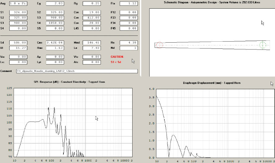

Hi Naudio,
I agree with MaVo (Post #1473) that you may want to start with a hornresp model, and there is just a world of help in this thread as to that subject. David McBean has done a great job with his program and especially the newest version of the Tapped Horn Wizard.
Also, the driver parameters are key to the enclosure simulations, so make certain that you get the correct data.
I'll try to attach a drawing of your proposed enclosure with the areas and length indicated, maybe that will help you to convert from a hornresp model to an enclosure drawing (as you said: "its simple enough when u know how").
As to the two main peaks just above the lower passband: the concensus seems to be that they can be tamed with 1/4 wave resonators. The method, simulations and pictures are earlier in the thread (don't remember when, you may just have to go through it unless somebody took notes).
I'll also enclose another (similar to MaVo's) hornresp simulation derived from your drawing with the addition of a series inductor (the inductor's resistive component is added to Rg and the inductance to Le), again this has been explained in some detail previously.

Request for more info about your measurement
It would be great if you could tell us at which frequencies (or over which frequency range) you did this test.
I think that must give a big clue to understanding the hypothesis that hornresp (etc.) gives the wrong answer.
The TH output contains various mixtures of rear and front radiation at different frequencies, and the driver sees a load that varies a lot with frequency too. At some frequency the situation must be very close to one which is already known to be correctly modelled (e.g. a bass reflex, or even a sealed box).
So I'd say that, if there are differences in the modelled and measured excursion, there should also be differences between the equivalent frequency responses.

Re: Request for more info about your measurement
You're right about the varying load and mix of front/rear radiation with increasing frequency -- this is how the tapped horn works, and is precisely what is modelled with Hornresp and Akabak.
There's no inherent reason why the simulations should be wrong because of this, the analysis methods used (which just solve well-known electroacoustic equations) should be perfectly capable of analysing much more complex systems than a tapped horn.
From what's been reported (by Tom, William and others) there doesn't seem to be a significant discrepancy in simulated vs. measured frequency response (flatness/rolloff), the discrepancy (if there is one) is in excursion (lower) and efficiency (higher).
The hypothesis is that this is because in real life the loading on the cone is somehow better than in simulation, which would both reduce excursion and increase efficiency as reported.
What is missing right now is any explanation as to why this could be the case, and where the simulations are in error -- if they are...
The reason that this matters is that maximum SPL is *very* strongly affected by such an error; for example, if Tom's figures for the TH-115 are correct the excursion-limited power handling is about 2.5x that predicted by Hornresp/Akabak (4dB SPL increase) and the efficiency is 2-6dB higher (depending on frequency).
This means the actual maximum SPL is 6-10dB higher than simulated, which is an *enormous* difference when it comes to deciding whether a tapped horn is up to a particular job or not...
