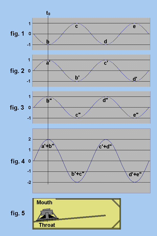

The following article is my effort to understand Tapped Horns. This is only a partial explanation, and ignores reflections, resonances, and elements of horn theory. Any corrections or suggestions will be appreciated
Feeling pressured?
We’re at the bottom of an ocean of air. The pressure is 14.7 pounds per square inch … or over A TON per square foot. Sounds are waves in the air, small variations above and below that incredible pressure. Let’s assume the sound we’re currently listening to is a variation of plus or minus one ounce per square foot. That may not sound like much, but it would be incredibly loud.
Let’s look at tapped horn (fig. 5). There is a box with a mouth and a throat. There is a speaker with it’s front side firing into the box’s throat, and it’s back side firing into the box’s mouth. We’ll need to take some measurements, so we need a gage, a device that can measure the tiny deviations in pressure that the speaker will create.
First, let’s measure only the sound coming from the front of the speaker into the throat (fig. 1). At the line labeled (to), we’re currently in the area marked (b). The pressure is -1, or one ounce per square foot less than the one ton the atmosphere is providing. As time proceeds (time line moves to the right), we move to the area marked (c). The pressure is +1, or one ounce per square foot more than the atmosphere.
As we move the gage to the mouth (fig. 2), we discover that the curve has reversed … or has it? No, it is just shifted to the right by the time that the wave takes to travel thru the box. Figure 1, area (b) is equivalent to figure 2, area (b’), only time-shifted.
Until now, we have only considered the sound coming from the front of the speaker. Not ones to play favorites; we’ll measure only the sound coming from the back (fig. 3). Since it is the other side of the same speaker cone, it is not surprising that it is an exact mirror image of (fig. 1).
Now, the grand finale! We let both sides of the speaker sound, and (fig. 2) and (fig. 3) sum to give us (fig. 4). This only works when the two waves are somewhat in phase. With careful design, this can fill in the dip between the ¼ wave peak and the ½ wave peak, and give our horn a reasonably flat response over two octaves.

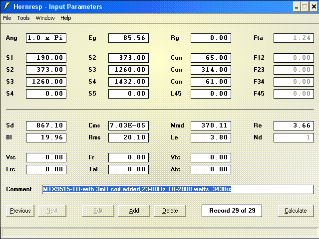

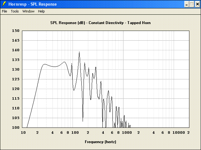

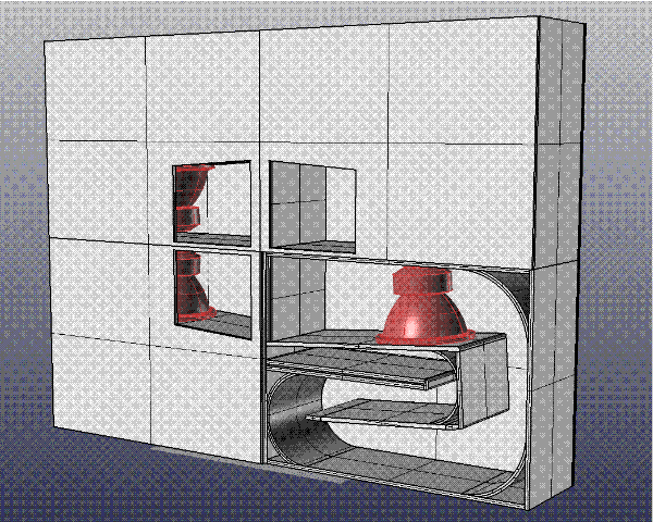

a couple days ago I posted and asked for some feedback on using a MTX-9515-04 because I have one actually two. I appreciate the responses and due to work have not had the ability to work on it until today and this is my new simul. Please take a look and give some pointers because if all looks good going to have to take the next step. SAWDUST. well need to get the folding right Any help in that area would be great too. Thanks
dee
G'day Dee
Four of those MTX drivers fed enough power should almost be enough in the home :xeye:
Seriously, this is the sort of project legends are made of!
A bit more massaging in horn response (Make the horn longer) and you should be able to get a very flat response. You are using excellent drivers for a 20Hz tapped horn.
