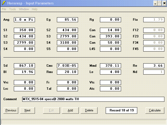

I am new to this and have found myself bitten by the TH bug. I have two MTX 9515 woofers one being the SVC and the other being a DVC .
I was wondering if anyone has simulated this driver in hornresponse in a TH and if they would post the input parameters. I am attaching my input parameters so I may get some feed back from you guys on what I can do to make this better. Measure twice cut once. I intend on building with the SVC version woofer as it has not been used the other driver has been in another box before. Thanks for the previous post I am learning alot.
dee
dee

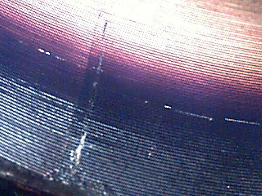

djk said:"Many pro drivers from respected manufacturers with 4" coils are now rated at 1200W AES (continuous 2hrs pink noise rating). 2000W for a 5" coil is pretty ambitious but not impossible, depending on how effective the voice coil cooling is."
The Xbl^2 is an underhung technology too. Conventional overhung designs have problems with the ends of the coil hanging out of the gap overheating and burning. Take apart a failed one and you will see the center of the coil (in the gap) is copper colored, and the coil ends are burnt black.
Don't I know it -- this is what happens to a (very expensive!) McCauley 6174 subwoofer (Hvc=40mm, Hg=10mm) when driven with repeated bass notes at the 25Hz reflex tuning frequency where cone excursion is reduced...
The Seismic 8196 which replaced it (Hvc=25mm, Hg=50mm) has suffered no such problem in over 5 years of use -- but it did cost me nearly $600 :-(
Ian
