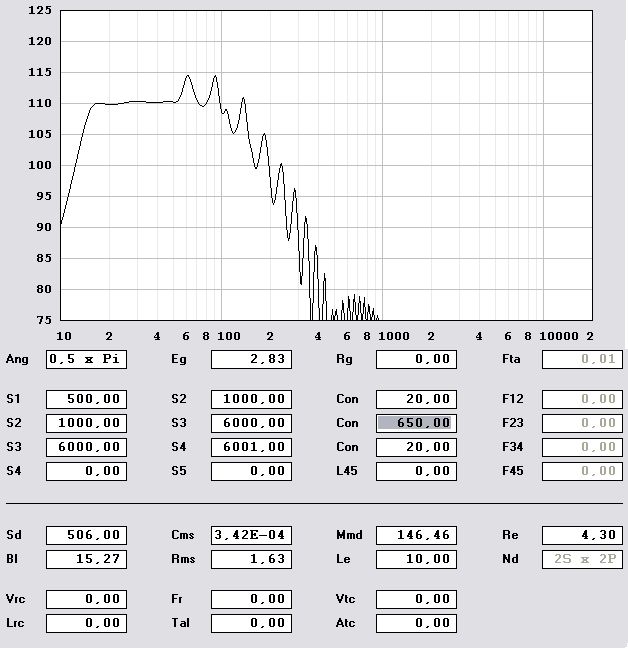

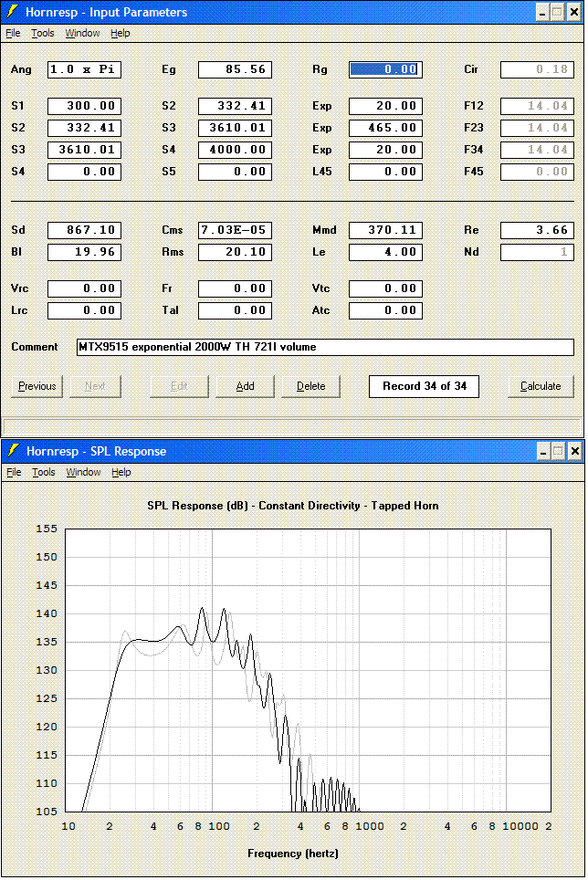

deerndlph said:Hey,
I am new to this and have found myself bitten by the TH bug. I have two MTX 9515 woofers one being the SVC and the other being a DVC .
I was wondering if anyone has simulated this driver in hornresponse in a TH and if they would post the input parameters. I am attaching my input parameters so I may get some feed back from you guys on what I can do to make this better. Measure twice cut once. I intend on building with the SVC version woofer as it has not been used the other driver has been in another box before. Thanks for the previous post I am learning alot.
dee

Here's an exponential version with the same total volume but much flatter response and slightly lower excursion -- compression ratio is higher, horn is longer, mouth area is larger.
Cheers
Ian

Thanks for the reply I didn't realize that I had put that version up there I was looking at what the differences would be by experimenting with the addition of coils The actual Le according to MTX is .8mH. It did smooth it out but not drastically. Thanks for the info about the other post. I am looking through them now.
I know this is a monster of a box that is why I was looking for some pointers.

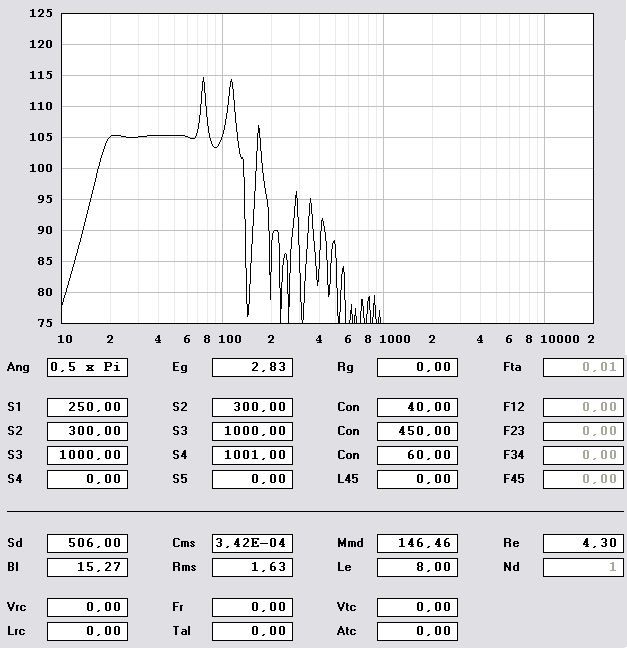

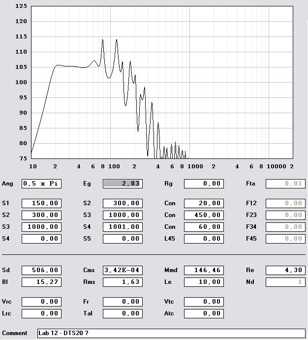

Post #1404
what are the dimensions for this horn, thanks
the simulation for the lab 12 above in Post #1404 looks good, what is the horn size?, i tried to model in horn resp, but it wont let me get the tapped horn option clickable, and it has different parameters options than your design above
and looking at whats in your plot i have no clue how to place that into atual dimensions![xeye :xeye: :xeye:](https://files.diyaudio.com/forums/images/smilies/xeye.gif)
dosent matter i made it so i can model a tapped horn, just dont know how to get this into a atual real life design
The volume is 350 Liters. I have not designed an enclosure, this has to be done by the one who builds them. If you know www.danleysoundlabs.com then look at the dts20, it is about the same size and performance.

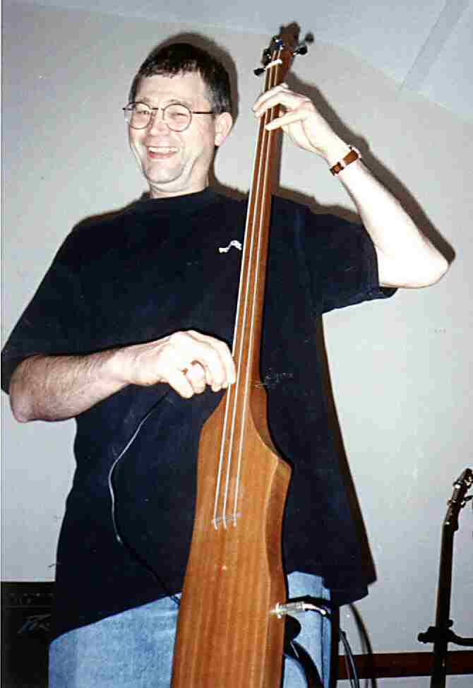

Don Snyder said:Hi Ian : I'd like to know more about the 3 stringed bass. Is it yours? I thought the low stuff we heard on the records was doctored. I don't have any instrumentation, but when I played around with GoldWave, it sounded like the Fundamental in the songs I examined was weak, and the overtones were providing most of the energy (the old "missing fundamental" trick).
Hi Don
It (see photo) belongs to our bass player Tony Penneck -- he often uses a 5-string bass where the bottom string is normally low B, and used to tune it down to low G just for that tune but it always sounded a bit feeble -- so he built "the stick" using a piezo pickup under the bridge, these often have more fundamental than an electric pickup. Being fretless it could also do things like an octave slide down (G50 to G25) which you would normally only think a synth can do.
With some added boost at 25-30Hz using parametric EQ it used to make the hall shake quite nicely -- not loud as such, just a feeling that the room was wobbling.
It did often have problems with picking up buzzes on stage and we don't do that tune any more so it's been retired -- the lowest note we use nowadays is low C (32Hz) which is why I'm targeting this not 25Hz for my next bass bin build.
