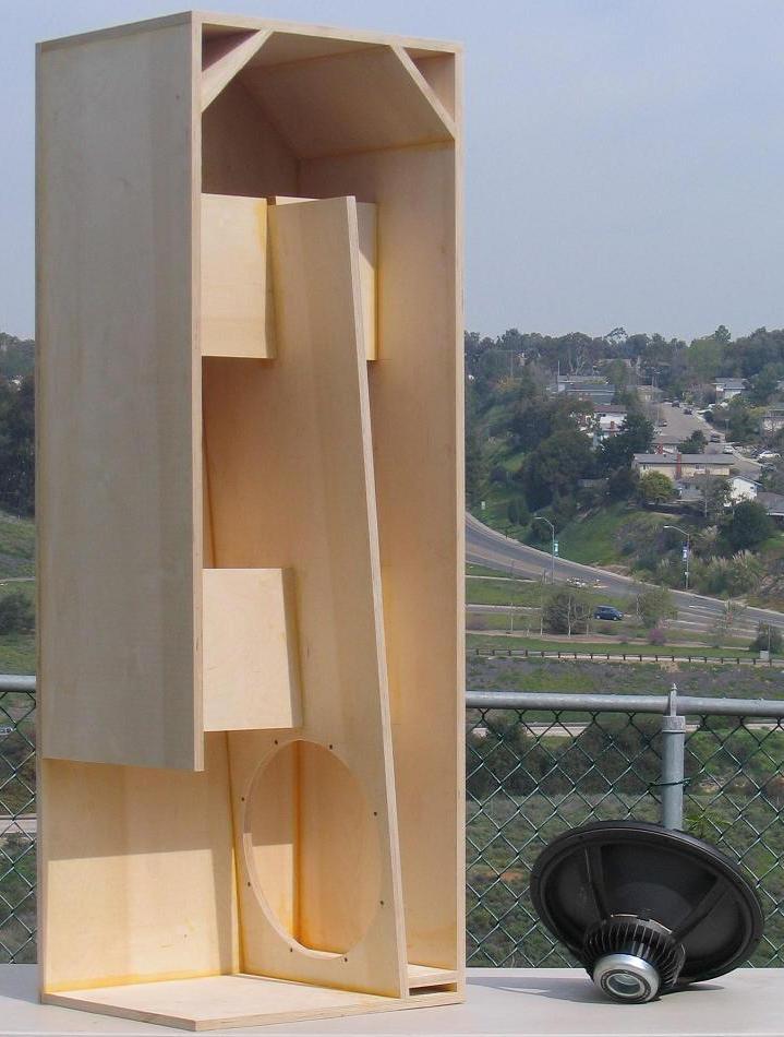

Sawdust, at last!
Thanks to William Cowan's encouragement and David McBean's Hornresp, and Tom Danley's all-too-rare hints (c'mon Tom, just one more hint).
Don
P.S. Check out the view, ain't San Diego great!

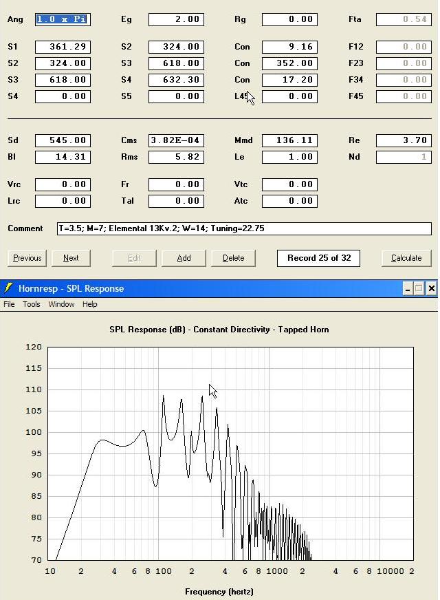

Hi guys, quite a newbie here. Im trying to design a tapped horn based on Elemental Designs' 13Kv.2 driver. Have tried many combination of throat and mouth length and the most optimum I have arrived to so far is this:
3.5" throat; 7" mouth
Quite a peak on 73Hz@100.52dB and a dip on 47Hz@96.76dB. Difference between the peak and the dip is about 3.76dB.
What is the effect of this peak on the perceived bass? Will this be felt as thump on the chest?
Driver specs (Elemental Designs 13Kv.2):
Qts: .31
Qes: .35
Qms: 3.33
Fs: 21.5 Hz
Re: 3.7
Vas: 162 L
Mms: 142 g
Bl: 15 T*m
SPL: 88.47 dB
Sd: 545 cm^2
Xmax: 15.1 mm
Voice Coil: 50 mm

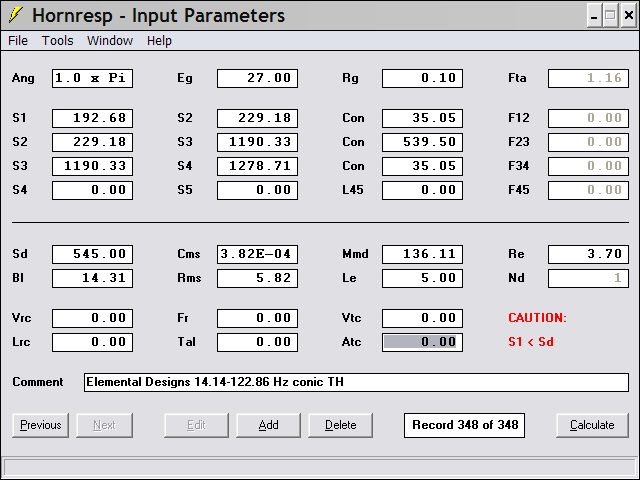

Hmm, I'm a bit confused, how did you manage to make S1 > S2?
Anyway, you can add inductance (Le) to smooth the plot a bit and between our hearing acuity down low being what it is and the room's effect on the response you'll probably be hard pressed to even notice < +/- 3 dB in-room, so < +/- 2 dB is pretty good.
FWIW, here's my 'take' on this driver with 27 V to reach Xmax in 1/4 space and 5 mH total to smooth it:
GM

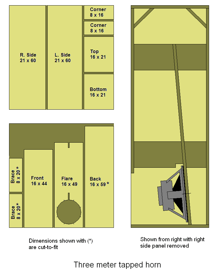

How does this design posted by djk compare with what Don is building (layout attached)?
