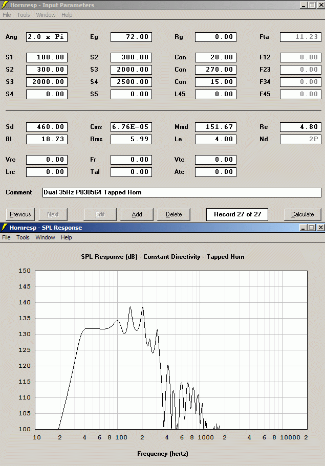

G'day again Ian
I'm not about to do an exhaustive search for drivers, but it strikes me the little Peerless 830564 will pretty much match, driver for driver, the beastly 18" BMS you used in your model, assuming the 12" is in a Tapped horn. Now I know both of us have not included thermal compression issues and you have not included your port losses. The Peerless driver is worth 1/2 what the BMS is worth.
Have a look at the following model. If you have a wall, or better, a corner you can use to load the sub into, you will find that the little tapped horn will actually beat the big dual 18" sub, with 1/2 the applied power. No, I know the Peerless 830564 is not going to survive a pro sound environment for long (It's a HiFi Driver) but a driver along the lines of the LAB12 with the same specs as the peerless driver would not be too hard to build. It would give more output too, because of a slightly higher x-max.
I'm using the 830564 tapped horn at home at the moment, and it is very strong, even compared to the two big 18LW1400 based Vented boxes, with a total external volume of 880L (shown above).
Fun little exercise, it'll be interesting to see what the others come up with.
Cheers
William Cowan
Cheers
William Cowan

cowanaudio said:G'day again Ian
Cheers
William Cowan
Hi William
Thanks for the figures -- I assume you're still just inside Xmax at 72V?
It looks like your efficiency is about the same as the reflex, maximum output is a couple of dB lower, cutoff frequency is about 10% higher.
Which is *exactly* the kind of annoying thing I kept finding... 🙂

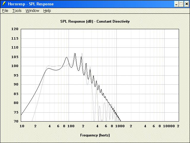

Iand, here is an image of your TH design from post #1219 and #1220, captured (in grey) with the same non tapped horn in the foreground. This was done by saying 'no' to 'do you want to do a tapped horn'.
I noticed this similarity when using Leach's formulas to design a front horn of 1000L (35' ^3). I converted it simply to a TH, and found the bass had comparable extension and level, the displacement and max SPL was similar etc.
If I changed the length of the TH and the front horn, the response/extension was compromised equivalently in both cases. I could not reduce the CSA of the TH without compromising the quality of the passband response, and reducing the front horn similarly produced a comparable increase in passband ripple.

Your results show exactly what Tom has always said (and nobody is arguing with) -- that a tapped horn can have a much flatter response than a non-tapped one with a similarly undersized mouth.
My original post did show that the tapped horn is sensitive to lots of design parameters -- especially BL -- but that the correct choices can give a flat response, which was the design I posted (and you have been tweaking). In this sense there is almost certainly a "best set" or parameters for a tapped horn with a given specification -- I haven't managed to find a better set so far than the one I posted, which is why I asked if anybody else could.
So there are 2 questions here:
1. The easy one -- for this set of design constraints ("the challenge") can a tapped horn beat the reflex, and if so what driver parameters are needed?
2. The difficult one -- under what circumstances can an optimised tapped horn beat an optimised direct radiator (and presumably vice versa)?
(in a corner, big arrays, low cutoff, high efficiency, tiny box...?)
We know that a direct radiator has a fixed relationship between size, efficiency and -3dB point (and maximum output depending on driver construction) -- so we know that you need double the box size (or two boxes) to gain 3dB efficiency (6dB output), that an extra octave extension needs 8x the box size (I think?) and 4x the displacement, placing against a wall gains 6dB output and so on.
If the rules are the same for both then if the tapped horn can win at one point against the reflex it can win at all points when optimised (hence question 1).
If the rules are different for a tapped horn then there will be cases where the tapped horn wins, and presumably ones where it loses (hence question 2).

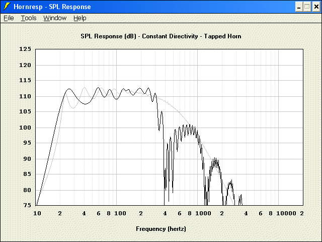

G'day again Ian, all
Perhaps another way we could attack this problem is start with a real, state of the art Tapped Horn, like the TH Mini on Tom's website and try to match those specs with a BR box. Same size, same efficiency, output and cutoff. It has 99dB efficiency at 40Hz, increasing to 101dB at 50Hz and up. All this in 133L. These figures are measured at 100W, so are pretty close to real. Speaking of which I really commend BMS for doing a high power plot on their spec sheet. I might be wrong but that plot only seems to show the port compression and not thermal compression. If the sweep were taken quickly from a cold driver, thermal compression would not show up. Also that plot shows there is a short fall from the target values at the lowest frequencies. Have a good look at the output at 40Hz. This is in a bigger box than the challenge called for, although slightly less power.
Check out the TH model of mine in the corner of a room, not 1/2 space as shown. The gain from the corner of the room is more than you will get out of a reflex, response is very flat like this too.
I think we might be having a fight with Hoffman.
Cheers
William Cowan

Hi William
There are several difficulties with doing comparisons with a real tapped horn like the TH Mini (or the TH-115):
1. Not knowing what drivers are used (maybe), or the exact design of the horn (Tom's secret sauce?)
2. Not knowing if Xmax is exceeded within the passband at rated power
For example, I think the TH-115 uses the B&C 15TBX100 which has Xmax=9mm, rated power is 1000W continuous (133dB) which it might just handle, 2000W program (136dB) which I'm almost certain it won't, at least not everywhere in the passband.
(incidentally, if you look at the TH Mini curves it's under 92dB at 40Hz, 99dB at 50, 101dB from 60-100Hz)
I'll see if I can come up with a reflex box to equal this (not with a single 12" driver, obviously 🙂, but without knowing what the Xmax limits are (maximum SPL vs. frequency) for the TH Mini it's difficult to do a fair comparison, which is why I'm suggesting using simulation with known driver parameters as a basis for comparison.
So we either need to start with a reflex design that we know is optimum and come up with a tapped horn to match it, or vice versa. I suggested the first option, we could also do the second one but only if we knew exactly what the optimum tapped horn starting point was -- so if you know exactly what's inside any of Tom's tapped horns we could do also it that way 🙂
It's difficult to know the reason(s) for the LF SPL shortfall in the BMS plots (though as you say, it's pretty brave of them to show such a plot, I've never seen anyone else do it!) -- it could be port compression, it could be thermal compression (shows up most near minimum impedance), it could be a bit of both.
I know the efficiency of a tapped horn goes up more in either multiples or in a corner than a reflex, but that's kind of moving the goalposts -- all Tom's measurements are in half-space with a single box and the tapped horn is claimed to give higher SPL under that condition, so that's what I'm trying to prove (or disprove).
So far I haven't found a tapped horn that wins (for this particular set of design parameters), and neither has anyone else (yet...) with either real or imaginary drivers.
